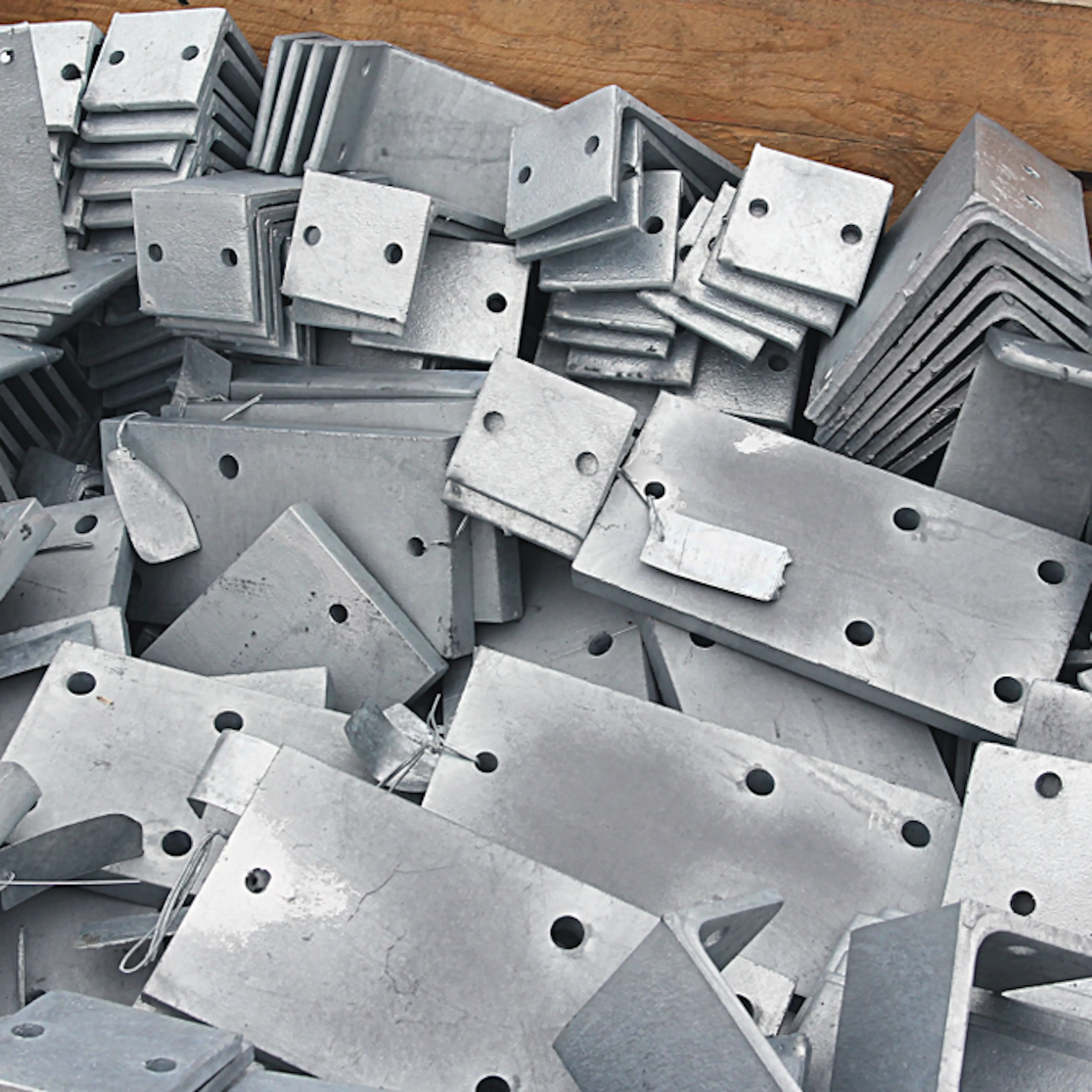

What Is Hot-Dipped Galvanized Steel?
A specialized procedure known as hot-dipped galvanizing involves immersing clean steel in molten zinc. Layers of zinc-iron alloy are produced by the metallurgical interaction of iron and zinc. Because of this reaction, a strong covering is created, which eventually becomes a part of the steel itself. The complete coating provided by the immersion in molten zinc offers improved resistance to corrosion and a shield against external influences. With this process, robust steel is produced that may be used in a variety of manufacturing and construction applications.
What Is the Purpose of Hot-Dipped Galvanized Steel?
The purpose of hot-dip galvanization is to prevent corrosion in metal. This method creates a protective coating that stops corrosion by submerging steel or another metal in molten zinc. The sacrificial nature of zinc further protects the underlying material from external factors. This process, which is well-known for its effectiveness, provides a strong and long-lasting barrier against corrosion, making it the go-to option in many sectors in which longevity in a metal is essential.
What Are the Advantages of Hot-Dipped Galvanized Steel?
Hot-dipped galvanization boasts various advantages such as:
  1. Total Coating: Uniform coating protects all surfaces, including edges and corners.
  2. Efficiency: Rapid process compared to time-consuming paint application.
  3. Economical and Eco-Friendly: Ensures steel’s longevity, reducing maintenance costs and environmental impact.
  4. Corrosion Protection: Forms a zinc layer—acting as an initial barrier and evolving into a zinc patina over time.
  5. Reusability Ease: Galvanized structures can be melted and repurposed without quality loss.
  6. Recycling: Fits into a circular economy, with zinc and steel being recycled for continuous use.
What Are the Disadvantages of Hot-Dipped Galvanized Steel?
Some disadvantages of hot-dipped galvanized steel include:
  1. Limited Application Locations: Confined to galvanizing plants; on-site application is impractical.
  2. Size Constraints: Component dimensions are restricted by zinc bath size; refer to industry guidelines.
  3. Potential for Warping: Risk of distortion in large, flat sheets or slender beams due to high molten zinc temperature.
  4. Specialized Welding Procedures: Welding galvanized steel may require different procedures, involving coating reconditioning around the weld.
  5. Color Alteration Complexity: Changing the zinc coating color requires additional painting.

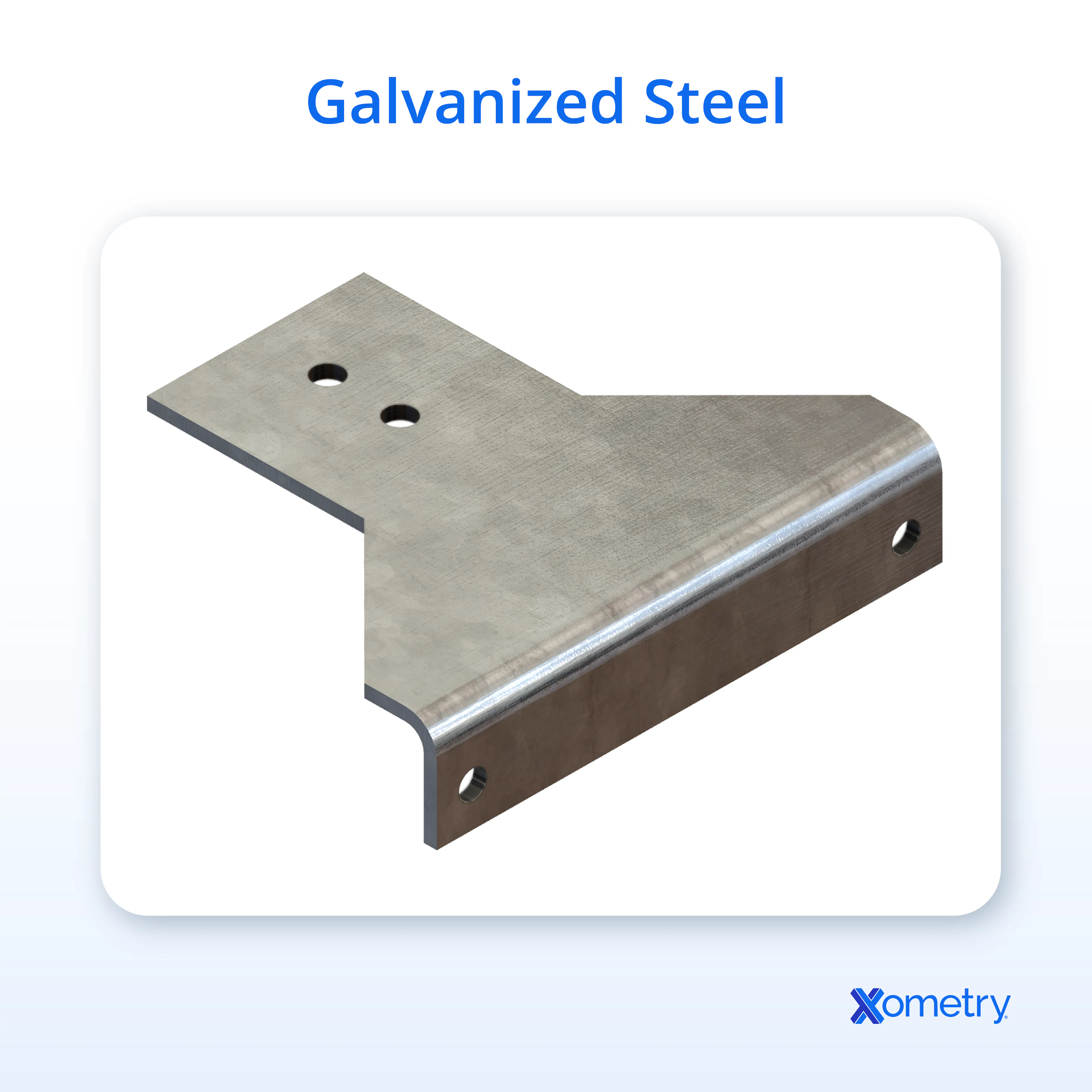

What Is Galvanized Steel?
An electrolyte solution is used in place of a zinc bath during the process of coating steel to create galvanized steel. Zinc ions are converted into a metal layer that sticks to the steel. This happens due to the electric current which is applied to the solution-immersed steel during treatment. Though the thinness of the material leaves it susceptible to corrosion over time, this scientific process yields a protective zinc covering. Steel is more resilient to environmental deterioration thanks to this novel galvanizing technique.
What Is the Purpose of Galvanizing?
The purpose of galvanizing is to provide corrosion resistance to steel. A protective barrier is formed by coating steel with a thin layer of zinc through an electrochemical process. Zinc sacrificially corrodes before steel, preventing rust and corrosion. This method significantly extends the life span of steel structures, making them more durable in various environments. Galvanized steel finds extensive use in construction, automotive, and manufacturing industries, in which resilience to the elements is crucial for longevity and performance.

What Are the Advantages of Galvanized?
Galvanizing offers some significant advantages for structural steel protection:
  1. Ease of Inspection: Visual assessment and non-destructive testing.
  2. Less Maintenance/Lowest Long-Term Cost: Minimal upkeep, cost-effective over time.
  3. Accelerated Assembly Time: Ready for immediate use upon arrival.
  4. Extended Life Span: Exceeds 50 years in rural environments, 20–25 years in urban exposure.
  5. Dependability: Conforms to Australian/New Zealand Standard 4680, with consistent coating thickness.
  6. Complete Protection: Covers all parts, including recesses and corners.
What Are the Disadvantages of Galvanized?
Some disadvantages of galvanized steel include:
  1. Higher Cost: Galvanized steel is often more expensive compared to other methods such as the use of sealant or paint due to the increased production cost associated with zinc coating.
  2. Rust Potential: Susceptibility to rust over time, particularly when exposed to certain chemicals or environments, affecting its life span.
  3. Welding Challenges: Zinc plating can complicate welding, requiring professional consultation for projects involving galvanized steel.
  4. Limited Corrosion Protection: Provides limited long-term protection against corrosion compared to alternative methods like stainless steel.
  5. Toxicity Concerns: The zinc used in galvanizing can be toxic if inhaled or ingested, releasing harmful toxins into the environment when it corrodes.
  6. Regular Maintenance: Requires periodic replacement of the zinc layer and cleaning to prevent corrosion and the accumulation of dirt and grime.
