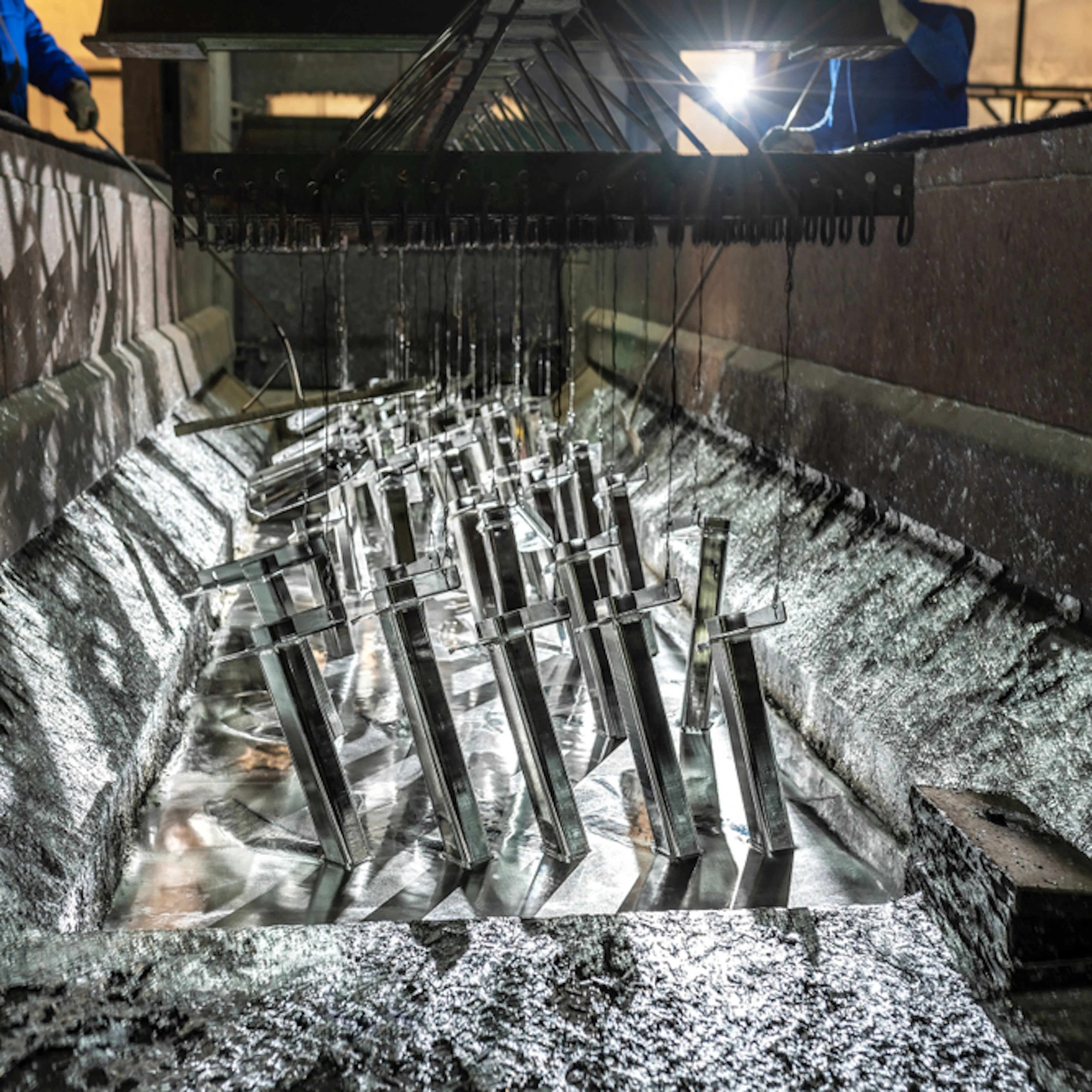

Galvanizing process. Image Credit: Shutterstock.com/Bogdan Vija

Galvanized steel refers to steel that has been hot-dip coated, electroplated, or mechanically plated—among other methods—with zinc, which protects it against corrosion. This process is called galvanization. Treating the steel in this way provides it with an ionic barrier that will sacrifice itself and prevent the steel from rusting, and that’s why galvanized steel has a long environmental lifespan.

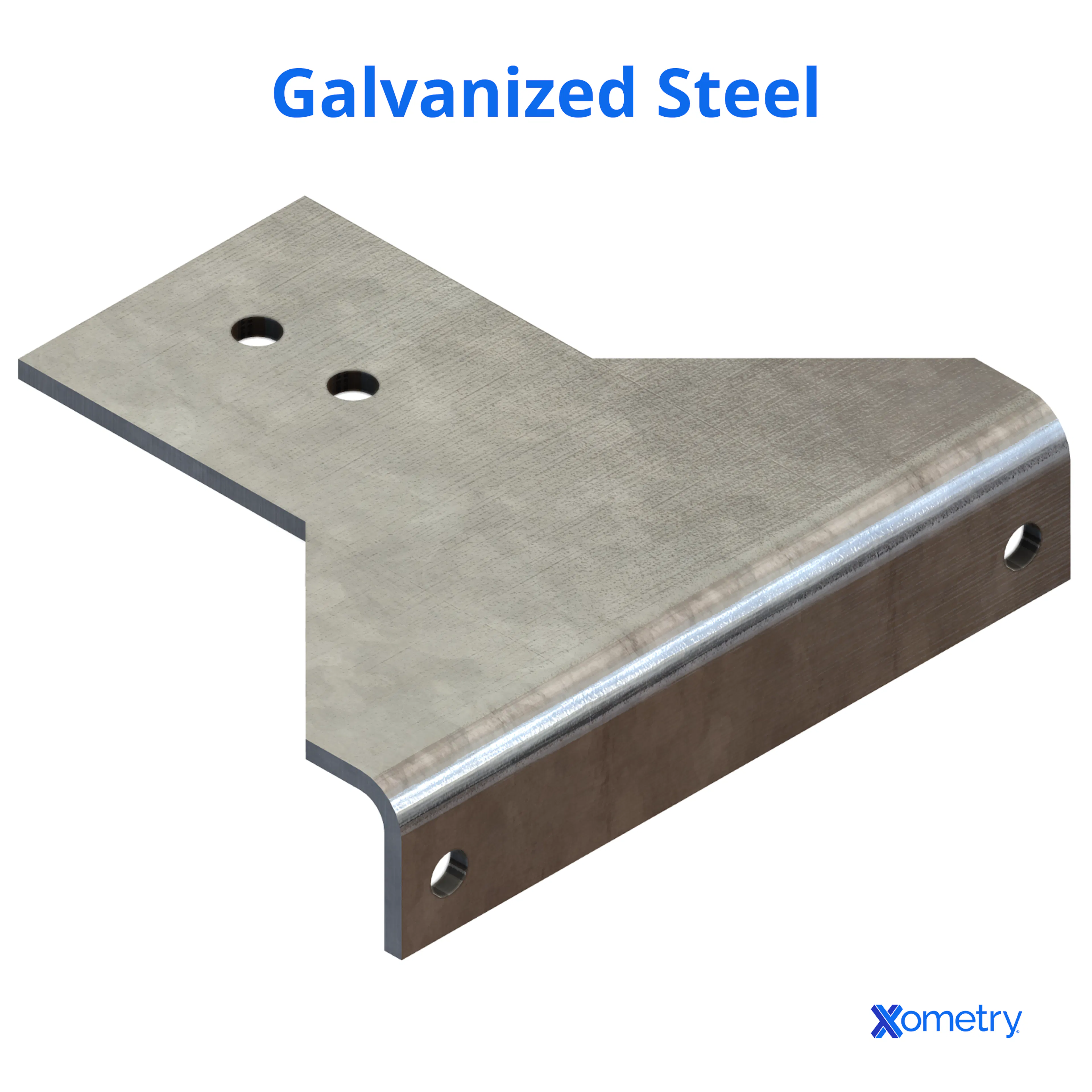

What Does Galvanized Steel Look Like?
Galvanized steel takes on distinctive appearances resulting from the application technique, in which the texture and grain formation in the zinc coating will differ markedly by the method. The surface has a gloss-metallic silver-gray color, smooth and uniform when freshly hot-dipped. Over time, the coating will develop a dull, matte finish. The surface of galvanized steel may also have a fine crystalline pattern, known as a "spangle". This spangle effect can vary in size and intensity, ranging from small and tight to large and visible.
When electroplated, the surface can show large regions of crystallization spangle which are generally more evident than in hot-dip plating. These result from the progressive crystal growth that is more orderly than the faster, hot-dip-formed surface. Figure 1 below shows what galvanized steel looks like:
Bent sheet metal part made from galvanized steel.

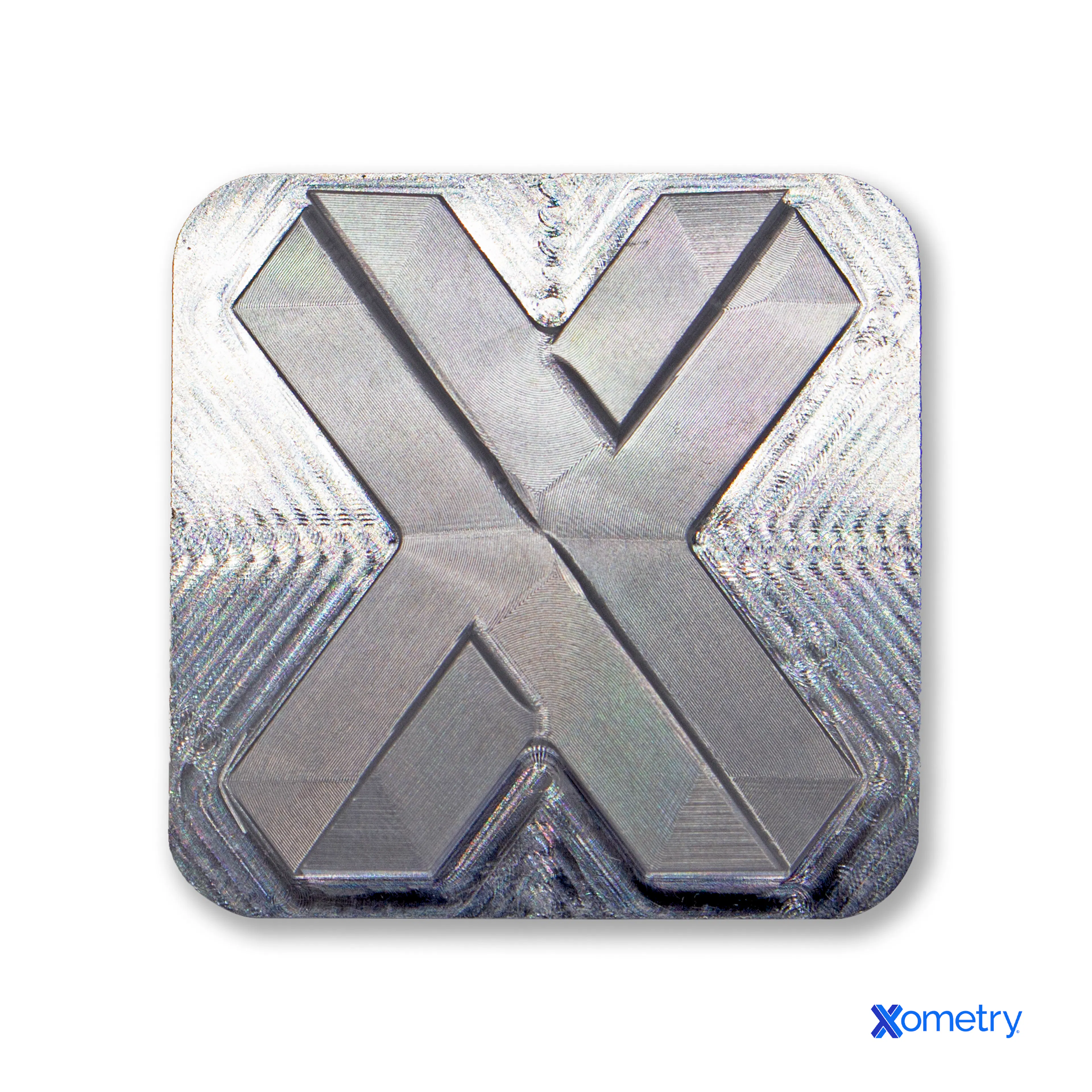

What Does Aluminum Look Like?
Aluminum is a silver-white metal that generally has a matte finish. Figure 2 shows an example of processed aluminum:
A part made from aluminum 6061
