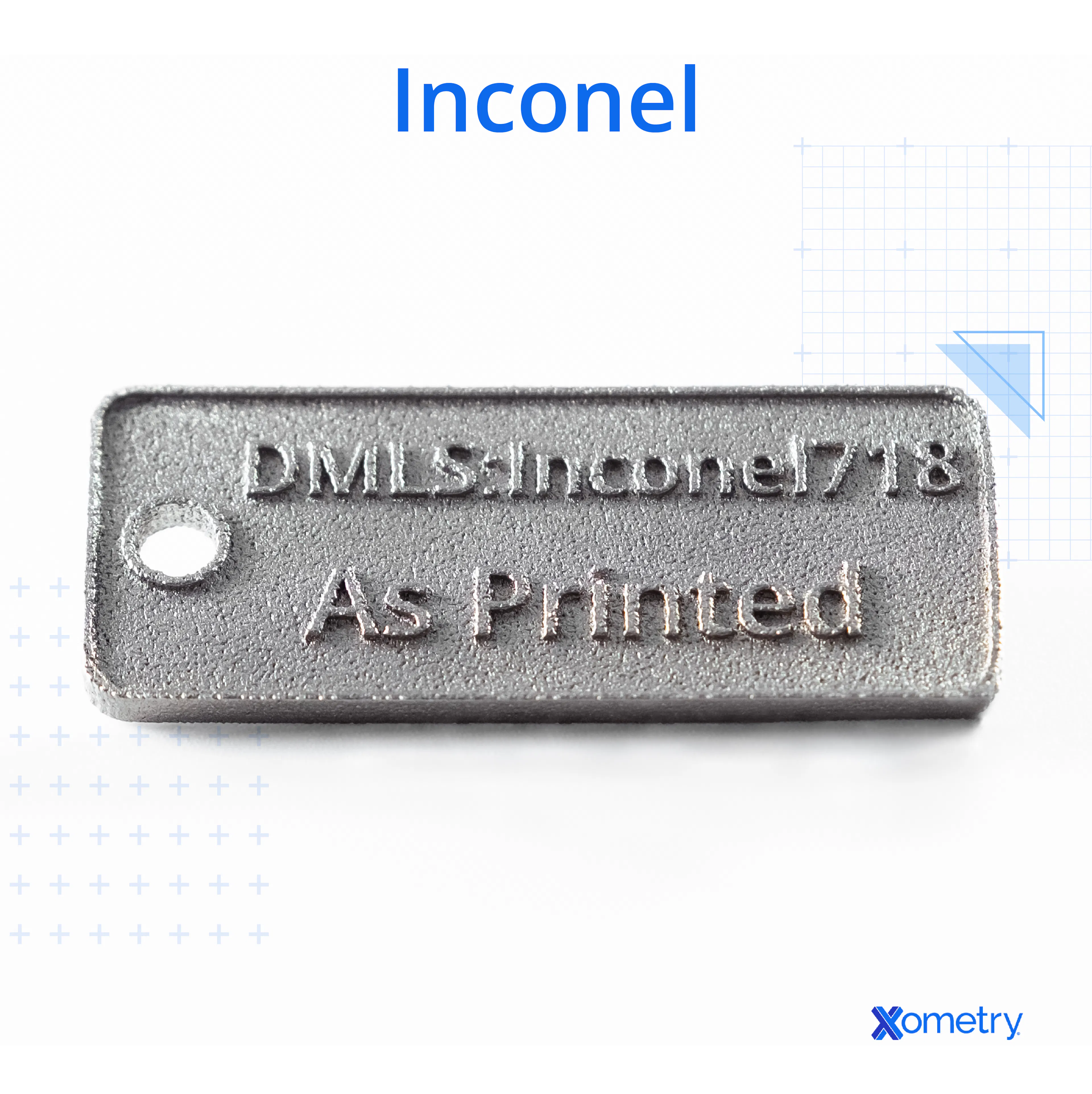

Inconel 718 is designed for precipitation hardening and provides good strength and toughness up to 650 °C, along with excellent corrosion and oxidation resistance. Inconel X-750 has even better corrosion resistance and oxidation resistance than Inconel 718, which is especially beneficial for aerospace and industrial gas turbine components. Inconel 690 offers superior resistance to chloride corrosion and is commonly used in environments such as nitric acid, steam generators, and nuclear waste treatment plants. Lastly, Inconel 702 is a casting alloy with notably high strength.
A photograph of 718 Inconel printed at Xometry
