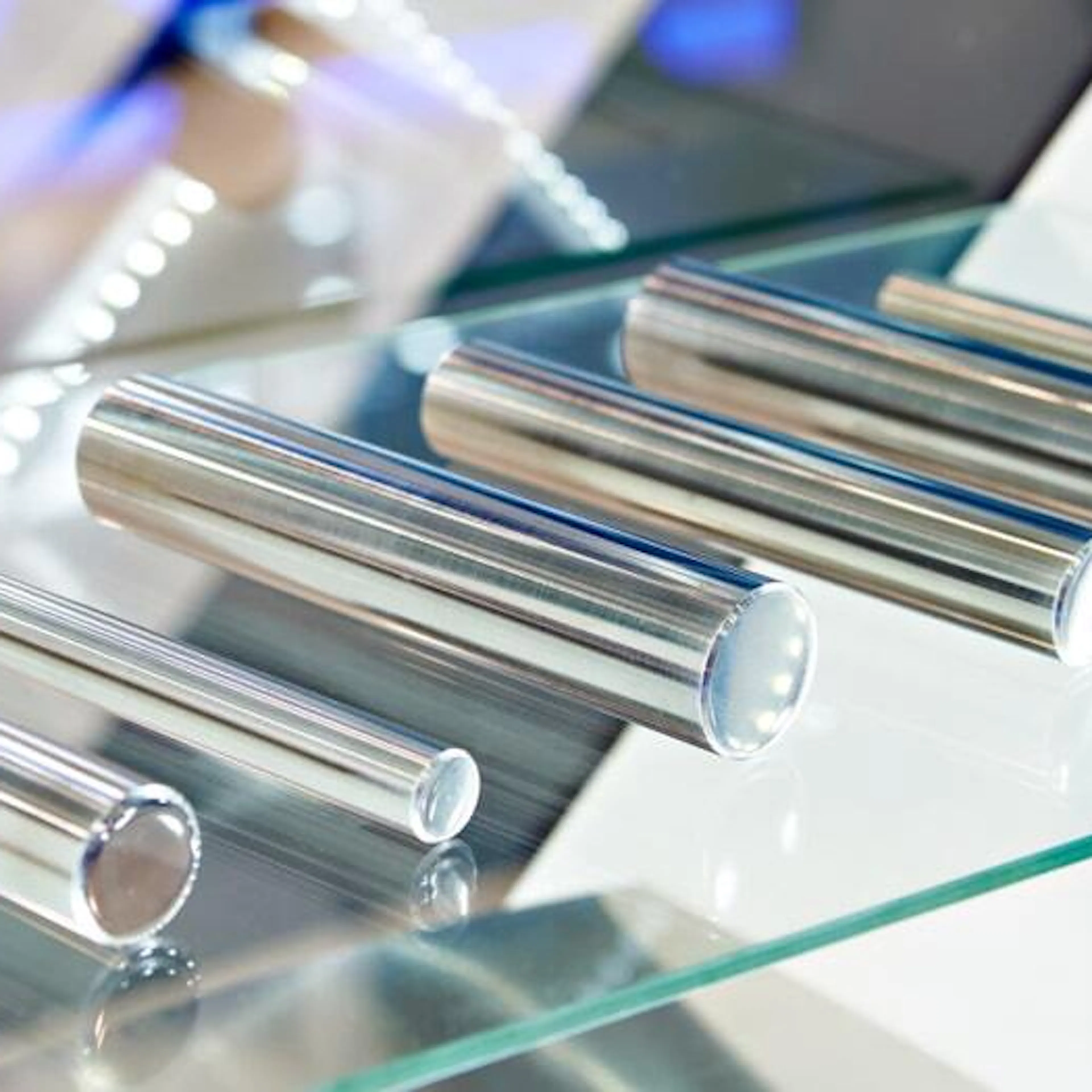

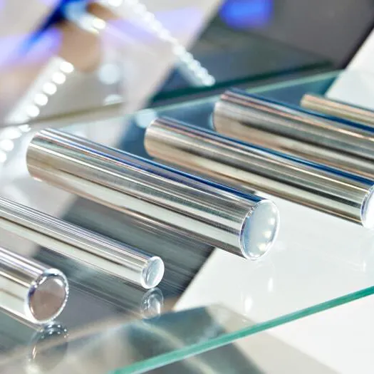

Nickel alloy based metal parts. Image Credit: Shutterstock.com/Sergey Ryzhov
