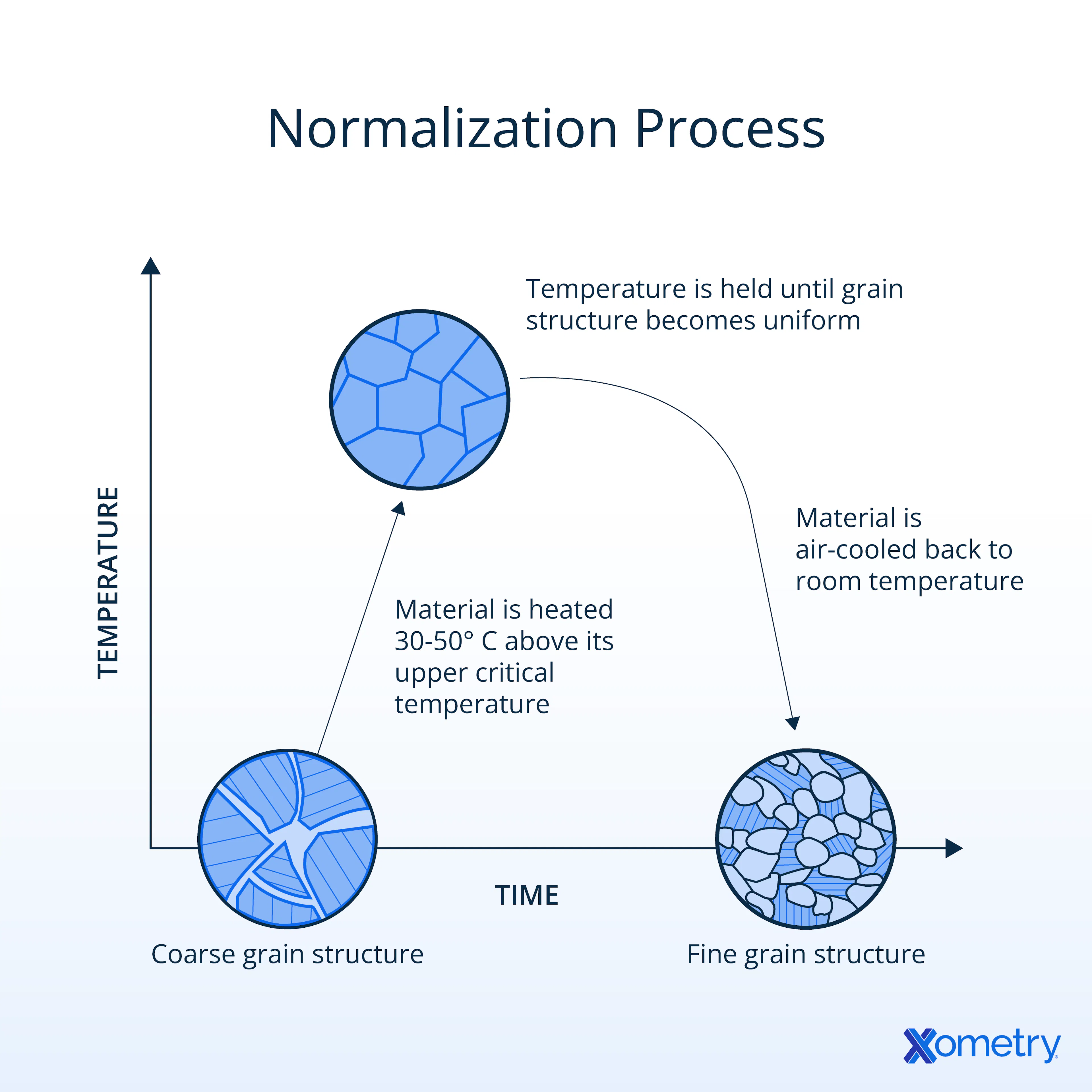

What Is Normalizing in Heat Treatment?
Normalizing is a process applied to a variety of metals. It is conducted to relieve the crystalline structural changes and internal stresses that result from malleable work (often called work hardening) or heat treatment that has resulted in hardening.
The process uses a relatively low level of control whereby the part or material is heated to just above its upper critical temperature. The material is held at that heat level for a period that varies according to material, condition, and target effect; and then allowed to cool in still, ambient air.
How Does Normalizing Work?
Normalizing works with the part or material being furnace or flame heated to a temperature slightly above the upper critical temperature point. The level is highly dependent on the metal classification and composition. An example is steel, the relevant temperature for which is in the range of 815–925 °C.
With the material at the target temperature, it is held in that condition for a duration that depends on several variables. This soaking time allows for uniform heating throughout the material and for the grain structure modifications to be completed to the required degree. After the soak period has been completed, the material is removed from the heat and cooled in still, ambient air.
normalization process
The normalization process
What Is the Purpose of Normalizing?
The main purpose of normalizing is to alter the mechanical properties of the material. When the metal is heated sufficiently, there is a strong tendency towards the dissolution of grain boundaries, allowing smooth crystalline and disjoint-free recrystallization to occur. Atomic migration also occurs, reducing anisotropy that results from interstitial condensation of alloy components into non-uniform regions.
The application of heat literally reforms the crystalline structure to a less disjointed and regionalized form. It returns the worked or previously heat-treated material to its relaxed state. The consequence of this is the recovery of ductility and toughness, as grains are more pliable (reducing in hardness) and the majority of crack initiation sites are expunged. This has various benefits in both component functions and in reducing the effort of follow-on processes.
What Are the Benefits of Normalizing?
The benefits of normalizing are:
  1. Reduced hardness improves machinability in subsequent manufacture. The hardness induced by work or heat/quenching can be reduced selectively.
  2. Increased malleability reduces the forces required in subsequent forming operations. The trade-off between malleability/ductility allows relatively fine adjustments to properties to be reliably performed by a moderate degree of control of normalization parameters.
  3. Reduction in crystal boundary dislocations is a beneficial consequence of the dissolution of grain boundaries and reformation of the matrix. This results in a lower risk of fracture in subsequent forming operations or in use.
  4. Increased ductility is intrinsic to the large, uniform crystalline structure that results from normalization. This makes materials and components tougher and more resilient in real-world uses.
  5. Thermal processes that involve uneven cooling and the potential for regional differences in alloy constituent distribution are reduced in impact, allowing greater uniformity in component distribution. The atomic redistribution that occurs during normalization increases the mutual dissolution of alloy elements into a more homogenous and isotropic structure. This reduces the risk of disjointed properties resulting in property variations in the part.

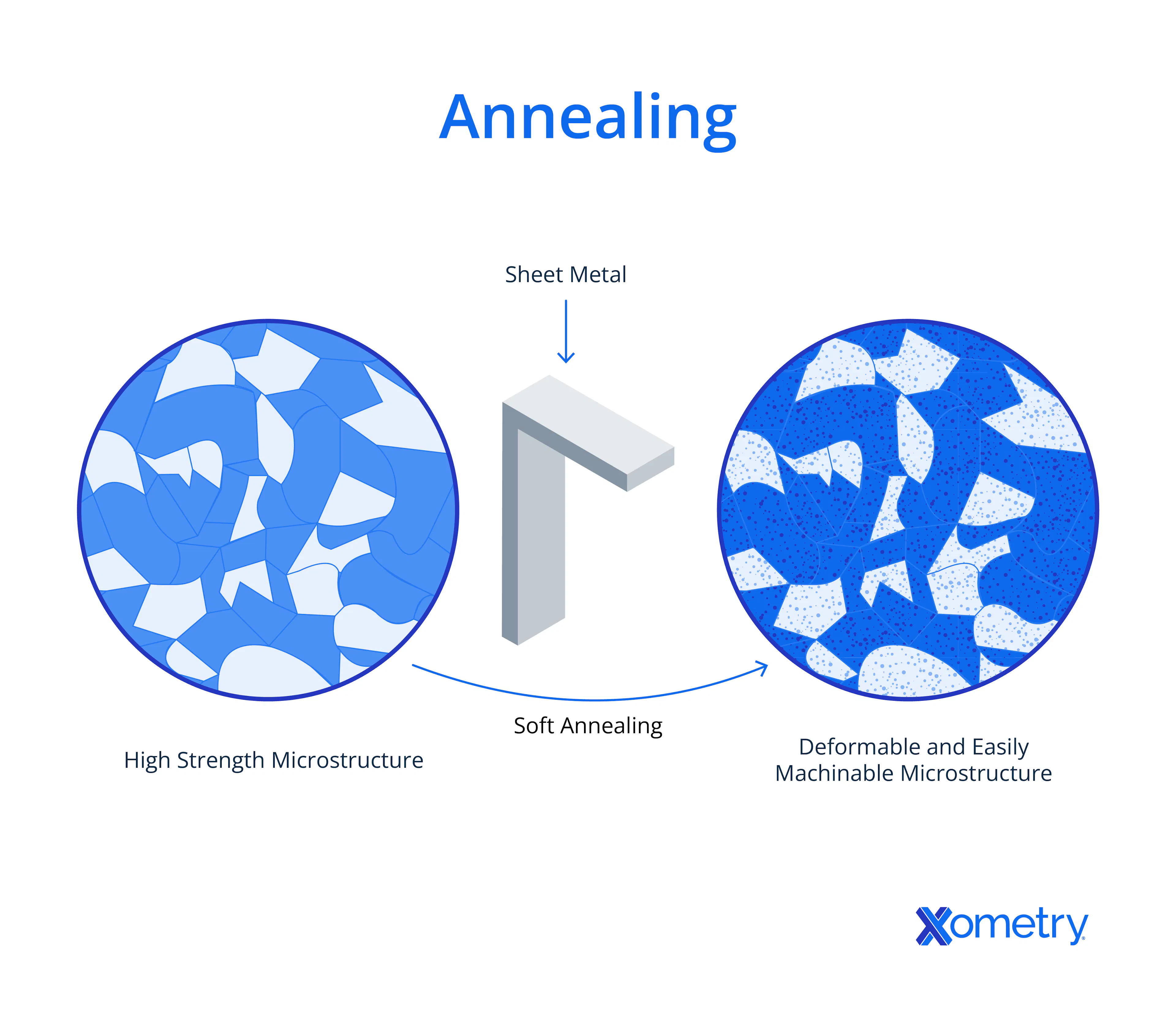

What Is Annealing in Heat Treatment?
Annealing is used to alter the properties of materials, primarily metals and alloys. It is done by heating them to a specific temperature and then cooling them slowly to achieve desired microstructural changes.
Annealing can be differentiated between distinct classes of treatment. It is selected according to the desired crystal lattice, hardness/ductility spectrum, and residual stress effects. The types of annealing are: full, partial, isothermal, and process annealing. These four types differ in the temperature applied to the part.
How Does Annealing Work?
Annealing works by heating the material to a temperature above its upper critical or recrystallization temperature. The temperature varies with the type and composition of the material and with the desired effect on the microstructure. Next, the material is held at that temperature for a specified duration that facilitates uniform heating throughout the material. It allows the transformation of the microstructure to the required degree, controlled by the duration of soaking. Lastly, the material is either cooled within the furnace or removed from the furnace and allowed to cool in an insulating medium, such as vermiculite or sand. The cooling rate is deliberately controlled to achieve specific microstructural changes that are slow to complete.
Annealing
The process of annealing
What Is the Purpose of Annealing?
The purpose of annealing is to achieve specific and repeatable microstructural changes and material property adjustments. The key mechanisms at work during annealing apply adjustments to the crystalline matrix, the isotropy of the properties, and the overall mechanical properties of the material or part. The mechanisms at play in annealing are recrystallization, stress relief, and grain refinement.
As the material is heated and soaked, new grains with a more uniform and refined microstructure form. This replaces/subsumes the previous deformed, fractured, or strained grains. Annealing also relieves internal stresses created during prior deforming or cutting processes exerted on the part. This stress relief reduces the risk of post-machining deformation or fracture in subsequent processes or use. Finally, the refined grain structure enhances the mechanical properties of the material. Its ductility, toughness, and formability are all improved to a controlled degree, at the expense of hardness.
What Are the Benefits of Annealing?
Annealing offers a variety of benefits such as:
  1. Softens the material, making it more ductile and less prone to brittleness.
  2. Relieves internal stresses within the material, reducing the risk of deformation or cracking.
  3. Annealed materials are easier to machine and fabricate, improving their manufacturability.
  4. The treatment promotes a more uniform and fine-grained microstructure, resulting in better material consistency, plus better and more uniform mechanical properties.
  5. Annealing helps homogenize the material, making it more uniform in composition and properties throughout.
  6. Eliminates or refines grains and structures that were deformed during previous processing steps, such as cold working or heat/quenching.
  7. Allows for the tailored adjustment of material properties to specific requirements, within limited ranges.
  8. The process is commonly used to relieve stresses in welded components, reducing the risk of post-weld cracking due to highly localized heating and matrix changes.
