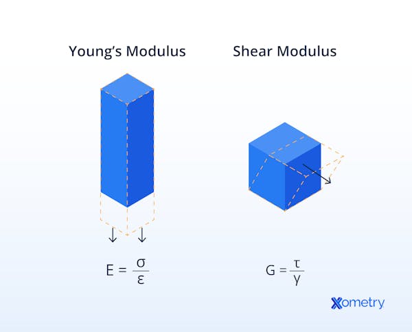

What Are the Differences Between Shear Modulus and Young's Modulus?
Young's modulus quantifies the ratio of stress (specifically tensile or compressive stress) to strain, serving as an indicator of a solid's stiffness. On the other hand, shear modulus measures the ratio of stress to strain under shear forces. While they evaluate different types of deformation, their values can differ significantly depending on the material’s structure and bonding.
Shear modulus is also referred to as the modulus of rigidity, emphasizing its role in assessing a material's resistance to shear stress. Unlike Young's modulus, which applies to compressive or tensile loading, shear modulus specifically addresses the response to shear forces. Figure 1 below illustrates the difference between Young's modulus vs. shear modulus:
Young's modulus vs. shear modulus illustration
