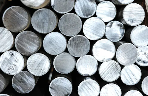

Aluminum rods. Image Credit: Shutterstock.com/Yulia Grigoryeva

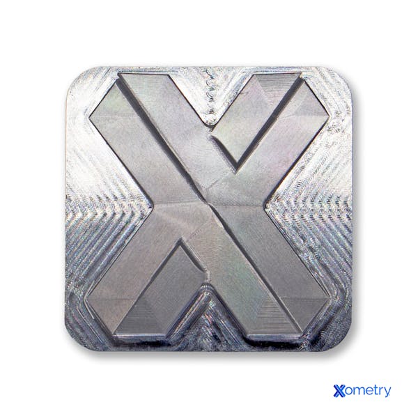

Natural aluminum alloys have a metallic silver hue but depending on the manufacturing process, the texture could change.
Xometry X-Tile CNC Machined from Aluminum 6061.
