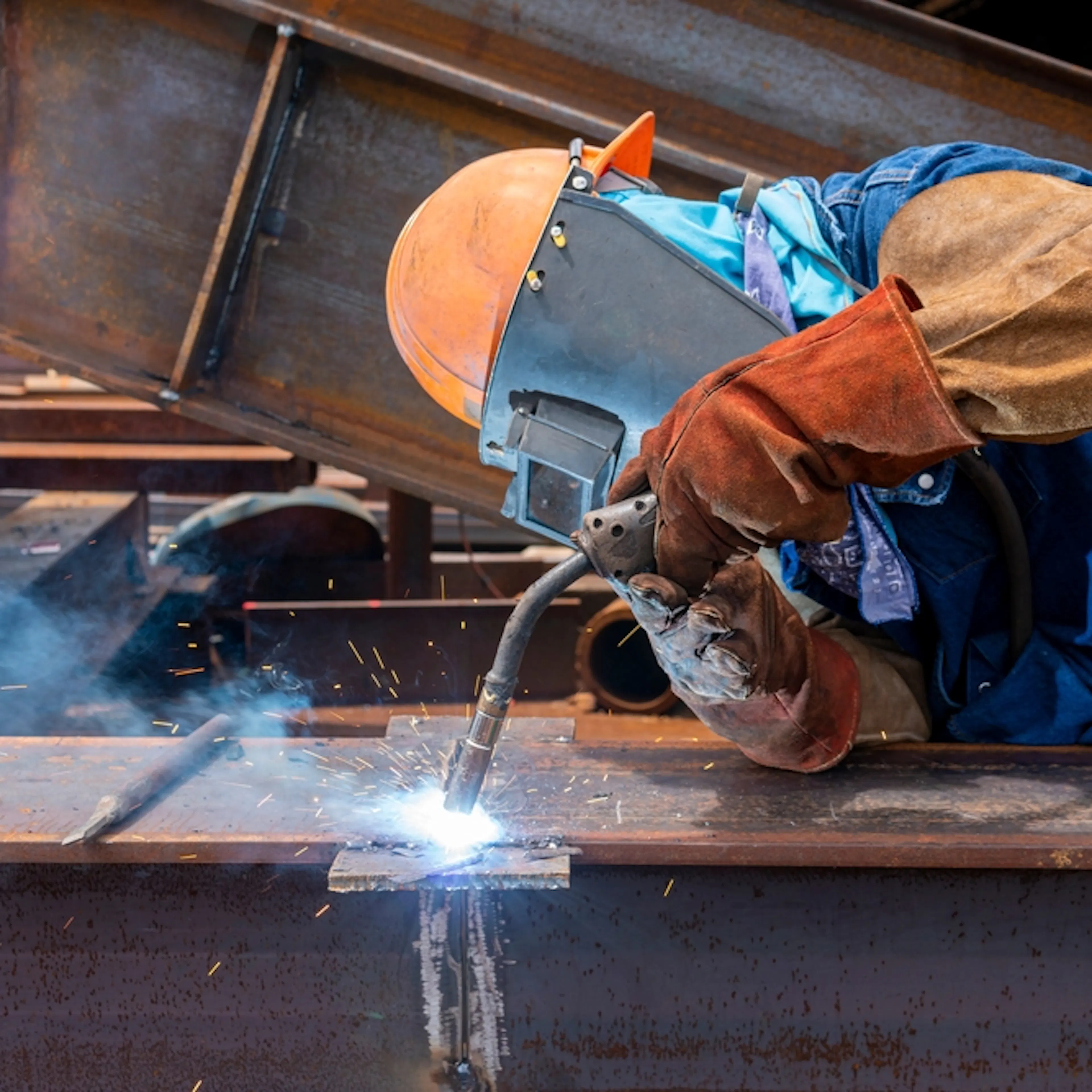

Arc welding. Image Credit: Shutterstock.com/Thaweesak Thipphamon
Arc and gas welding are both methods that use intense heat to join metal components by melting them and allowing them to fuse upon cooling. The main difference between the two is the way the heat is generated. Arc welding uses electricity to generate a much higher temperature. Gas welding creates a slightly lower temperature by burning gases (most commonly acetylene) with oxygen to generate a flame that melts the metal to be welded. This article will further compare arc welding vs. gas welding.

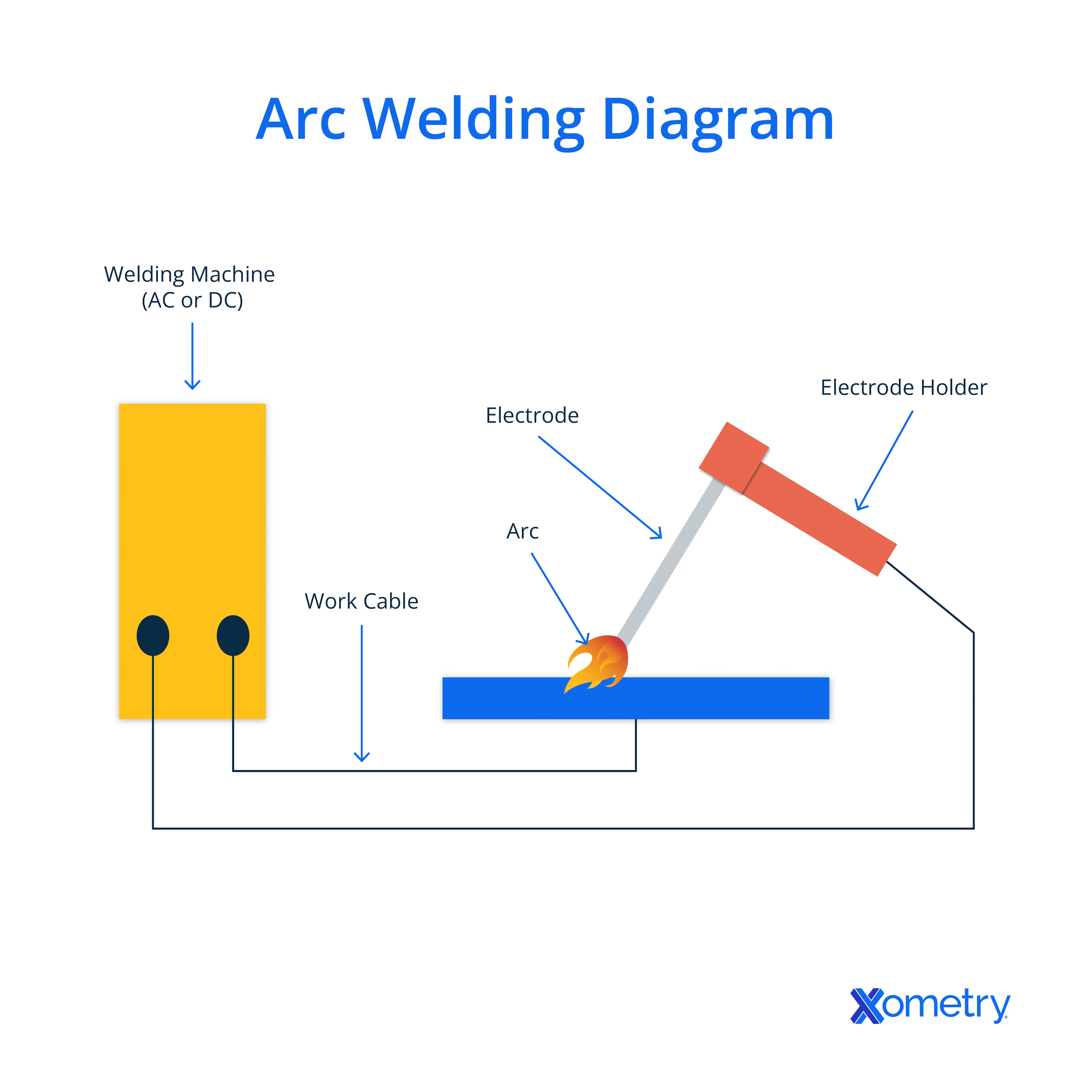

How Does Arc Welding Work?
Arc welding works by creating an electric arc to generate heat. This is achieved by attaching a grounding wire to a metal structure and a ground clamp to the workpiece and using an electrode to strike an arc at the welding joint. Once the electrode lead touches the material to be welded, an electric arc is created that produces a bright white light and sparks.
The resistance to the flow of electrons across the air gap is what produces the intense heat that melts the metal material and filler material (sometimes referred to as the welding rod). The resultant pool of metal then solidifies and fuses the edges of the original material to join the metal together. Molten metal may react with oxygen and nitrogen in the air, potentially weakening the weld. To prevent this, shielding gas or flux is used to protect the weld pool.
How arc welding works
An illustration of how arc welding works
