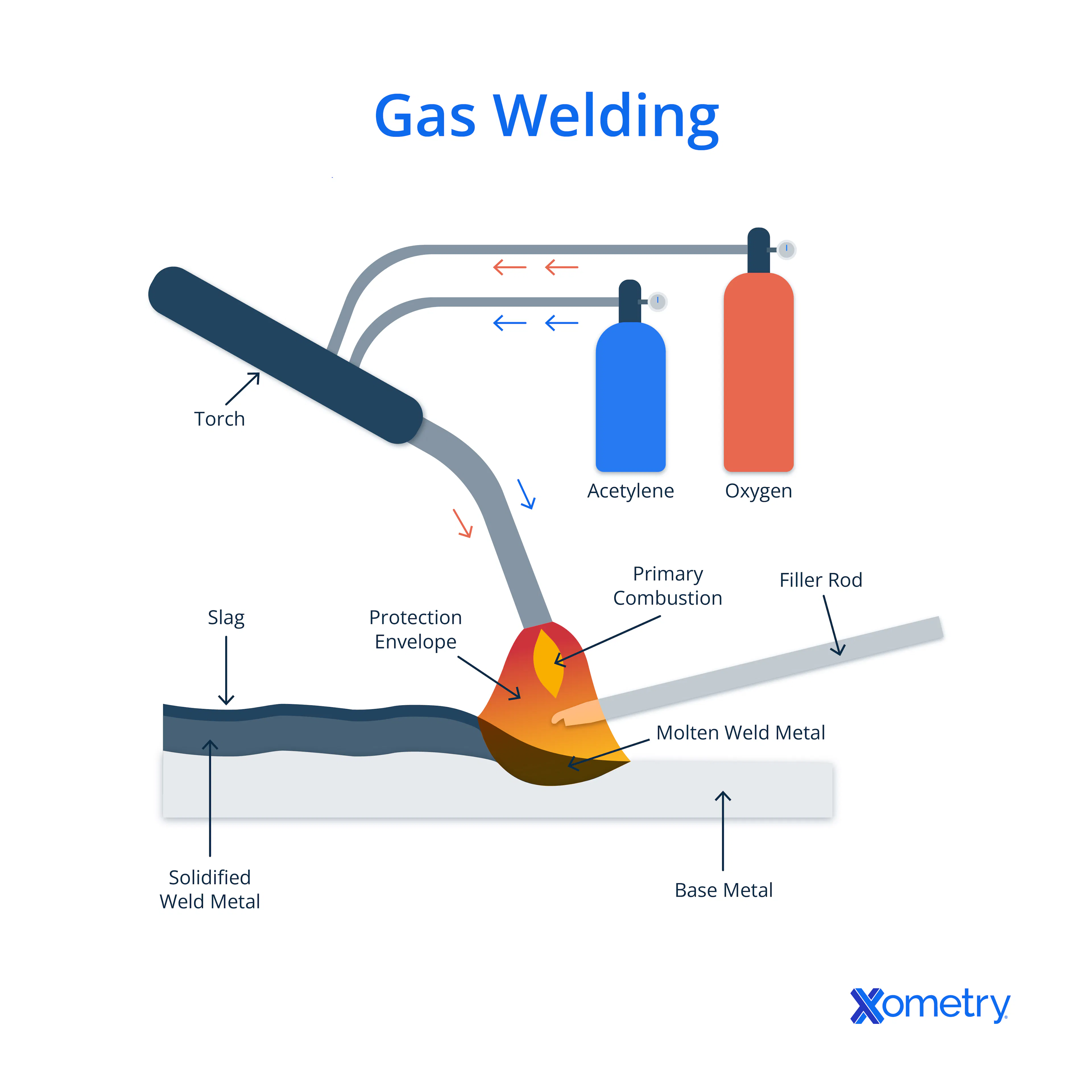

Gas welding uses oxygen and fuel gas to create a hot flame that can melt parts of metals and join them together. When cooled, this creates a very strong bond. To a certain extent, gas welding has been replaced by electrical welding forms (they’re cheaper and don’t involve gas which could be considered a safety hazard by some), but gas welders are still very much in use by hobbyists and professionals (including some Xometry customers) alike as it’s effective, simple, and portable. The below diagram explains how the process works:
The gas welding process

  1. Temperature: To control the temperature of a gas welding flame, all you have to do is adjust the ratio between oxygen and fuel. The more fuel you add, the lower the temperature will be. That way, you can adjust the temperature to match each material’s melting point. But, for high-strength steel, the heat could mess with its mechanical properties.
  2. Pressure: By adjusting the pressure ratio between the delivery of oxygen and the fuel gas, you can get three types of flames: neutral, oxidizing, and carburizing. The most common of these is the neutral flame, which is easy to spot because it has a small bright white inner flame and a larger blue flame around it. You can get it by mixing almost equal amounts of oxygen and fuel gas. For an oxidizing flame—perfect for welding cast iron and zinc alloys—mix more oxygen than fuel gas. You’ll notice that the inner flame is much shorter and more pointed and burns slightly hotter than a neutral flame. If you mix more fuel gas than oxygen, you’ll get a carburizing flame, which has a visible secondary flame between the short inner one and the larger outer one. This type of flame is popular among Xometry customers for welding aluminum and its alloys.
