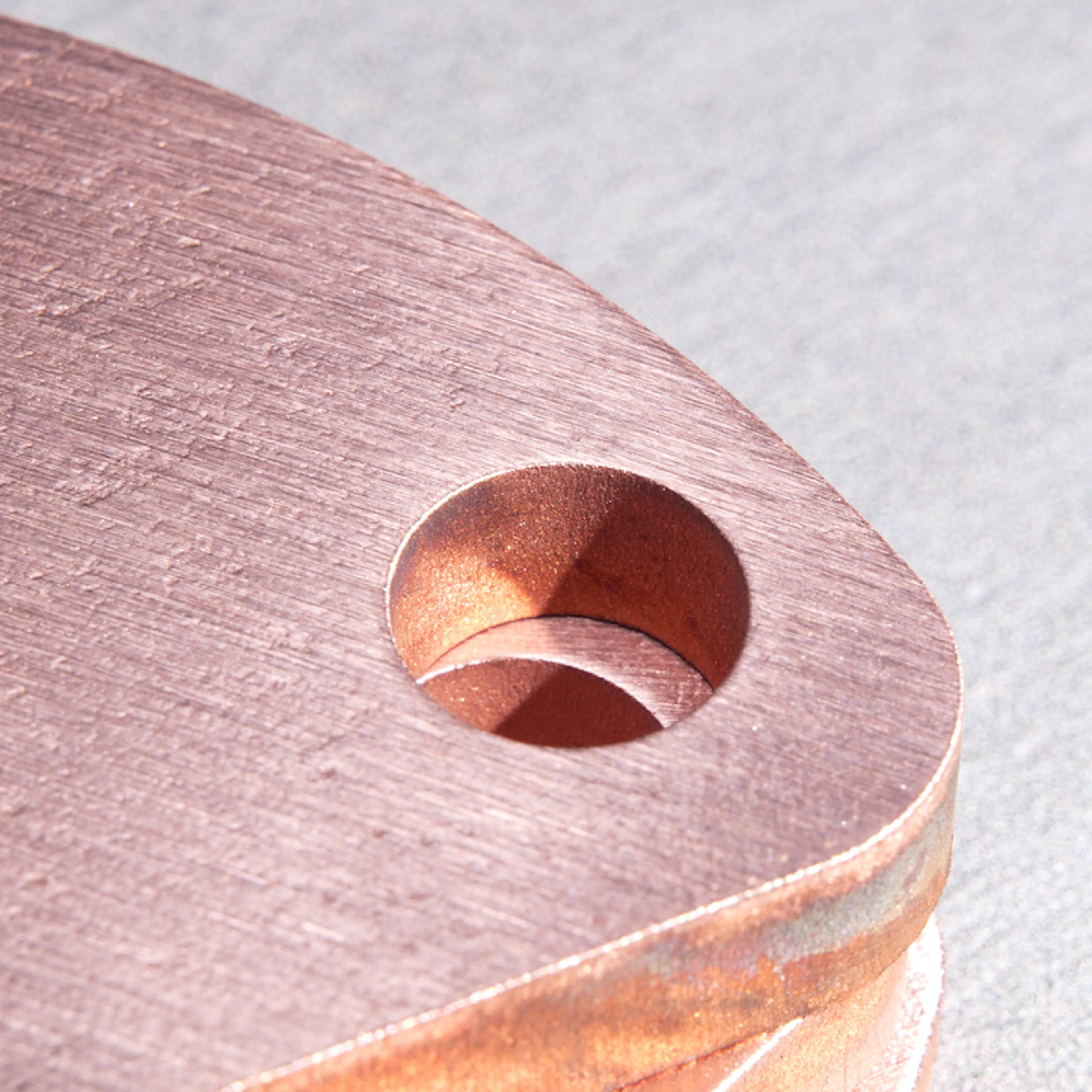

Close up of laser cut out of copper. Image Credit: Shutterstock.com/seeshooteatrepeat
With its ability to make parts with elaborate designs, laser cutting has quickly become one of the most common manufacturing methods used today by both hobbyists and industrial professionals. It’s versatile and can cut, engrave, and etch lots of different materials, including organic leather, wood, paper, non-organic metals, plastics, and… copper!

When cutting a copper sheet or workpiece using a laser cutter, you’ll ideally want to use one with a fiber laser because copper can easily absorb the blue, violet, and ultraviolet wavelengths from these. Below, you can see an example of copper that’s been laser-cut.
