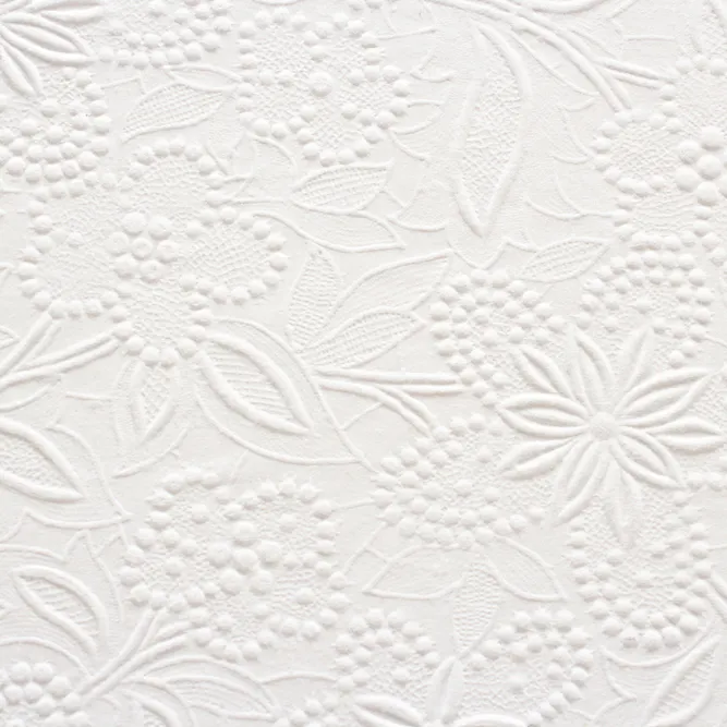

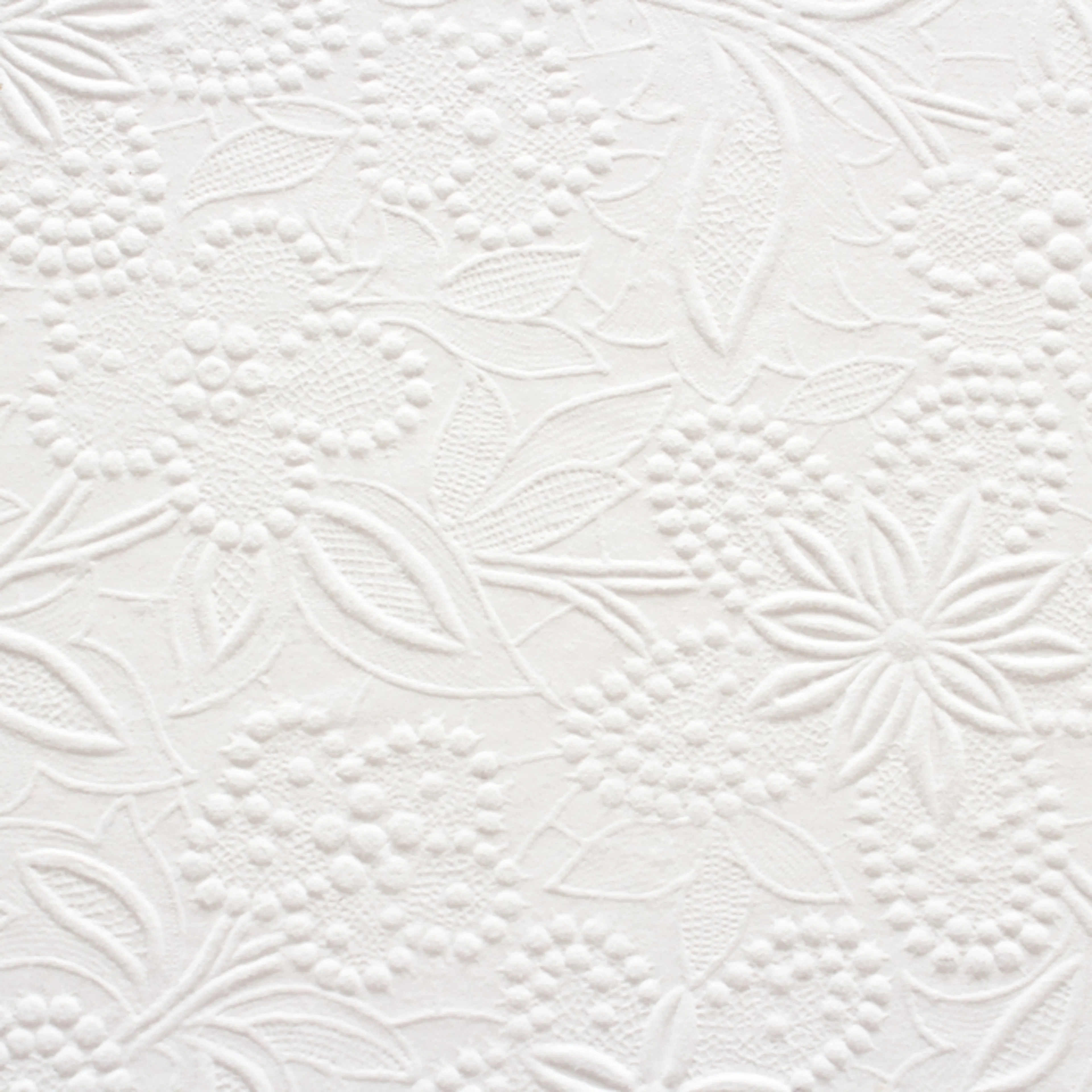

Embossing is the art of creating raised patterns on the surfaces of paper, leather, metal, or other materials. The term, “embossing,” is derived from the French word “bosse,” which means a bump, a description of the raised effect that the embossing process creates.
A typical embossing design is created using an embosser. This specialized device creates raised or recessed designs on surfaces. They come in different sizes and shapes and are used for various professional purposes. The result typically has a 3-dimensional effect, in which the raised portions stand out from their surrounding surface.
The embossed design enhances the visual appeal of a material, so the technique is widely employed in packaging, books, and stamps.
An illustration of embossing.
