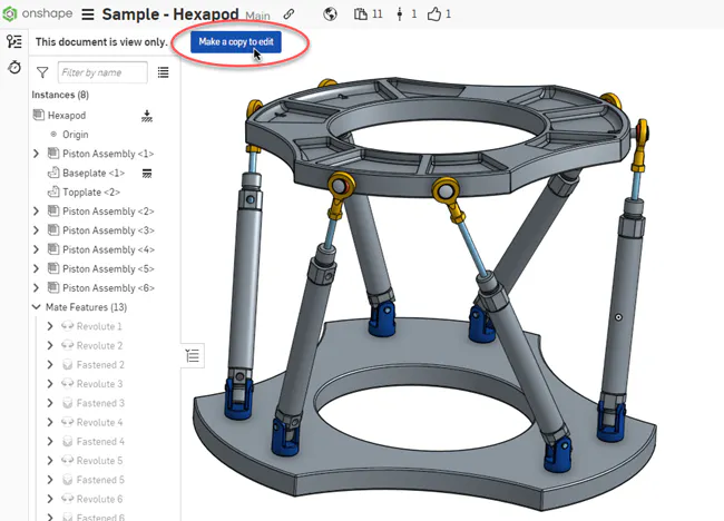

First, start with an open project. For this guide, we will be using the "Sample - Hexapod" design by Onshape. This design is found by searching for it in the public design archive within Onshape's main screen.
Screenshot of assembly within Onshape

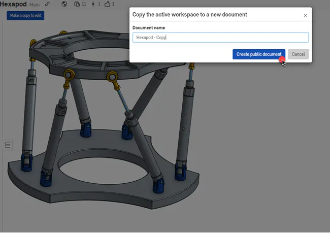

Now that the design is open, we will need to make a copy of it before we can start making edits. You won't need to do this step if you are working from your design or already have editing rights.
To make an editable copy of the document, click on the button in the upper left that says "Make a copy to edit."
Screenshot highlighting location of "Make a copy to edit" button
A dialog box will appear, which allows you to create a name for the copied document. Give the document a name, then click the "Create public document" button to create the new document. If you are subscribed to one of Onshape's paid plans, you will also have the option to set the document as private.
Screenshot of "Make a copy" dialog box

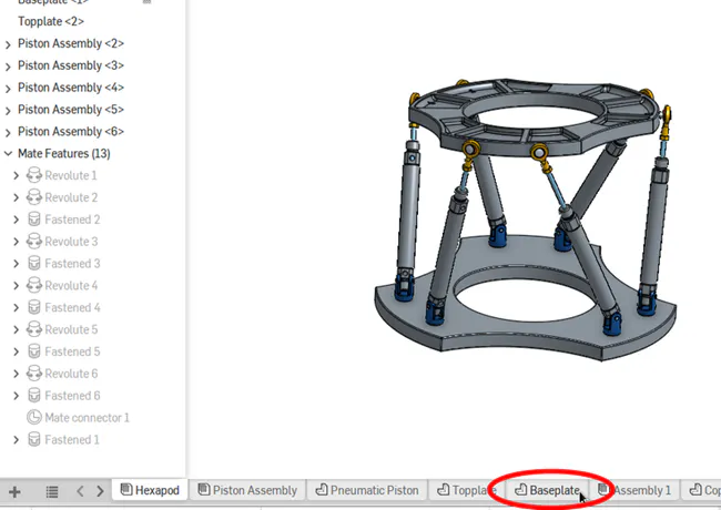

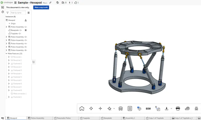

We now have a copy of the design, which we can modify. The base plate of the assembly is a great candidate for waterjet cutting, and this is the component we will focus on using to generate our DXF file.
Click the "Baseplate" tab to see an isolated view of the part.
Screenshot highlighting location of "Baseplate" tab in Onshape interface

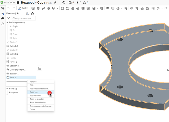

Remove the fillets by right-clicking on "Fillet 1" in the feature tree and selecting the "Suppress" option.
Screenshot demonstrating how to supress fillets

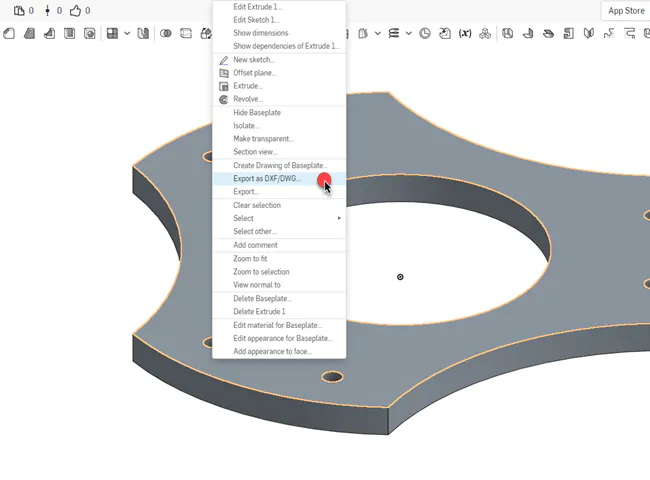

Select the top face of the part and right-click to open a menu. Select "Export as DXF/DWG..." from the options.
Screenshot showing Export as DXF option from pop-up menu

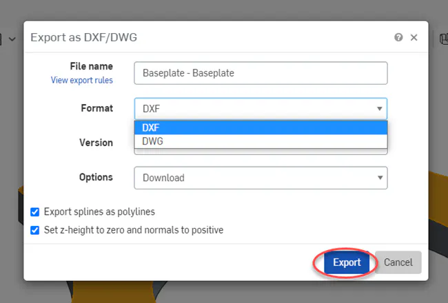

From here, a dialog box will open and present us with a few options for naming and exporting our file. We will select "DXF" for the format and "Download" as our export option in this scenario.
We recommend checking the "Export splines as polylines" and "Set z-height to zero and normals to positive" checkboxes to ensure the DXF file is correctly prepared for manufacturing.
Click "Export" to proceed and check your downloads for the newly created DXF file.

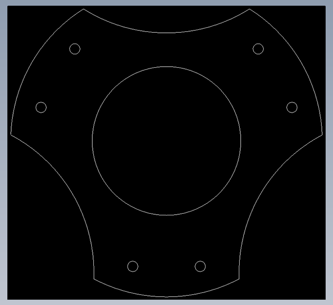

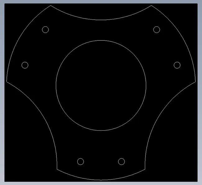

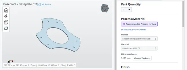

That's all there is to it. You can see how our DXF file turned out in the example below.
Image of exported DXF file from Onshape
You can try out your DXF file by uploading it to the Xometry Instant Quoting Engine and start getting instant pricing from a variety of material and thickness options.
