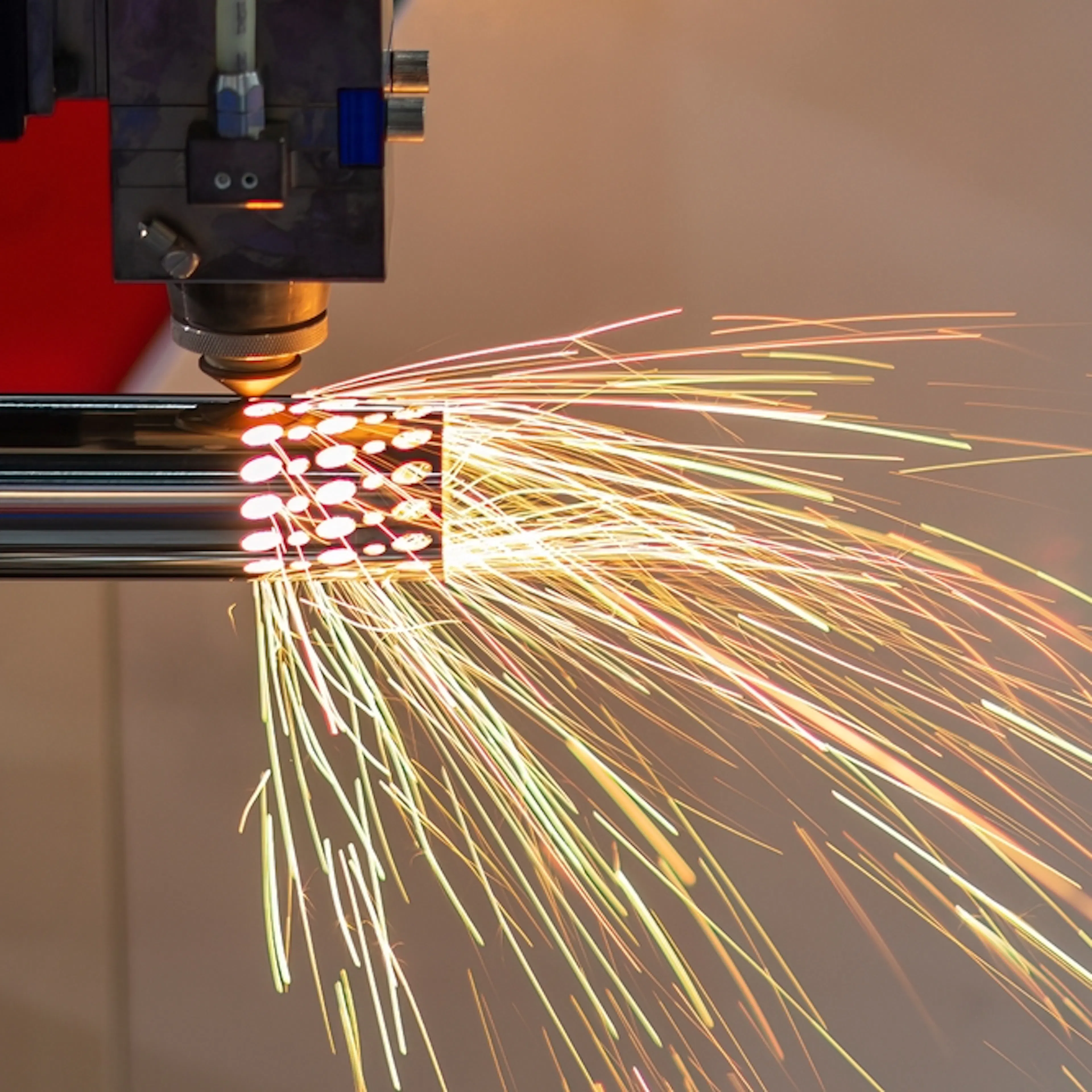

Fiber laser cutting machine cutting a stainless steel pipe. Image Credit: Shutterstock.com/Pixel B
Many stainless steel grades can be laser-cut efficiently and with high accuracy, provided the correct equipment and process parameters are used. Laser cutting offers various advantages over more traditional approaches — it reduces the risk of work hardening, introduces minimal heat-affected zones (HAZ), and often eliminates the need for post-processing. However, cutting stainless steel requires proper understanding of the material's properties, adherence to best practices, and the use of high-performance laser systems.

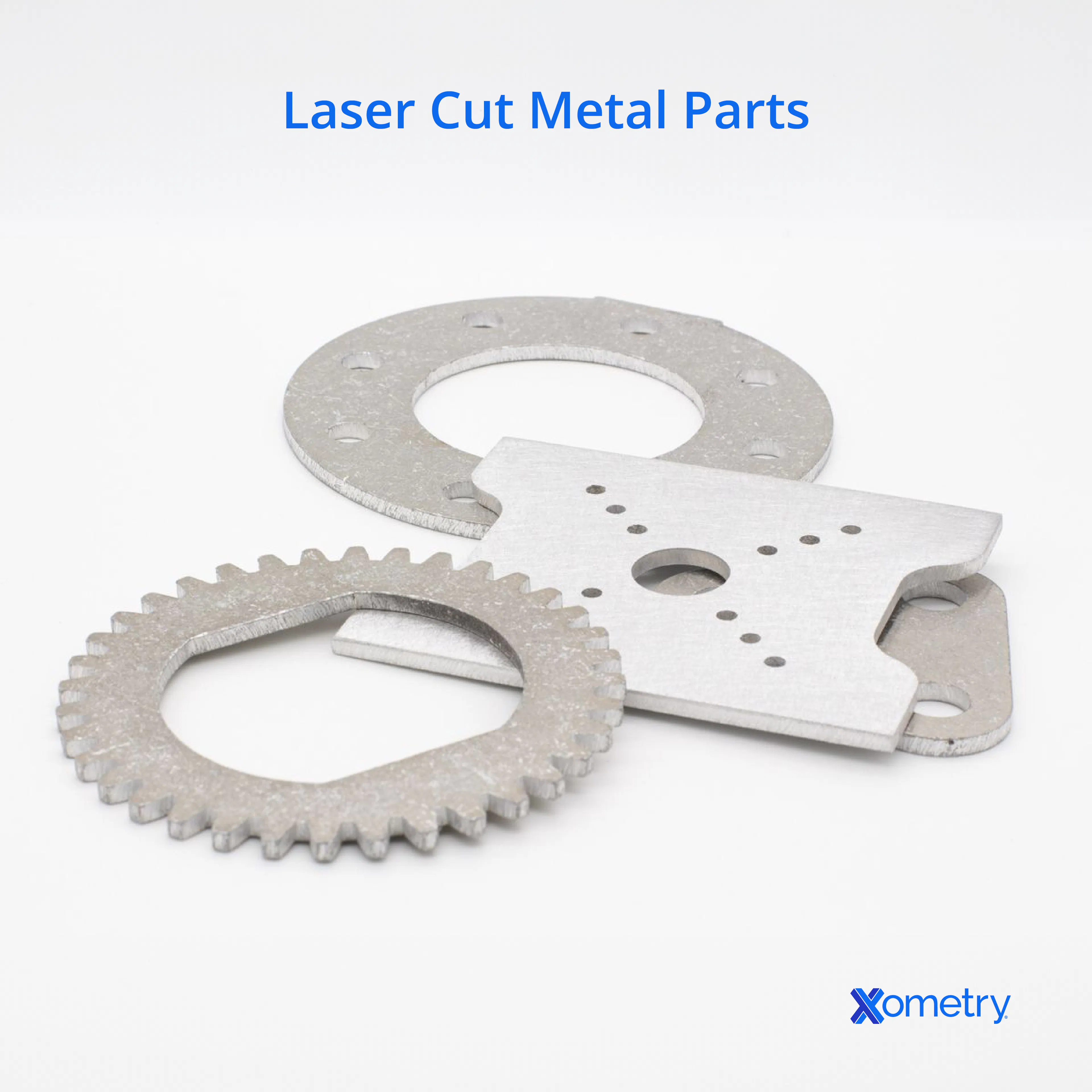

Laser cut metal parts showing the advantages of laser cutting
Laser cut metal parts from Xometry
