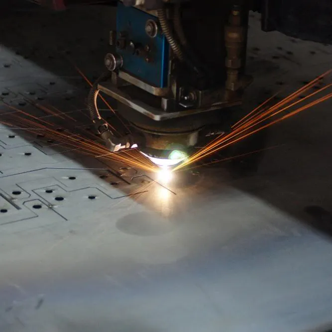

CO2 laser cutting through stainless steel. Image Credit: Shutterstock.com/kittinun kongsuebchat
Most cutting lasers fall into either the CO2 or fiber laser categories. Each technique has strengths and weaknesses that must be evaluated when selecting equipment for any particular task. Fiber lasers can cut almost all materials and do so 3 to 5 times quicker than other styles. However, they work best on sheet materials 5 mm or thinner. In the transition range from 5 to 20 mm thickness, the advantages of fiber lasers are less marked and the capabilities of CO2 lasers can be beneficial. Above 20 mm, fiber lasers rapidly lose their value. Materials like steel with thicknesses of up to 100 mm typically need oxygen-assisted CO2 lasers. This article seeks to explain the differences between CO2 lasers vs. fiber lasers that are important to know when specifying services or purchasing equipment.
