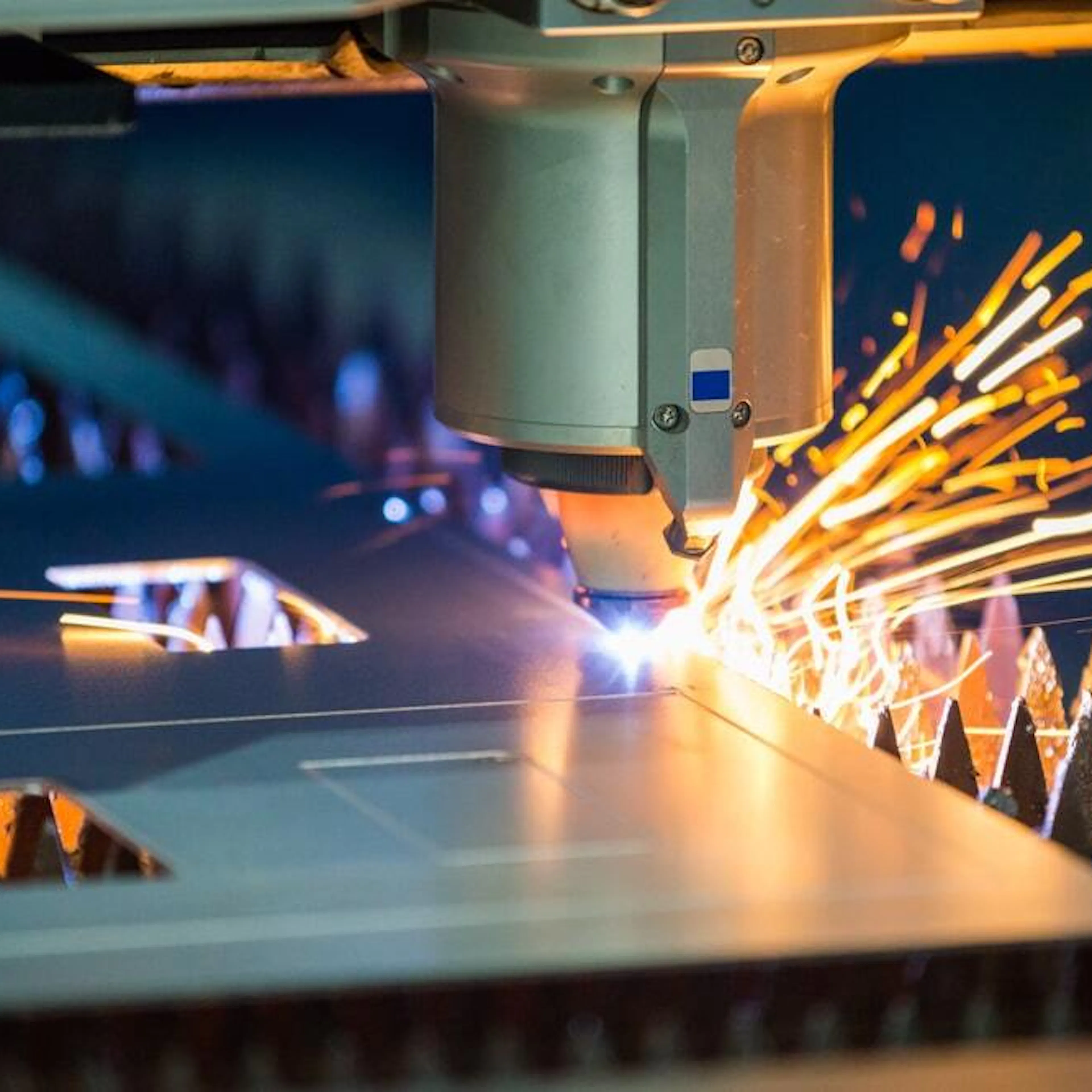

CNC laser cutter. Image Credit: Shutterstock.com/Joshua Davenport
Laser cutting machines are a capable and versatile class of numerically controlled machine tools. They are used in virtually all industries for high throughput, precision cutting, engraving, and marking—from home use cutting card/paper through to shipbuilding and heavy engineering. They apply well-collimated and tightly focused laser radiation to pierce or engrave materials, with CNC-controlled precision and high productivity. There are several types of lasers commonly used in laser cutting, each with its specific characteristics and applications making it apt for selected market niches.

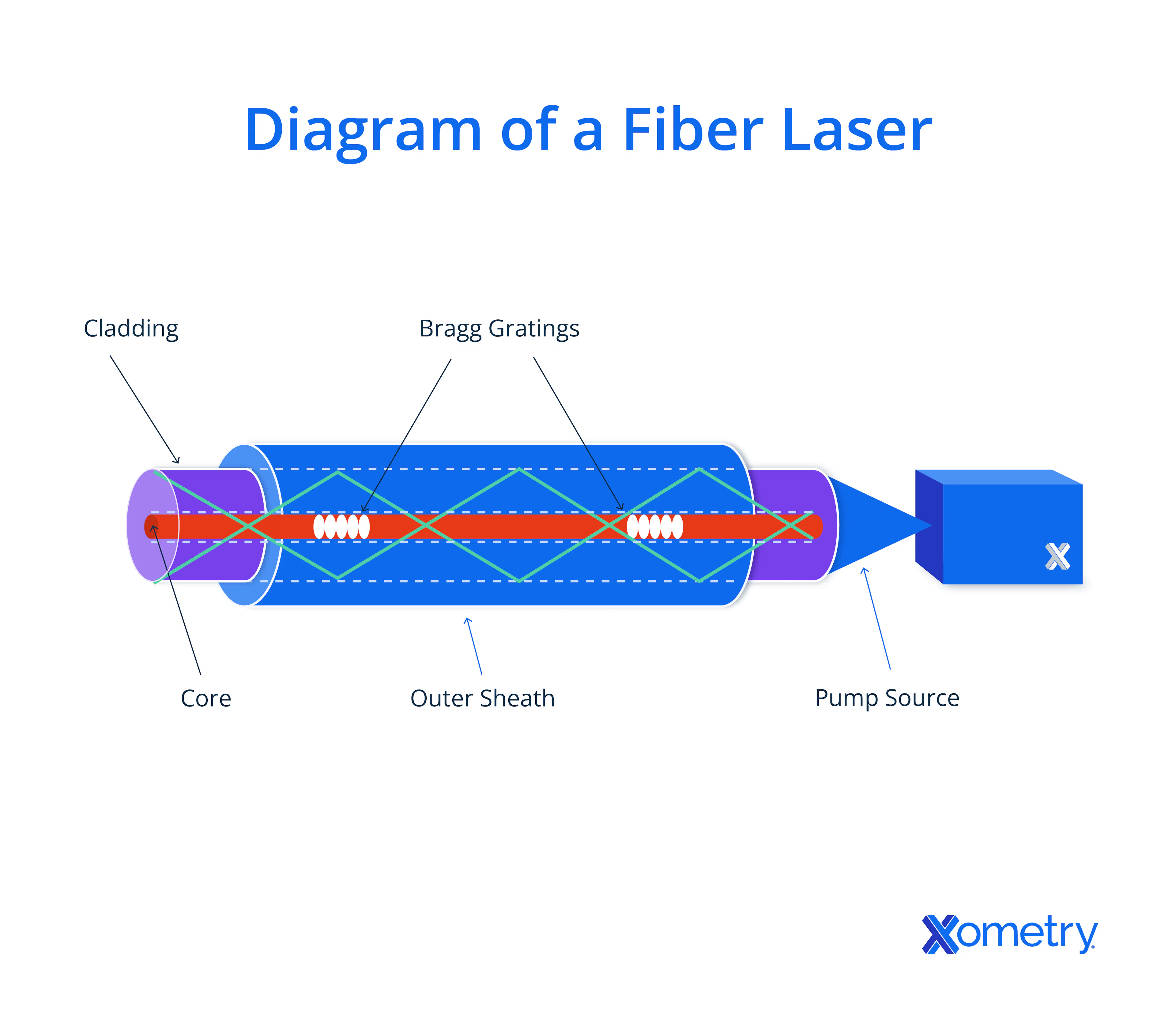

Fiber lasers get their name from the chemically doped optical fiber used to induce the lasing and deliver the energy to the cutting point. The laser source starts with a primer laser, usually a diode type, which injects a low-power beam into the fiber. This beam is then amplified within the optical fiber, which is doped with rare earth elements such as ytterbium (Yb) or erbium (Er). The doping process induces the fiber to act as a gain medium, amplifying the laser beam by cascading excitations/emissions.

Diagram of a Fiber Laser

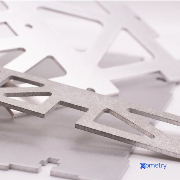

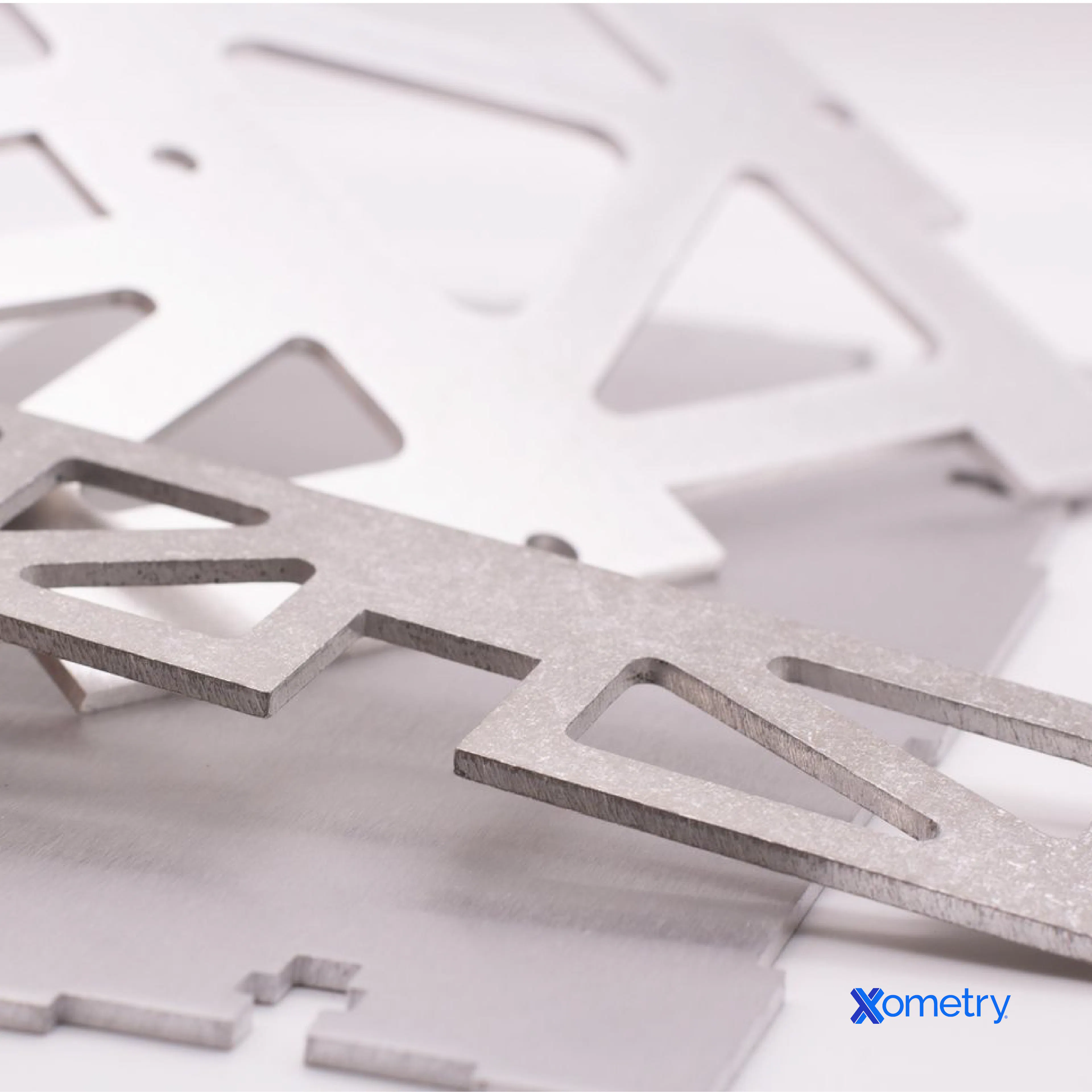

Laser cut parts
Laser cut parts
