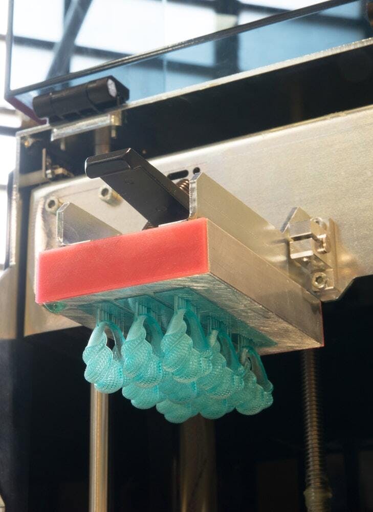

DLP Introduction and Comparison to FDM
Digital light processing was invented in 1987 by Texas Instruments. This photopolymer-based 3D printing technology works by projecting a UV light onto the build platform to polymerize each layer of the part. The layer cross-section needs to be masked so that only the required areas are polymerized. This masking is done with a DMD (Digital Micromirror Device). The DMD uses a micromirror to either direct the light to the photopolymer or direct it to a heat sink below. Alternatively, LED screens can be used as a light source. The masking is done by simply turning off the LEDs wherever polymerization is not required. The resolution of a DLP 3D printer depends on the resolution of the LED or DMD array as well as the distance from the light source to the polymerization zone. DLP parts are made up of cubic volumes called voxels. This means any curved edges look as if they were built from many smaller cubes.
DLP printers are more expensive than FDM printers. They also have smaller build volumes and fewer material options but can print faster at much higher resolution and surface quality. A typical DLP printer is shown in the image below:
To learn more, see our guide on DLP 3D Printing.
A typical DLP printer.
Image Credit: Shutterstock.com/Moreno Soppelsa
