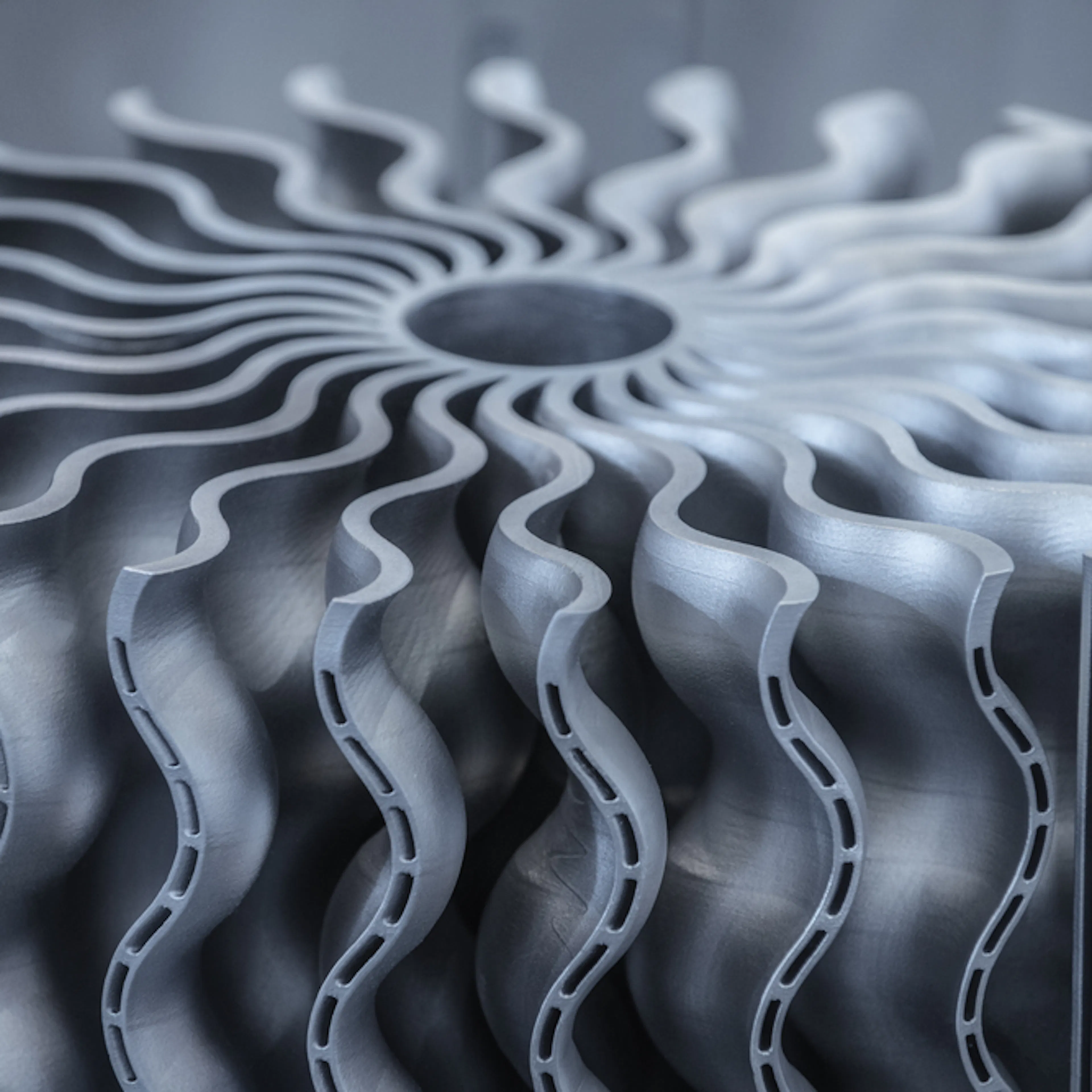

Metal 3D printed aircraft turbine. Image Credit: Shutterstock.com/Sergii Chernov
Metal 3D printing applications are manufacturing processes that build functional metal parts layer by layer from digital design files across aerospace, medical, automotive, and industrial sectors. Metal 3D printing applications demand, residual stress, and dimensional distortion during sintering are recurring challenges that raise production costs and extend lead times. Porosity control, alloy availability, and surface roughness after printing remain persistent technical issues that require secondary machining and rigorous quality inspection. Metal additive manufacturing surpasses conventional fabrication by producing internal cooling channels, lattice structures, and patient-specific geometries in a single uninterrupted build cycle without dedicated tooling. Titanium, Inconel, cobalt-chrome, and stainless steel deliver high-strength, lightweight results that aerospace and medical programs demand, making metal printing the best 3D metal printer application for complex, low-volume, and high-precision production needs.

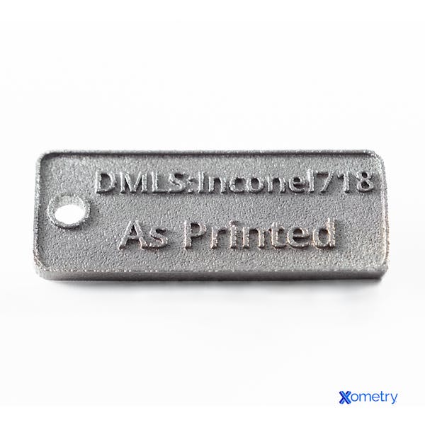

5. Jewelry and Decorative Arts
Jewelry and decorative arts production through metal 3D printing covers the fabrication of intricate gold, silver, bronze, and platinum pieces with undercuts and fine surface details that traditional casting struggles to replicate. Artists and designers produce limited-edition or fully personalized pieces with geometric complexity impossible to achieve through manual goldsmithing or investment casting at equivalent cost. Direct metal additive manufacturing can eliminate wax patterns and casting molds, while many jewelry workflows still use 3D printing to make patterns for investment casting, reducing material waste and shortening the production cycle from weeks to days. Museums and conservators use metal printing to replicate historical artifacts and restore damaged decorative objects with high geometric fidelity. Per-unit costs drop on small production runs compared to hand-fabricated equivalents, making metal printing commercially attractive for the jewelry sector.
A decorative tag made with DMLS metal 3D printing

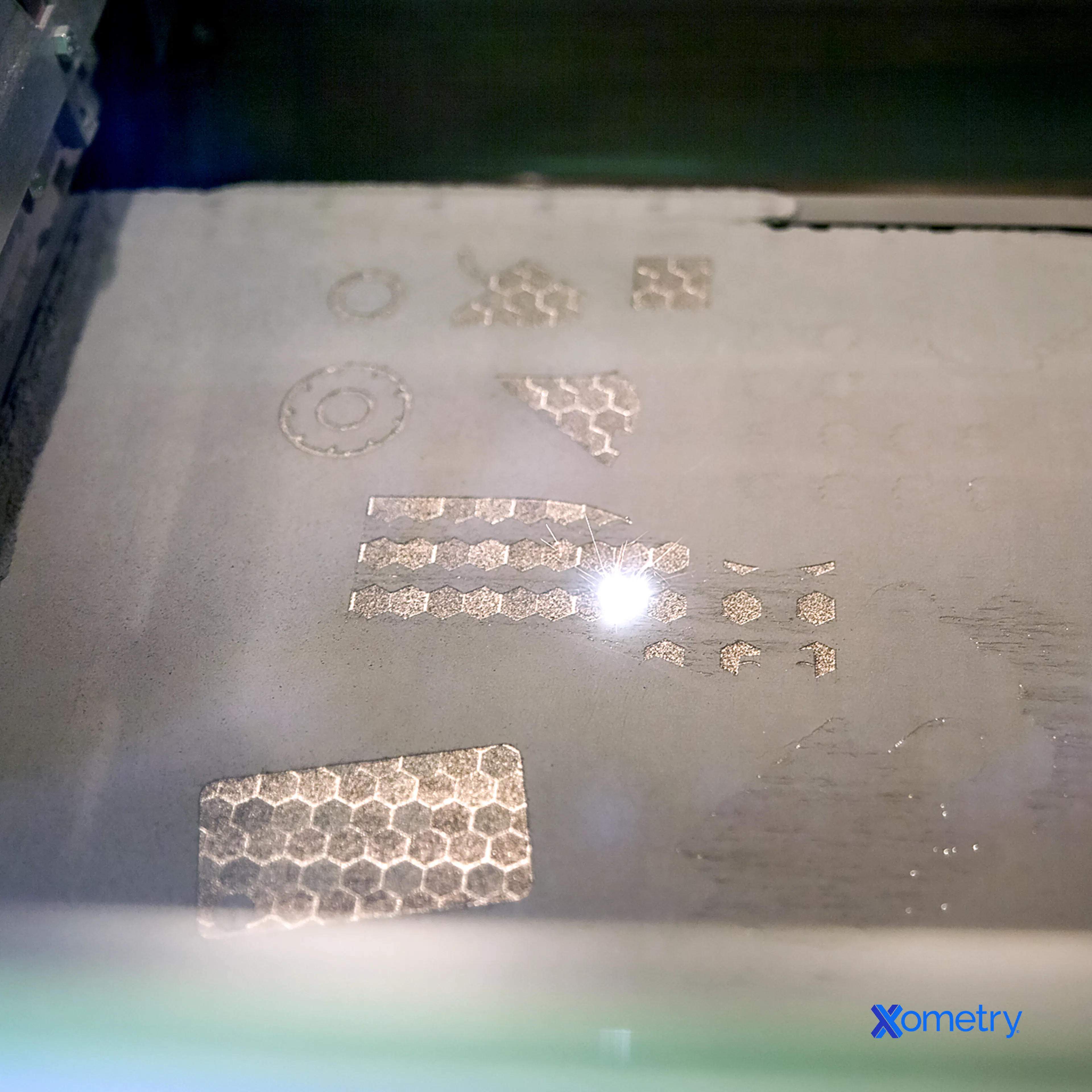

7. Functional Metal Prototypes
Functional metal prototypes are physical metal parts (control linkages, gearbox housings, and robotic grippers) produced from digital files within shorter lead times than many conventional prototype manufacturing routes to support mechanical testing and design validation. Metal additive manufacturing delivers real alloy properties and dimensional geometry that plastic prototypes cannot replicate for load-bearing or thermal testing purposes. Engineers identify fit, interference, and mechanical performance issues before committing capital to production tooling, reducing costly redesign cycles. Surface roughness on as-printed functional prototypes often requires post-machining on bearing surfaces and precision mating faces. Development programs across automotive, aerospace, and medical device sectors reduce time-to-test significantly using metal printing as the primary metal prototype production method.
Prototpyes being made in a DMLS metal 3D printing machine
