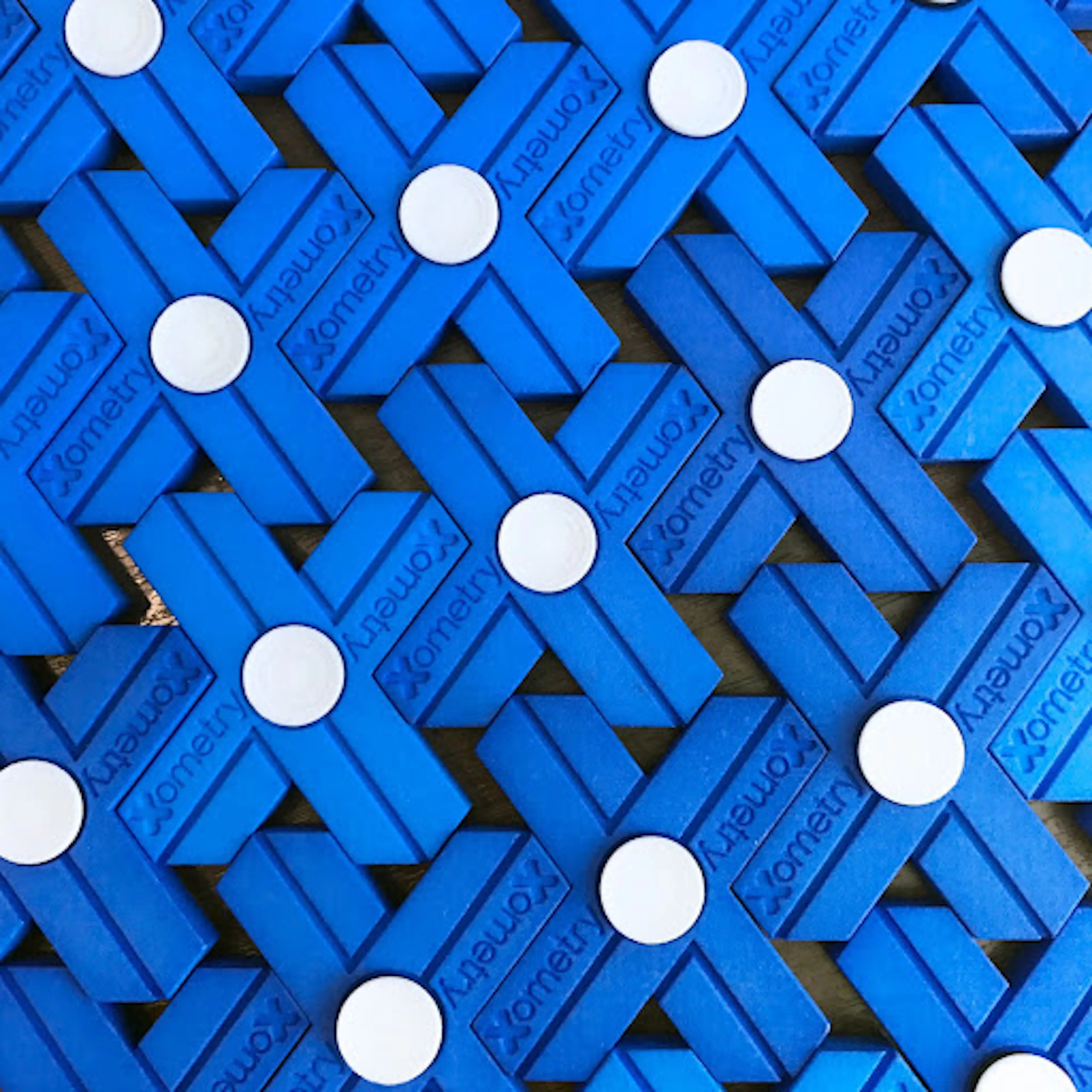

a collection of 3D printed Xometry logos
