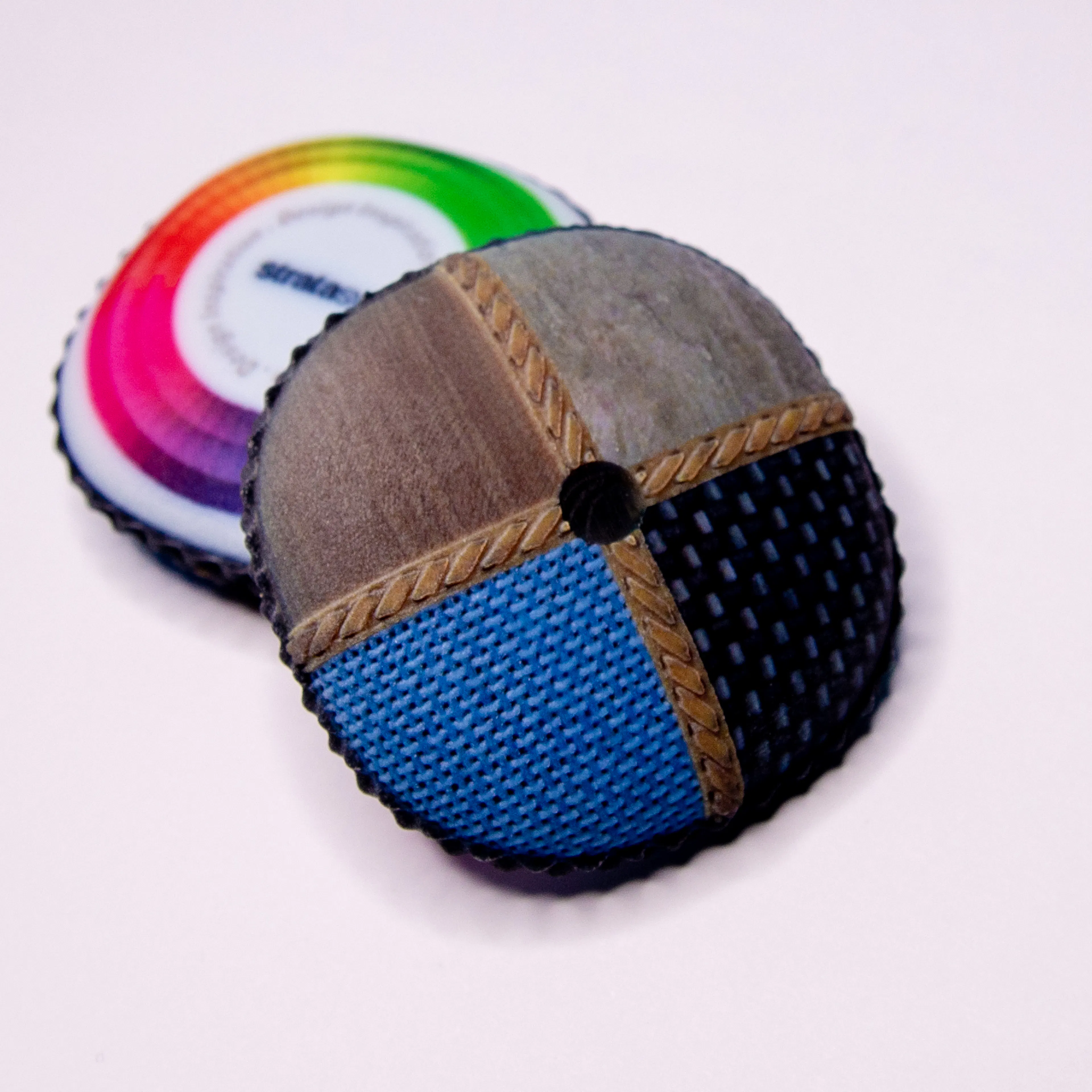

Polyjet multi color print
PolyJet 3D printing is a process used to create multi-color and multi-material components using a process similar to standard inkjet printers. An inkjet-type head deposits multiple droplets of a photopolymer onto a build plate. A UV light source immediately cures this layer and the process is repeated until the part is complete.
The key advantage of PolyJet printing is its ability to create parts with multiple colors and materials in one go. This allows for the creation of prototypes that exactly match the color and physical feel of a final product. PolyJet can also create these multicolor parts much faster than most other 3D printing technologies. PolyJet 3D printing can make use of multiple different materials that can be transparent and have rubber-like properties while also simulating the properties of common thermoplastics like ABS or polypropylene.

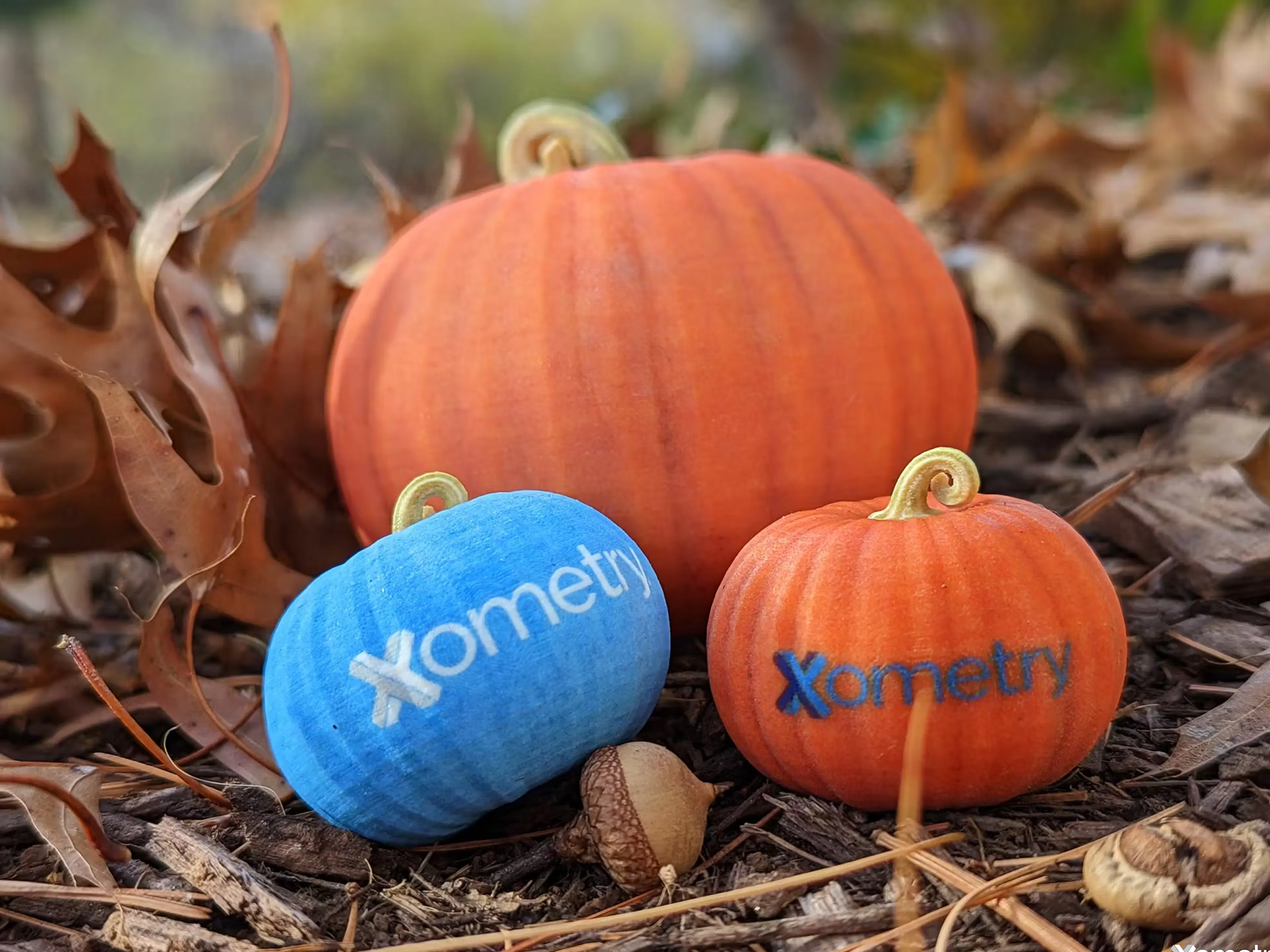

The PolyJet™ 3D printing process makes use of an inlet-style printing head that can deposit multiple different materials from independent nozzles onto the build platform; as such PolyJet™ is a subclass of inkjet printing. The materials used in PolyJet™ printers are exclusively photopolymers. These 3D printed polymers will solidify when exposed to UV light. PolyJet™ parts also require support materials for large overhangs and internal volumes, which means some post-processing may be required. PolyJet is great for color 3D printing, as shown below:
Realistic color pumpkings printed with PolyJet
