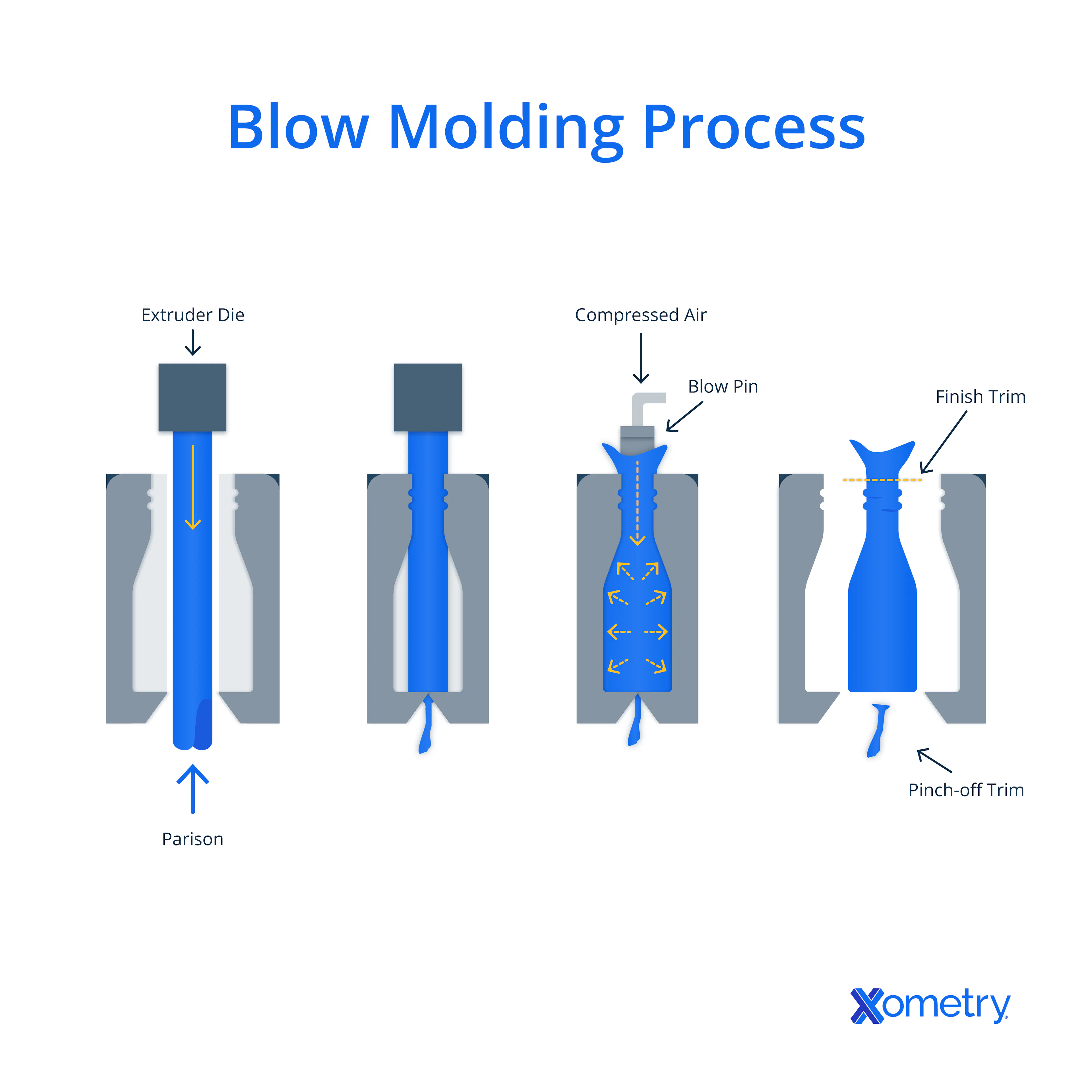

Blow molding is a plastic hollow-part forming process used to make products with simpler designs and thin walls. It’s an ancient technique that first emerged in the form of glassblowing around 1700 BCE in Syria. Later refinements allowed glassblowers to create bottles. The more modern blow molding process matured in the 1930s when the first automatic blow molding machine was introduced by the Plax Corporation.
Most modern blow molding deals with thermoplastics. The procedure, shown in the diagram below, involves a hollow plastic parison (also known as a preform) being placed at the mouth of a mold cavity and heated until properly malleable. Pressurized gas is then forced into the parison’s open end until it expands to match the mold cavity’s shape. The product then gets cooled and crystalized so it doesn’t deform while being removed from the mold.
Blow molding process
This method is ideal for large-scale production thanks to how quickly it can make parts—70 of them in just an hour. It can make thin, lightweight parts with parting line integrity (no visible hems or seams from the mold), and you can control the wall thickness. Though this fully automated approach is best known for soda and water bottles, it also finds uses in engineered gas tanks and electrical enclosures.
It’s preferred over rotational molding for its cost-efficiency in high-output industrial settings, especially at rates higher than 3,000 units per year. Further adding to its cost-efficiency is the mold itself, which lasts a very long time. Having said that, the tooling cost is quite high, and low-volume production quantities work out more expensive. As far as aesthetics, this isn’t typically the method you’d want to use if you need parts with super attractive finishes.
Blow Molding is used for high volume production with simple geometries (symmetrical, simple designs). Think bottles and containers. Fast cycle times, material efficiency, low per-unit cost at scale, and ease of integration for assembly lines make it a good choice for projects. High tooling cost, short cycle times.

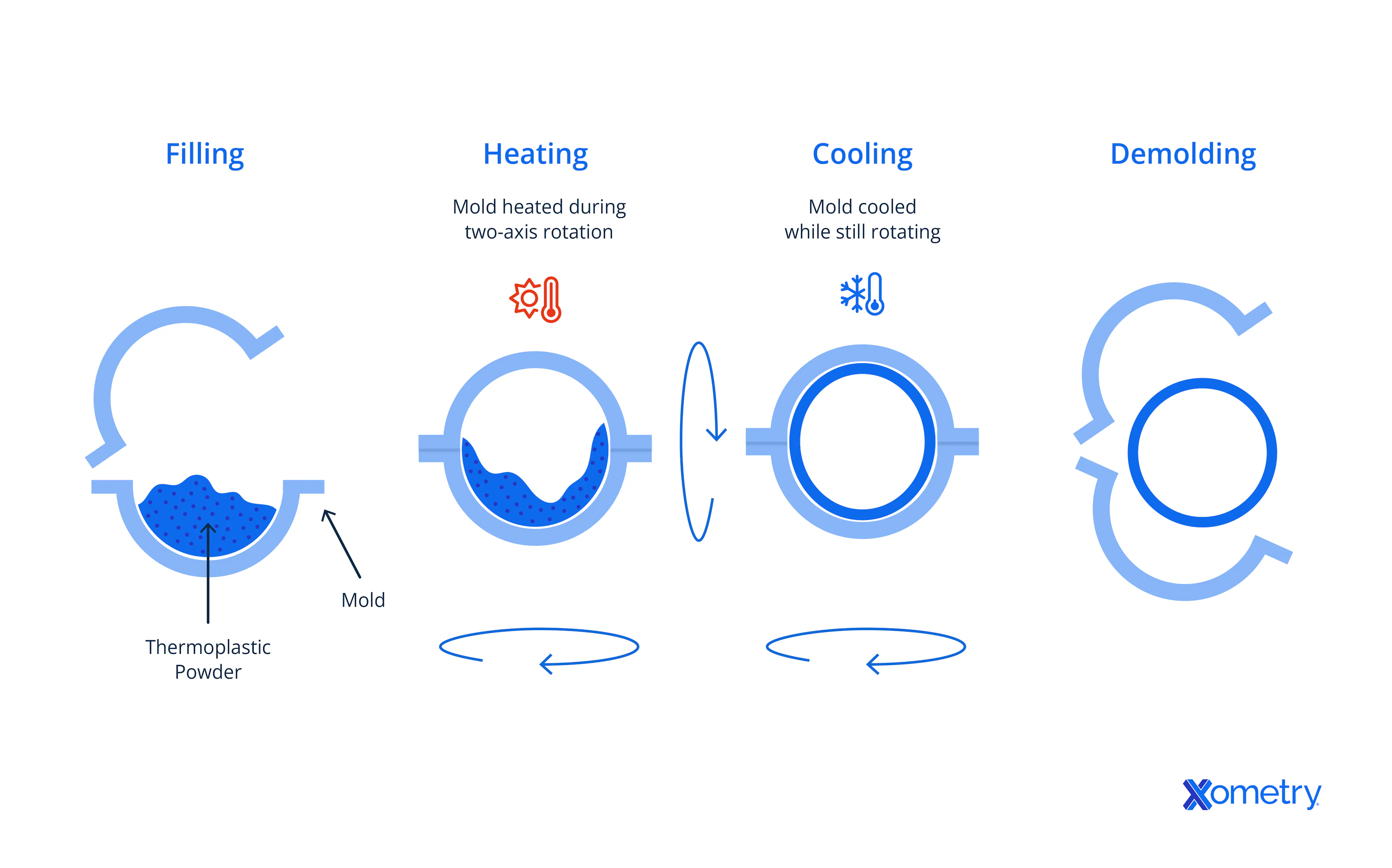

Also known as rotomolding, rotational molding is a high-heat, low-pressure thermoforming process used to make hollow plastic parts. A type of rotational molding was used in ancient Egypt to make ceramics, but an upgraded version was introduced in the U.S. around 1945 for plastics. This wasn’t met with open arms, though, due to its snail-like pace. The plastic powders have since had several upgrades so that they flow more easily and evenly, making the process today much faster (thankfully).
How the rotational molding process works
In the process, which you can see in the above picture, a hollow mold is filled with powdered plastic resin and spun before being transferred to an oven, where the resin melts and coats the mold’s walls. The mold keeps on spinning until the resin cools and hardens into the final desired shape. The mold can then be opened so you can take the part out.
It can make large parts with double walls and an open design, and not much secondary processing is necessary because it doesn’t have any weld lines or seams (as opposed to blow molding). There’s cheaper tooling due to the low pressures involved, and it’s more efficient at lower production volumes of less than 3,000 pieces a year—great for startups and small businesses.
With rotational molding, you get a lot more versatility, design flexibility, and stronger products that are much more durable than those made with blow molding. Rotomolded parts do, however, have thicker walls which uses more material and makes them heavier, and the final product could also end up with voids. This method is pretty labor-intensive, and doesn’t offer good control over the thickness of the walls. The tools also need regular maintenance or replacement.
