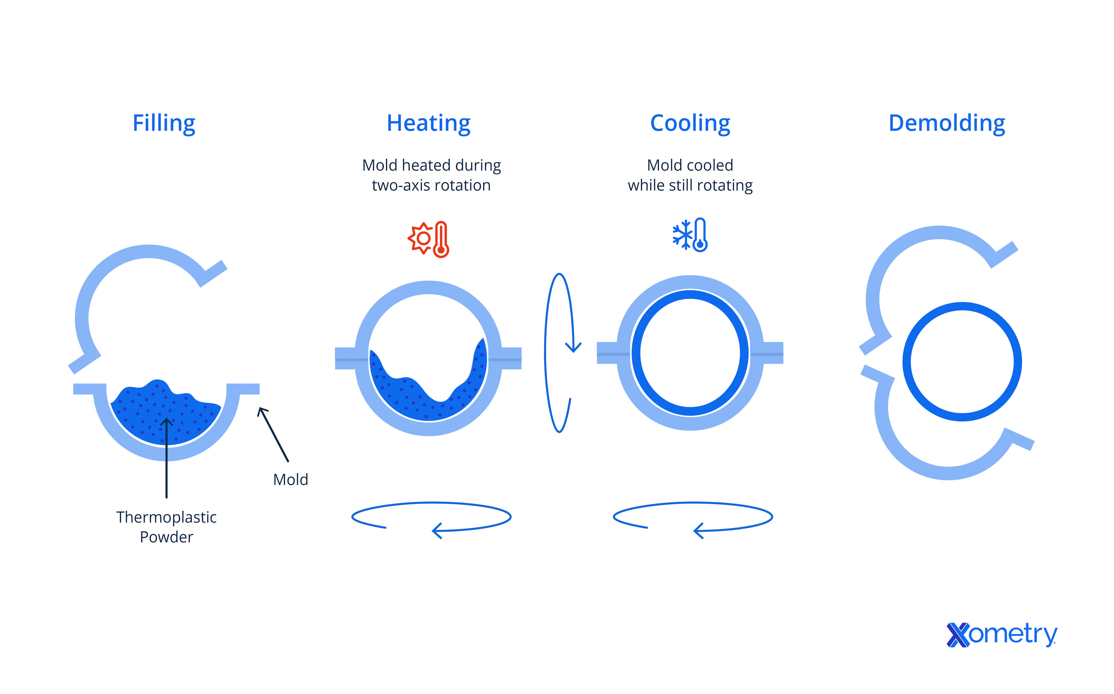

To help you visualize what this looks like, you can see several important steps from the rotational molding process in the image below, including filling, heating, cooling, and removing the product from the molds.
Rotational Molding Process Diagram
The four main phases of the rotational molding process

What Is the Process of Rotational Molding?
The process of rotational molding can be described as follows:
  1. Fill the hollow mold with powdered plastic resin.
  2. Initiate bi-axial rotation of the mold.
  3. Transfer the rotating mold into an oven.
  4. Maintain the rotation while the resin melts and evenly coats the inner walls of the mold.
  5. Cool the rotating mold to allow the resin to harden and take the desired shape.
  6. Stop the rotation and open the mold.
  7. Carefully remove the finished part from the mold.
