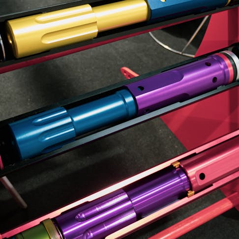

Anodized parts in color. Image Credit: Shutterstock.com/socrates471
