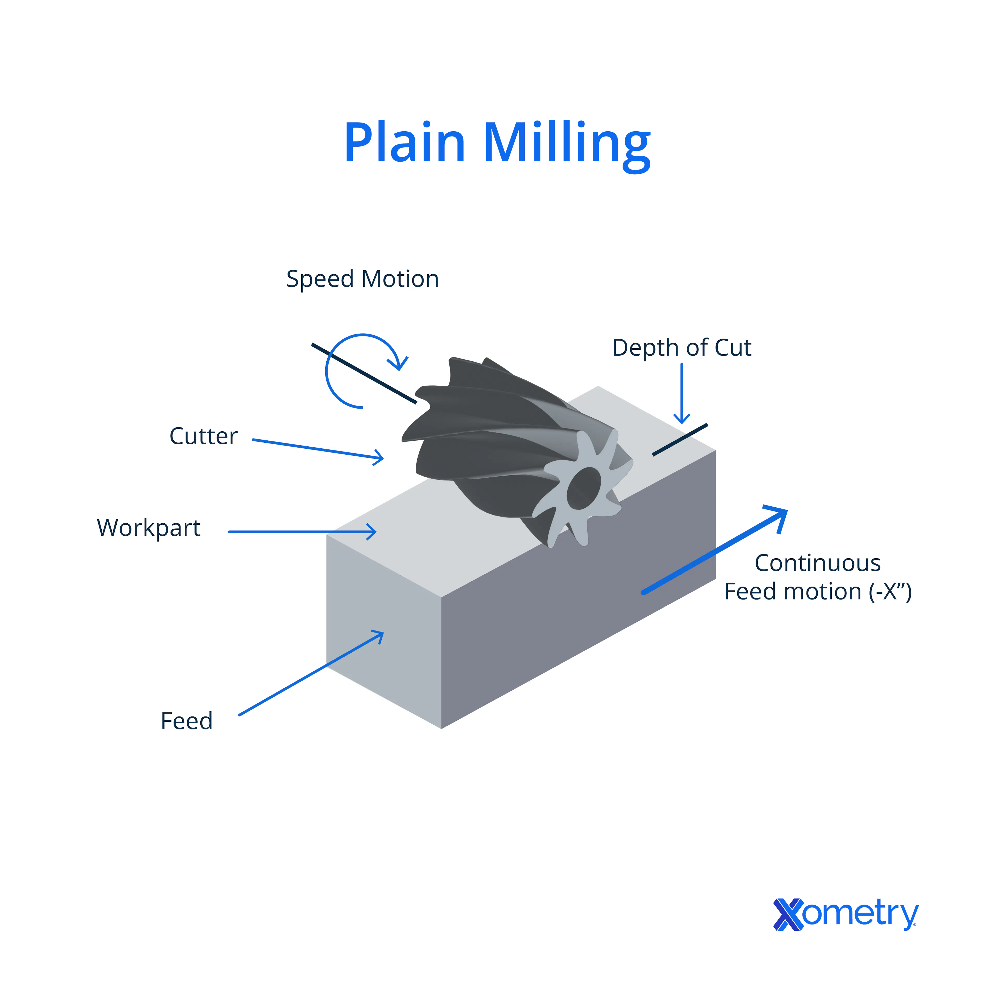

Plain milling, which is also referred to as surface milling or slab milling, is a process used to machine away material with the spinning axis of the tool parallel to the surface of the workpiece. In plain milling, the workpiece is fixed to the bed of the machine as the rotating cutter machine's material from the top face of the workpiece.

The first step of plain milling operations is choosing a light- or heavy-duty cutter and fitting it to the milling machine. For the removal of a large amount of material, a more coarse tool should be used and vice versa. Additionally, when using coarse tools a high table speed and a lower tool speed should be selected and vice versa. Next, the workpiece is secured to the workbench. The work can be held either in a universal vise or in an adjustable angle plate. The alignment of the machine bed should be checked to ensure the cuts made are level. Once these steps are completed the cuts on the work can be made.
Plain milling diagram
