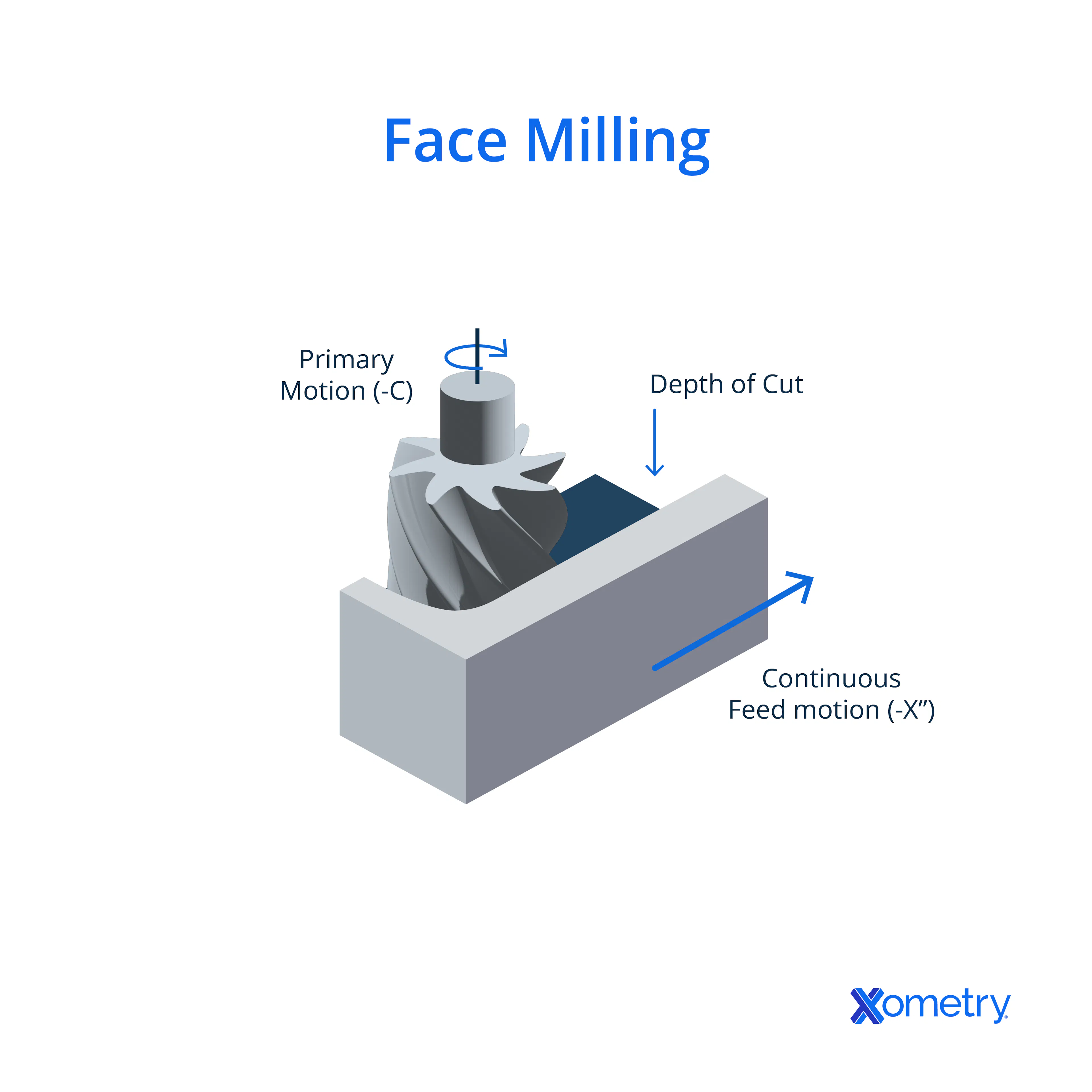

What Is Face Milling in Machining?
Face milling is a specialized CNC milling process used to remove excess material from a workpiece using cutting tools. It is distinct from peripheral milling due to the orientation of the cutting edges relative to the workpiece surface. In face milling, the tool's rotational axis is perpendicular to the surface of the workpiece, and cutting occurs primarily with the face of the tool. For fields in which flat, smooth surfaces are vital, this approach is widely used.
How Does Face Milling Work?
Face milling is a precision machining operation typically involving setup, tool positioning, parameter adjustment, and material removal. To prevent any slippage during machining, the workpiece is firmly fastened to the machine table. The milling cutter is positioned with its rotational axis perpendicular to the workpiece surface, typically using a face mill rather than a fly cutter in modern CNC applications. If required, the proposed movement of the cutting tool is then fine-tuned by changing the feed rate and spindle speed. Finally, machining starts under the guidance of a CNC program, assuring accurate and consistent material removal and workpiece shape.
face milling diagram
Figure 1: A diagram displaying how face milling works
What Is the Purpose of Face Milling?
The purpose of face milling is to create a flat surface on the workpiece, achieved by cutting with the ends of the cutter rather than the sides. This process is essential for achieving precise, flat, and smooth surfaces on materials, such as plates or bars. Face mills often have a diameter larger than the step-over width (not necessarily the full workpiece), allowing efficient surface coverage and material removal.
What Is Face Milling Used For?
Face milling serves as a versatile machining process with diverse applications. It levels surfaces, formats workpieces, and incorporates features like hole patterns and recesses. Edge processing is another key function. While planers can handle very large workpieces, face milling is more common and practical for general machining in both small and large workshops. In woodworking, they're essential for crafting items like cutting boards and preparing wood-epoxy resin tabletops for further finishing. These machines can also efficiently drill rows of holes, enhancing their adaptability.

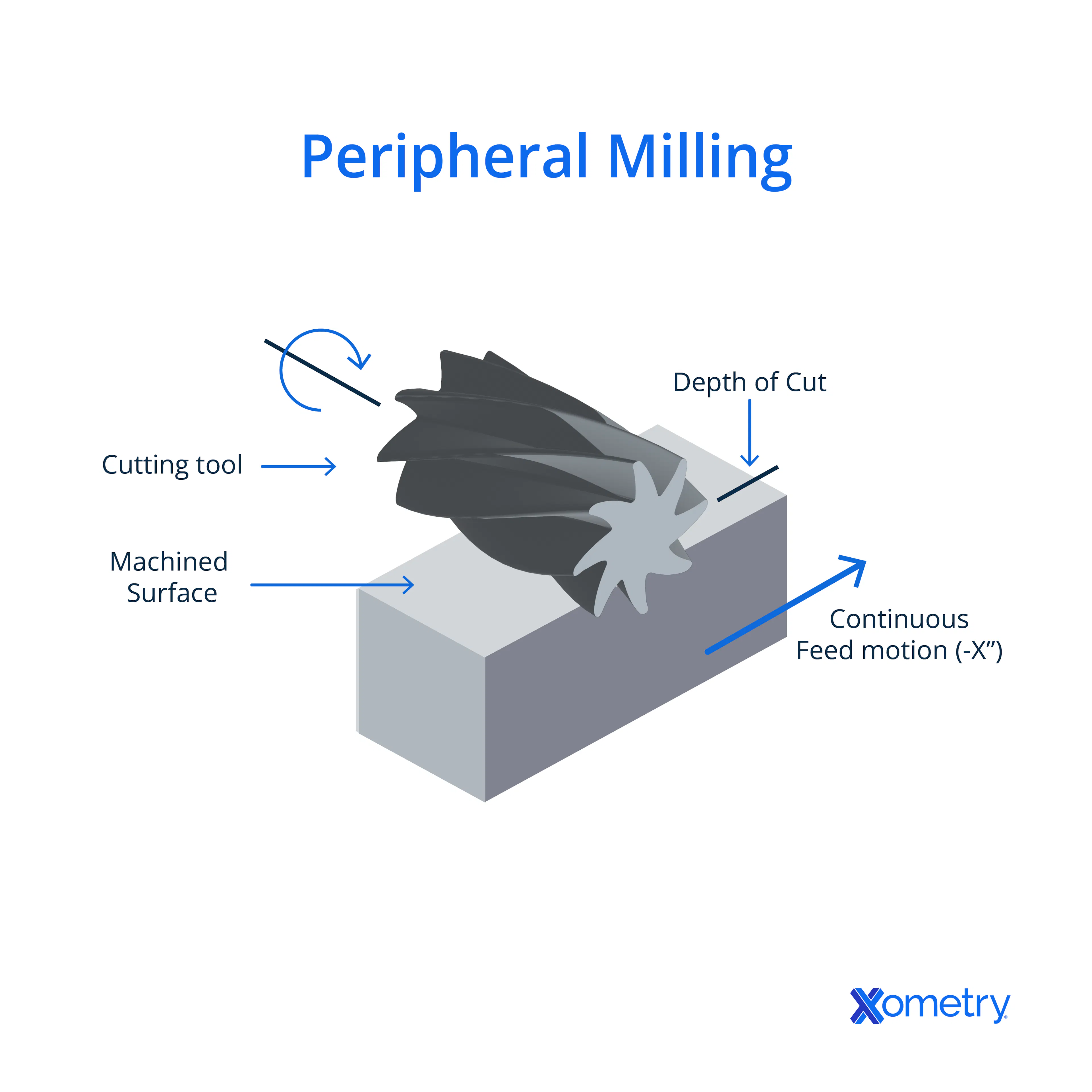

What Is Peripheral Milling in Machining?
Peripheral milling is a machining process in which the cutting action occurs primarily along the periphery (sides) of the milling cutter, using tools with teeth on the circumference. The workpiece's surface is kept parallel to the cutter's axis by performing this operation on a horizontal spindle machine. It is a procedure made to effectively remove material from a workpiece's exterior, enabling precision contouring and shaping. It is essential in industries that demand detailed and precise workpiece profiles.
How Does Peripheral Milling Work?
Peripheral milling is a machining process that removes material from the outer surfaces of a workpiece using the side edges of a rotating cutter. The process typically begins with securing the workpiece to the machine table and aligning it for lateral engagement with the rotating cutter. A suitable side-cutting tool, such as a slab mill, helical cutter, or staggered tooth cutter, is selected and positioned to cut along the length or side of the workpiece. As the cutter rotates, it removes material from the workpiece's periphery, allowing for accurate shaping. This method is ideal for external surface machining, especially for operations like contouring, slotting, and shoulder milling. Quality checks are performed to ensure the workpiece meets the required specifications.
peripheral milling diagram
Figure 2: A diagram showing how peripheral milling works.
What Is the Purpose of Peripheral Milling?
The main purpose of peripheral milling is to remove material efficiently from the sides or outer surfaces of a workpiece. This effectiveness comes from using the cutter's sides rather than its tip, which enables faster material removal rates. Peripheral milling uses the full length of the cutting edges along the side of the tool, whereas face milling primarily engages the tool’s end or face. It is the best option for applications requiring quick material removal and productivity benefits.
What Is Peripheral Milling Used For?
Peripheral milling has a broad range of applications, including slabbing operations to cut large material slabs, profile milling for intricate shaping, slotting to create grooves or slots, straddle milling for simultaneous milling on two parallel surfaces, and slitting operations for precision cutting. Moreover, it's used in the milling of facades or slopes and finds a vital role in rough machining, particularly in mold making, in which material removal rates and productivity are essential considerations.

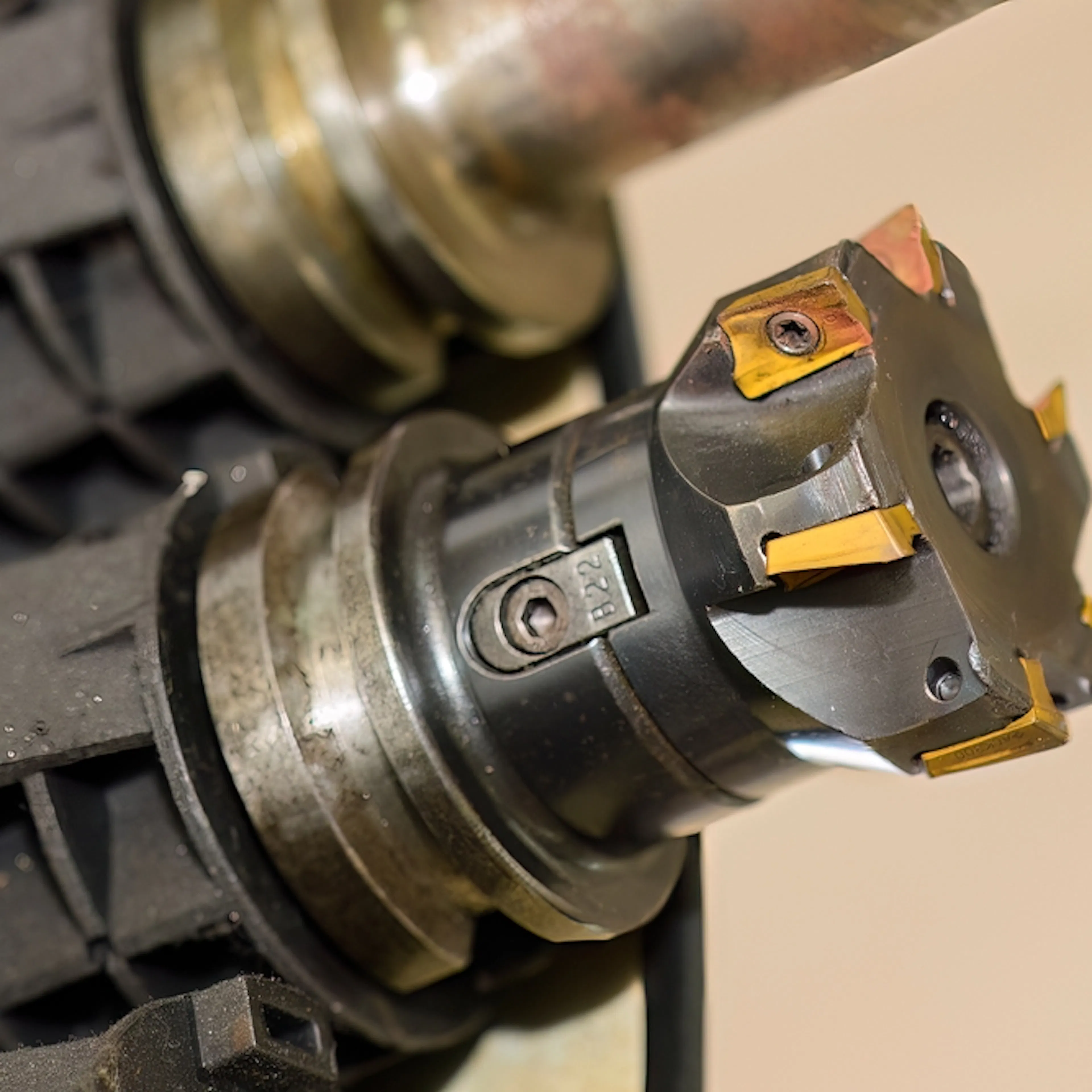

How Do Face Milling Tools Differ from Peripheral Milling Tools?
Face milling tools and peripheral milling tools are designed differently to suit their respective machining methods. Face milling tools have multiple inserts that engage the workpiece's flat surface, facilitating efficient material removal and a smoother surface finish. Common tools for face milling include face mills and fly cutters. Peripheral milling tools are intended for machining the edges of a workpiece. They typically have fewer inserts and are designed for cutting along the workpiece's periphery. Common peripheral milling tools include end mills and slot drills. These tools are more suitable for contouring and slotting operations.
