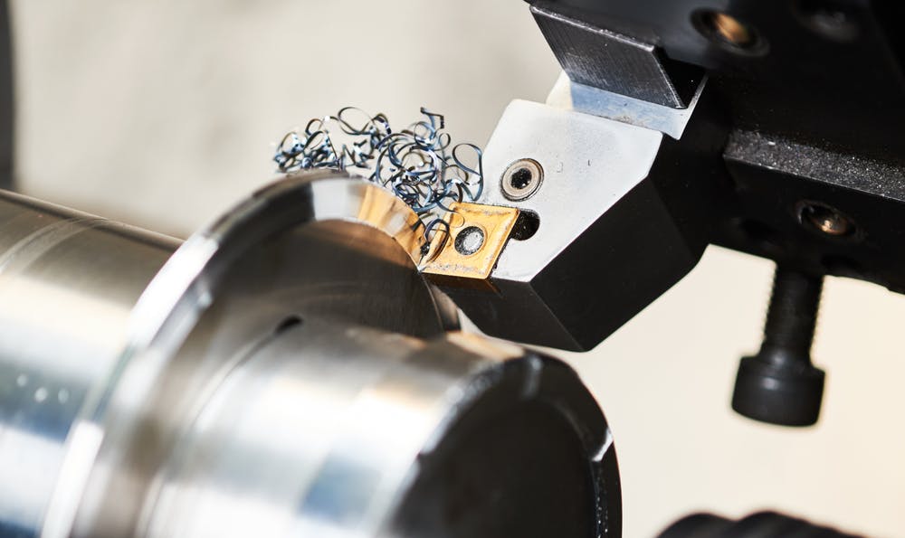

Step turning on a lathe. Image Credit: Shutterstock.com/akiti
Step turning is one of the fundamental turning operations and is used to great effect in several industries. It is used to produce shafts with varying diameters, with the change between diameters being a perpendicular step. Step turning is used primarily in machine design applications for shafts that need to have bearings, drive elements, and power transmission components installed on them. These components typically all require different diameters. Step turning can produce precise geometries but can also be wasteful, especially if there is a large difference between the various stepped diameters.

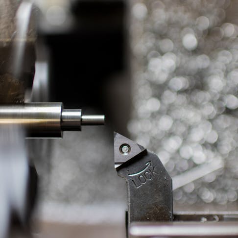

The process of step turning begins with fixing a cylindrical piece of material, either a round bar or a hollow bar, into the chuck of the lathe. Next, the cutting tool is selected and mounted to the tool post. In general, a straight cutting tool can be used. The required rotating speed of the lathe is selected based on standard speed and feed recommendations, and the machine is started up.
The end of the workpiece must then be faced using a straight-cutting tool. Next, the outer diameter of the workpiece is cut using a standard, straight cutting tool. This process removes any mill scale while also discarding any deviations in the diameter of the part. This first cut can typically be a rough cut that is meant to remove a lot of material in one pass. Then a final finishing pass can be performed to reduce the diameter to match the diameter of the largest required diameter on the workpiece.
Starting at the end furthest away from the chuck, the cutting tool is then introduced into the rotating workpiece. Depending on the depth of the step, either a single cut or multiple cuts are performed to reduce the diameter. If the step requires a slight radius, which is typically the norm to reduce stress concentrations, then the straight-cutting tool can be moved axially along the shaft performing multiple cutting passes until the shaft matches the required diameter and reaches the corner of the step. Then, the tool can be backed out perpendicularly to the shaft axis to produce a straight perpendicular edge. The tool radius determines the corner step radius; for larger radii, a CNC machine would need to be used to create the radius.
