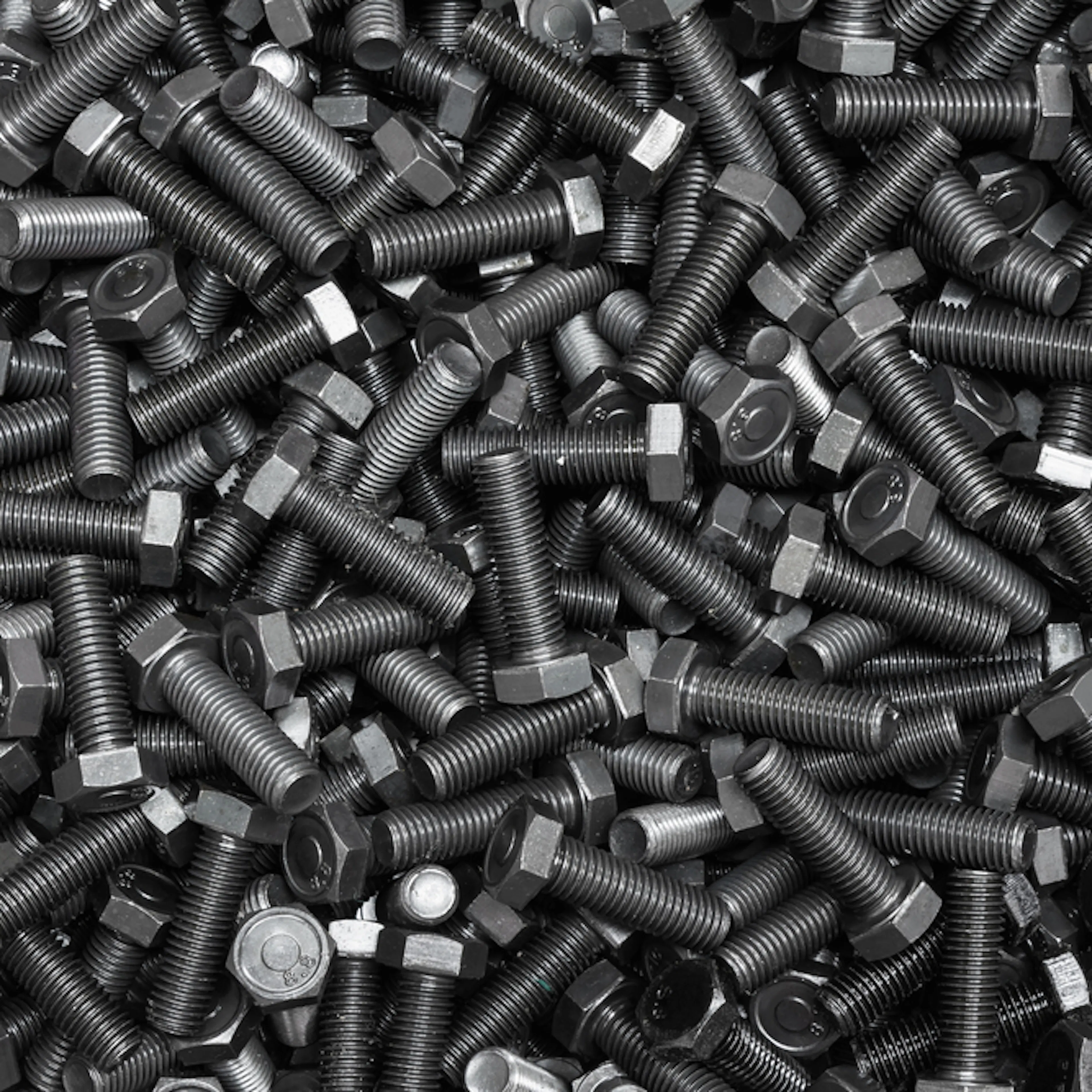

Black oxide coated bolts. Image Credit: Shutterstock.com/Matee Nuserm
Black Oxide Coating is a chemical conversion finish used primarily on ferrous metals to improve appearance and provide mild corrosion resistance. Black Oxide Coating results from a chemical reaction between the iron on the surface and an alkaline salt solution. The finish transforms the outer layer into magnetite (Fe3O4), which presents a deep black color. Manufacturers select the method for precision parts because the process adds negligible dimensional thickness to the component.
The treatment finds use on gears, fasteners, and firearm components. Subsequent sections describe the mechanics of the chemical bath and the specific steps in the application.
The process involves immersion in an alkaline solution at temperatures from 285°F to 295°F. Subsequent rinsing and sealing stages ensure the longevity of the finish. The text explores the benefits of stainless steel and medium carbon alloys. Users find details on the industrial applications across the automotive and medical sectors. Comparison to anodized aluminum finishes highlights the differences in oxide formation. Safety protocols and design considerations for CNC machined parts receive detailed attention. The reliability of the finish depends on the quality of the post-treatment sealant (oil or wax). Standard thickness for the layer stays from [0.00006 to 0.0001] inches. The procedure remains a standard in the manufacturing industry for its efficiency and low cost.

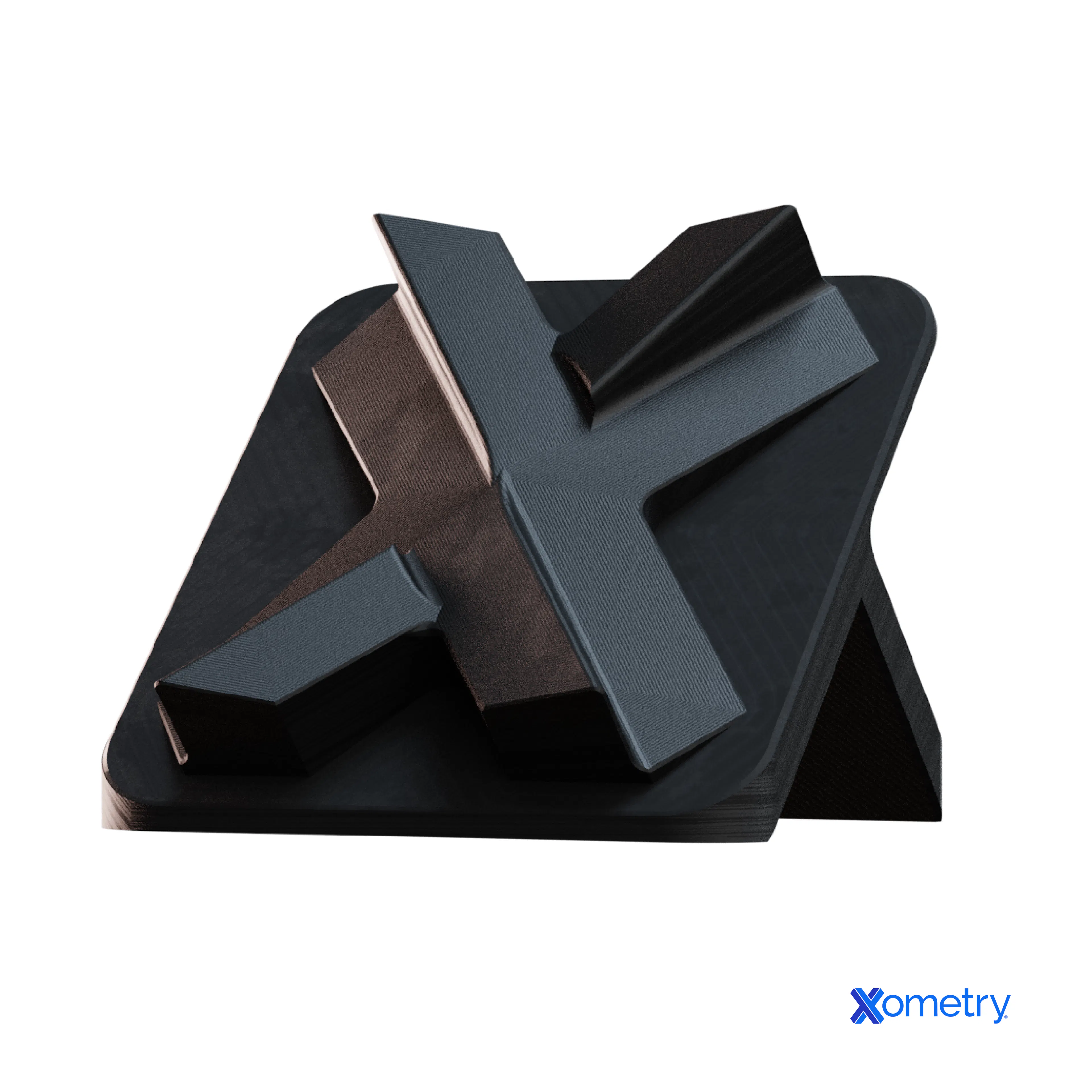

Does Black Oxide Change the Surface of Metal? Yes, black oxide changes the surface of metal by converting the outer layer into a chemical oxide. The transformation alters the molecular structure of the top [1.5 to 2.5] microns of the substrate. No material is added to the component, which preserves the original dimensional tolerances. The surface is chemically altered to form magnetite (Fe3O4) rather than red iron oxide (Fe2O3). The conversion process provides a change in color from gray to deep black. The texture of the surface remains identical to the pre-treated condition. Smooth surfaces result in glossy finishes while rough surfaces produce matte appearances. The chemical change creates a porous structure that acts as a reservoir for corrosion-inhibiting lubricants. The finish improves the durability of the component by preventing the progression of atmospheric rust. The integration of the oxide layer prevents the peeling associated with paints. Dimensional stability makes the treatment ideal for high-precision assemblies. The transformation happens at the molecular level without bulk distortion.
black oxide on a metal X
Black oxide
