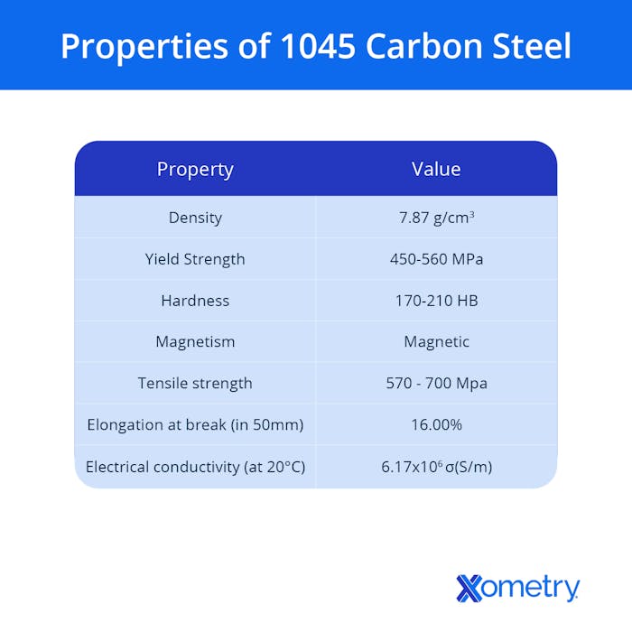

What Are the Properties of 1045 Carbon Steel?
Table 2 summarizes the properties of 1045 carbon steel:
1045 carbon steel properties
Table 2: Properties of 1045 Carbon Steel
