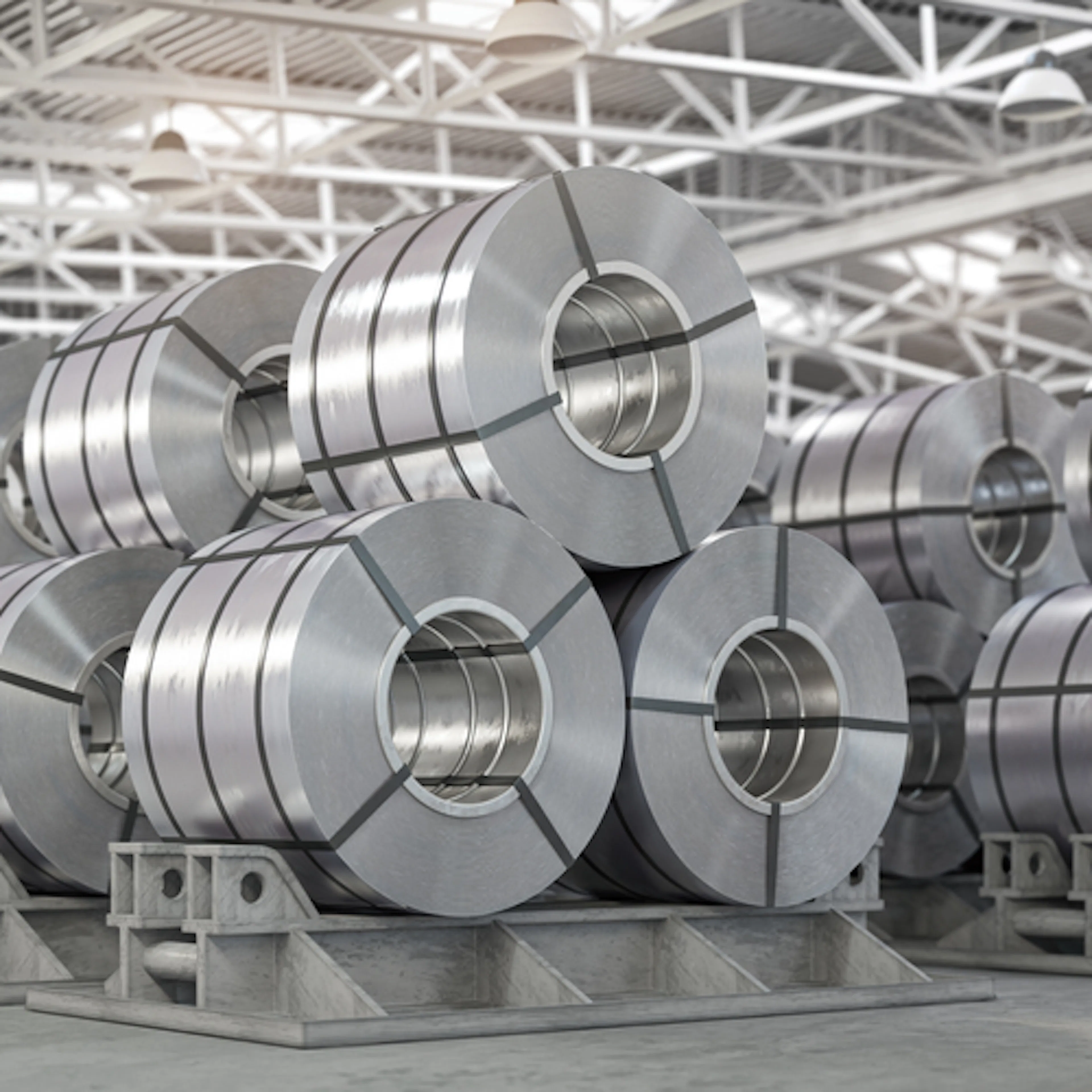

304 rolled steel. Image Credit: Shutterstock.com/Maxx-Studio

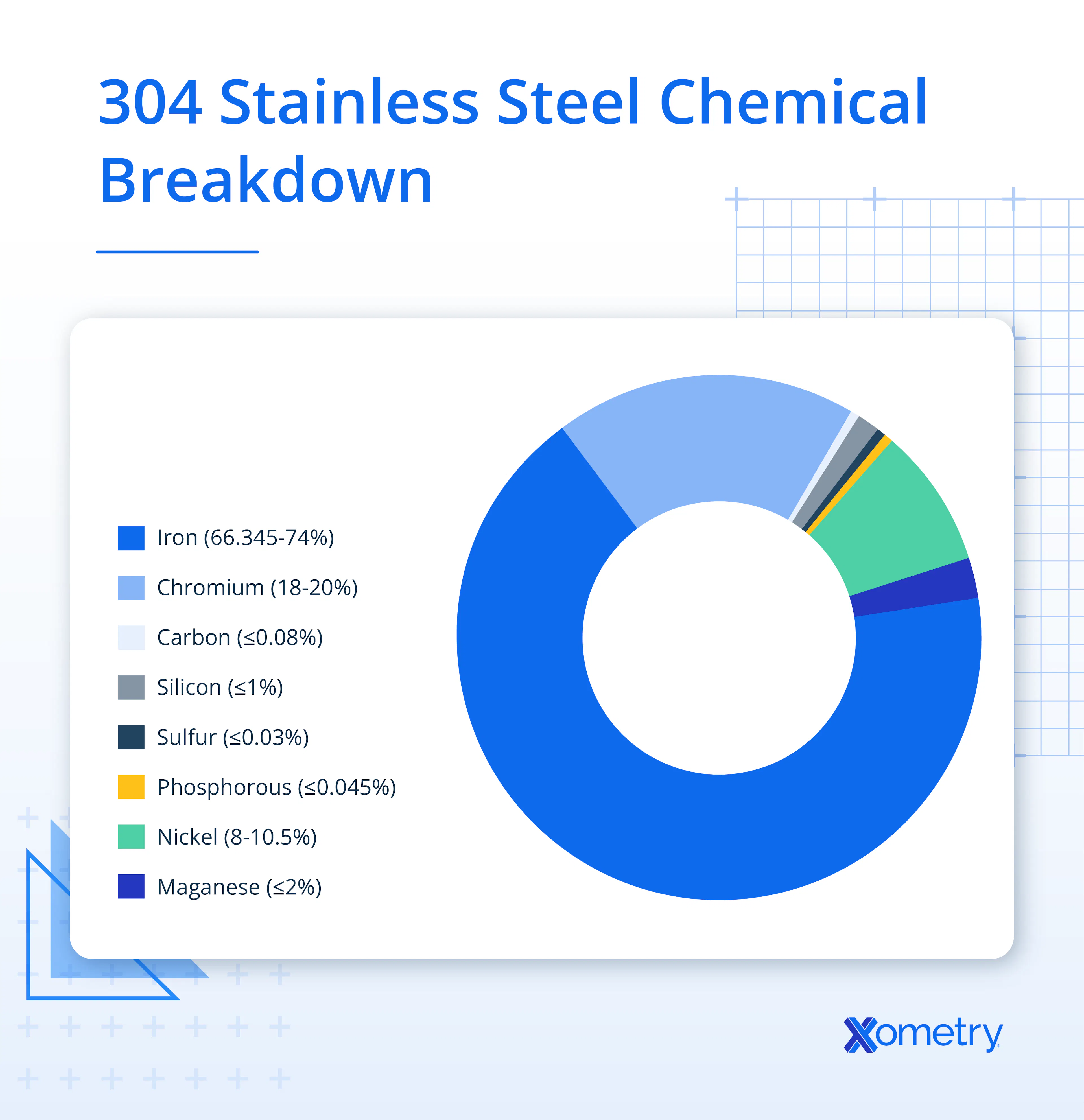

What Is the Chemical Composition of 304 Stainless Steel?
The main element of steel is iron. It is present in 304 stainless steel at a level between 66% and 75%. The iron content of 304 stainless steel is much lower than other steels due to its high content of alloying elements. 304 stainless steel also has a chromium content of 17–20% and a nickel content of 8–11%. The full composition of 304 stainless steel is shown in donut chart below:
304 Stainless Steel Chemical Breakdown
