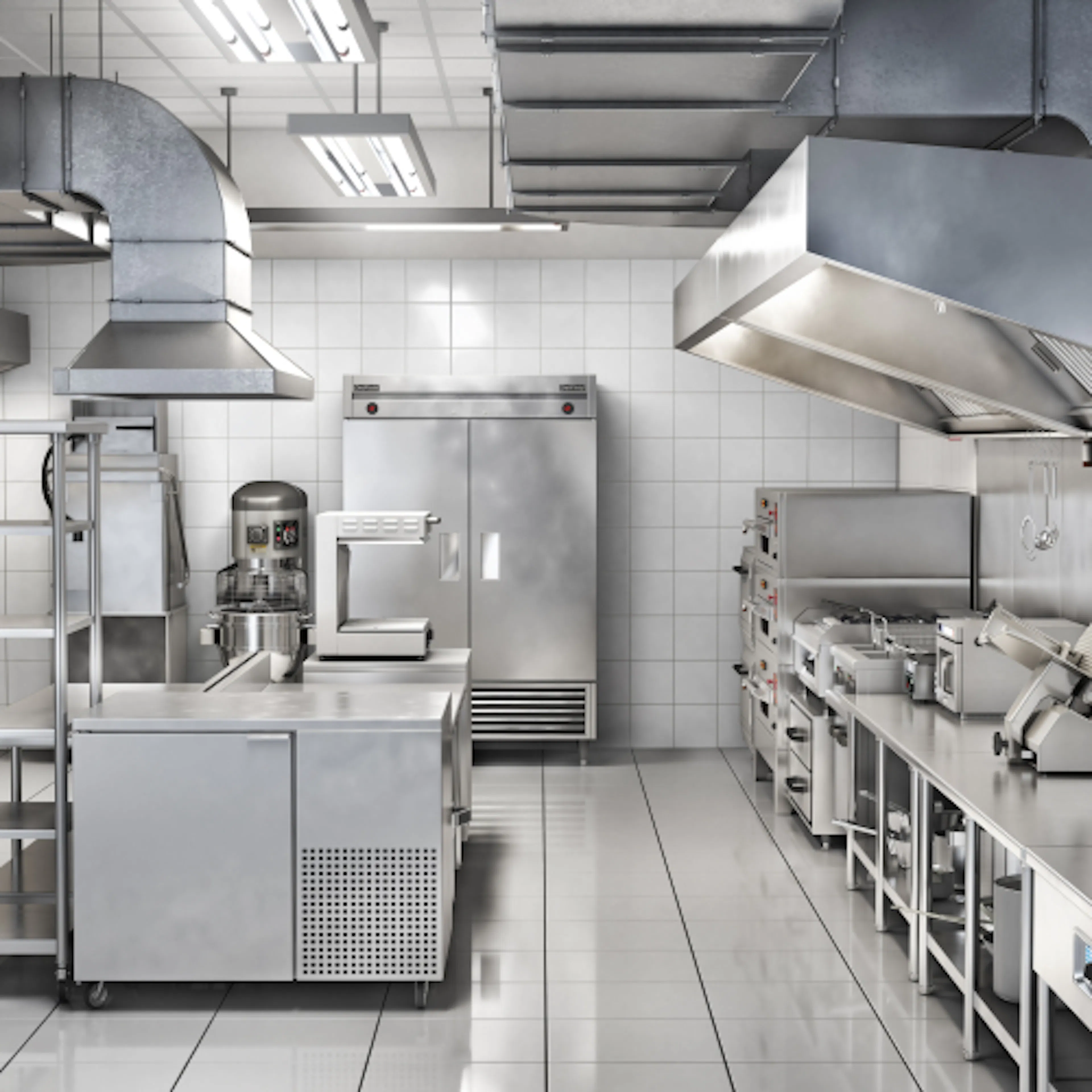

430 stainless steel. Image Credit: Shutterstock.com/studiovin
430 stainless steels are a commercially important class of materials, as they deliver much of the material-property range of similar, higher-cost materials. This is a result of careful tuning of the alloy to provide many of the beneficial properties of the broader class, with minimal use of the highest-cost alloying components such as nickel (at most, variants contain 0–0.75%). It derives many of its beneficial properties from the 16–18% chromium content. It is generally manufactured using a carbon arc furnace or inductive furnace.
430 stainless steel is not suited to the highest-stress applications and has only moderate resistance to aggressive environments. These materials, however, function extremely well and offer fairly good processing characteristics which make them well-suited to the majority of stainless steel applications. This article will further discuss 430 stainless steel, its uses, composition, and properties.
