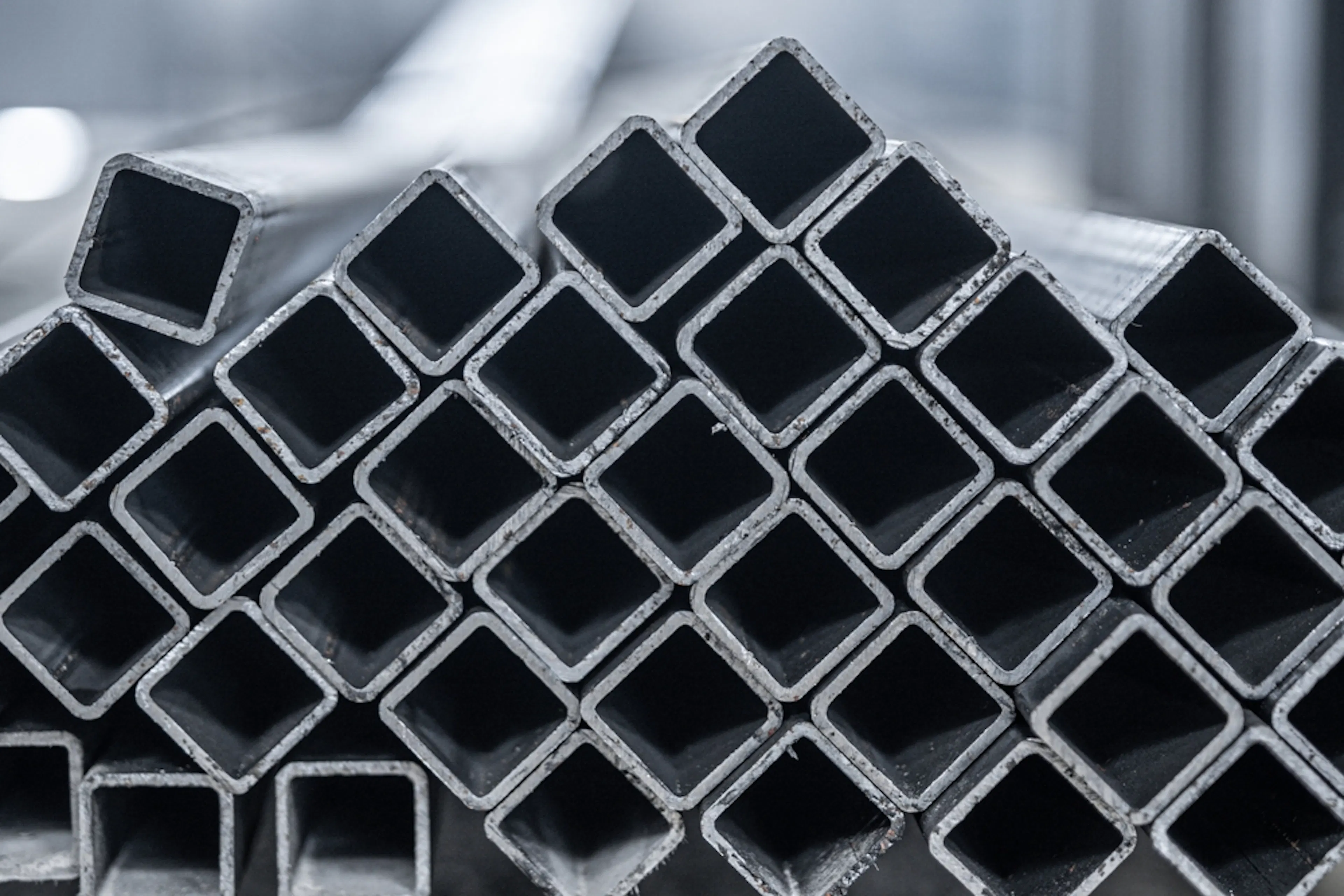

Steel tubes. Image Credit: Shutterstock.com/SOK Studio

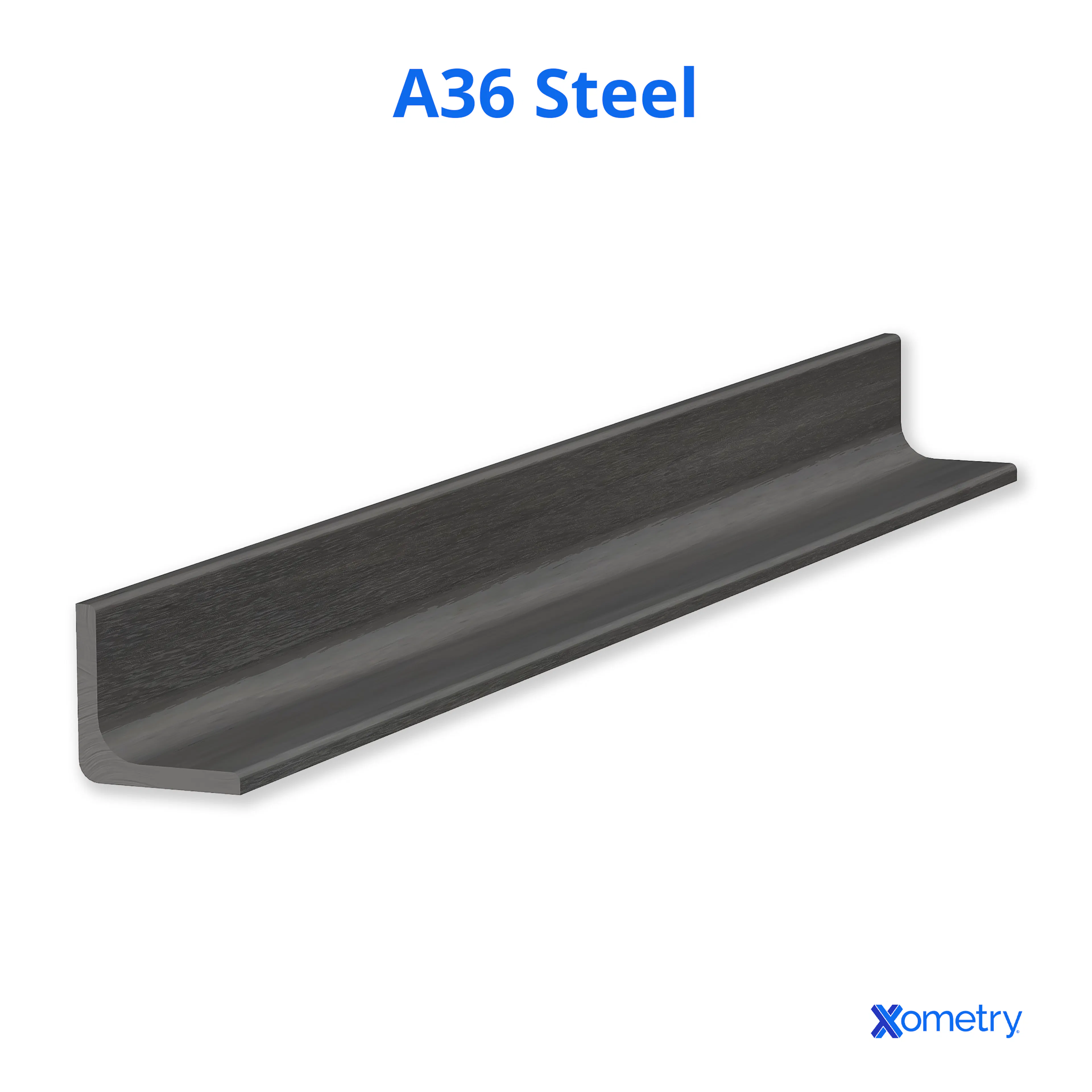

A36 steel angle
A36 steel angle

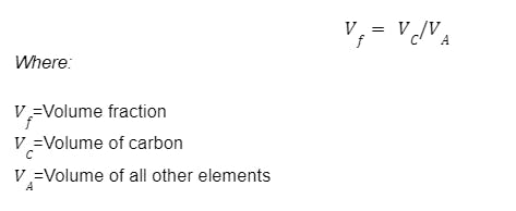

Does Carbon Content Affect A36 Steel’s Mechanical Properties?
Yes, carbon content affects the mechanical properties of A36 steel by determining the balance between strength and ductility. Higher carbon levels increase the hardness and yield point but make the material more brittle and difficult to weld. A36 maintains a low carbon range to ensure the steel stays flexible enough for structural bending. Low carbon contributes to good ductility and toughness, but fatigue resistance depends on multiple factors such as microstructure, surface condition, and loading andd not carbon content alone. Fabricators rely on the low carbon content to achieve high-quality welded joints without the need for complex heat treatments. Toughness varies with temperature and processing; A36 can lose toughness at low temperatures. Engineering standards specify the carbon limits to guarantee a predictable response to environmental stresses. Balanced chemistry ensures that the alloy serves as a reliable structural component for decades.
