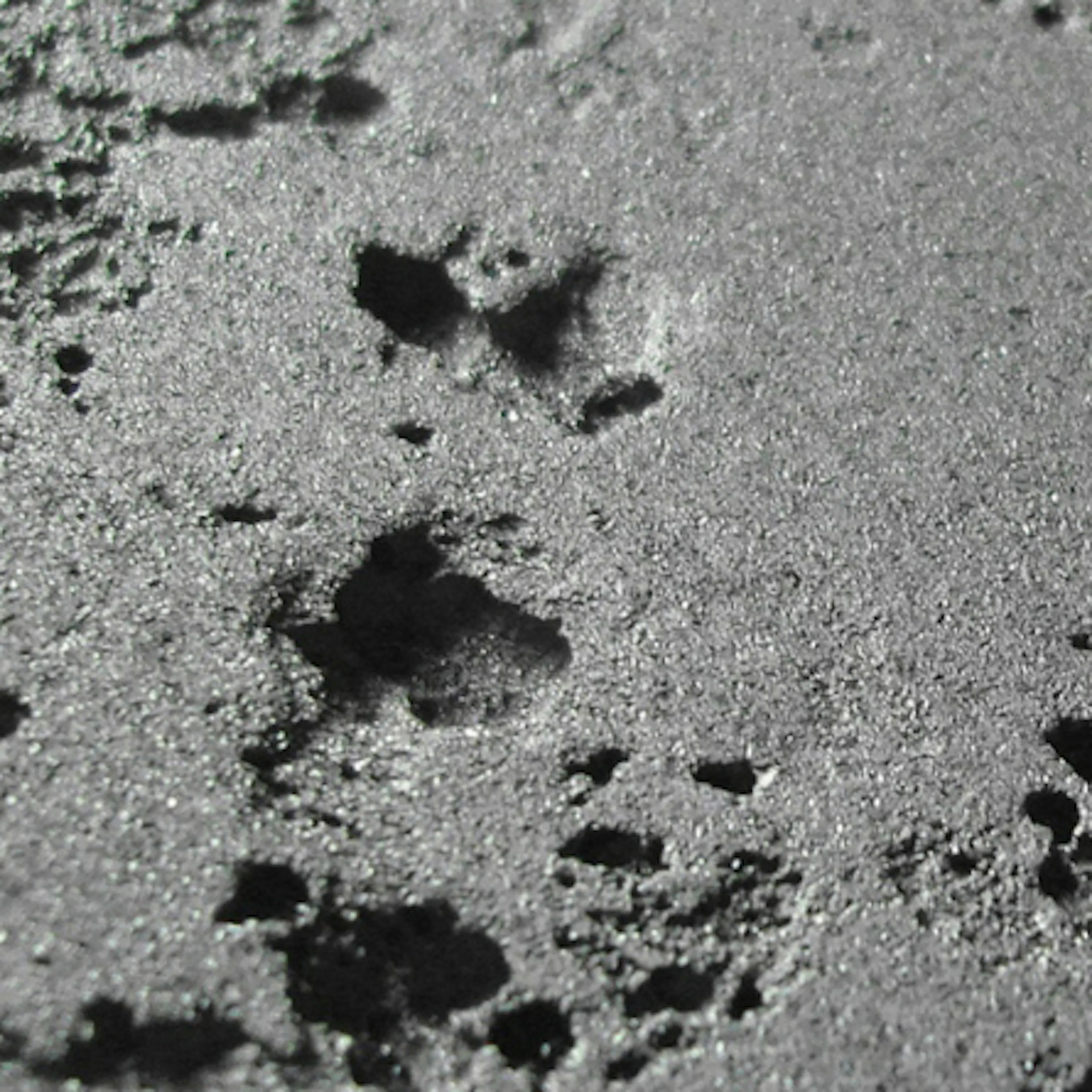

Pitting corrosion on metals
Pitting is one of the most common forms of corrosion. It is a form of localized corrosion that affects metals with small defects in otherwise passivated surfaces, including stainless steel, aluminum, and aluminum alloys. Pitting corrosion is particularly insidious because the damage may appear insignificant on the surface, but be extensive underneath the surface, where it is not visible. The hidden degradation can compromise a part’s strength and integrity. For this reason, pitting on the part is often considered to be one the most dangerous forms of corrosion. This article will briefly describe the nature of pitting corrosion, how to identify it, and four ways manufacturers can prevent pitting corrosion from occurring in machined parts.
Pitting Corrosion and How it is Caused
Corrosion is the deterioration of a metal due to electrochemical oxidation-reduction reactions that occur between the atoms at the surface of a metallic part and the atoms in the service environment. Pitting is a localized type of corrosion characterized by tiny holes or “pits” on the surface of a part. Metals that naturally form thin, protective oxide coatings - like stainless steel, aluminum alloys, and others - are the ones most susceptible to pitting corrosion.
Pits can result from poor or damaged surface finishes - whether, from direct machining, an inadequate finishing process, or damage after the part is manufactured. Some materials, like aluminum and stainless steel, naturally form oxide films on their surfaces that protect the material under the surface when the part is exposed to the environment. Under ideal conditions, this film should cover the whole part, however, part damage and foreign contaminants can prevent this film from adequately protecting the part. As a result, the vulnerable metal beneath the surface of a part is left exposed and untreated to the atmosphere. The metal beneath the surface reacts with the atmosphere - leading to corrosion. If there are several pits on a part, the damage can be far more extensive. In some cases, pits are merely an aesthetic issue. However, in structural or load-bearing parts, the loss of wall thickness and the introduction of stress concentrations can severely limit the life of a part and can pose significant safety risks.
