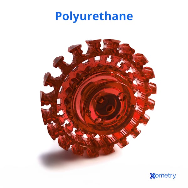

Polyurethanes are thermosetting organic polymers. They are made up of complex molecular chains that form hard and soft segments, where the soft segments give polyurethanes their flexibility, and the hard segments provide their strength. The term “polyurethane” covers thousands of different material formulations, generally categorized as either polyesters or polyethers. Figure 1 is an example of a polyurethane gear:
A photograph of a polyurethane gear
Polyurethanes can be processed using open mold casting, rotational casting, or reaction injection molding. Since they are thermosetting materials, polyurethanes are typically mixed in liquid form. A prepolymer is generally mixed with a catalyst, either at room temperature (for cold curing) or at elevated temperatures (for hot curing). Upon mixing, the polyurethane begins to cure in an exothermic (heat-releasing) reaction. Hot-cure polyurethane has better mechanical properties than cold-cure polyurethane.
Polyurethanes have excellent toughness and abrasion resistance. They can be produced in a  wide range of hardnesses from Shore 35 A all the way up to Shore 70 D. Polyurethane can only be used at temperatures up to 80°C. It will begin to chemically break down at higher temperatures. Its mechanical properties, such as hardness and abrasion resistance, also begin dropping at elevated temperatures.
