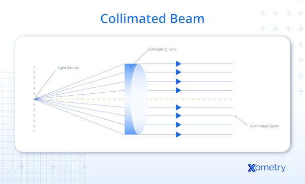

How Does Collimation Work?
Collimation works by directing light or other radiation through a lens or a set of lenses to make the rays from the source parallel to each other. When the light is collimated, the beam will remain narrow and approximately parallel over long distances. The collimation process begins with the light source, which emits light rays in various directions. These rays are directed through a collimator lens or a series of lenses, which refract and direct the light so that the rays become parallel.
An illustration showing how a collimated beam works.
How Is a Collimated Beam Produced Using a Lens?
A collimated beam can be produced using a lens by placing the light source at the focal point of a convex lens. The light rays emanating from the source are diverging, and the convex lens refracts the light rays into a parallel path. At this point, the emerging light rays form a collimated beam of parallel rays.
Another method is to use a set of lenses, typically called a collimator lens system, to create a collimated beam. The light source is placed at one end of the system, and the lenses are arranged to refract and direct the light into a parallel beam. This method is commonly used in laser diodes, telescopes, and other optical devices that require a collimated beam.
