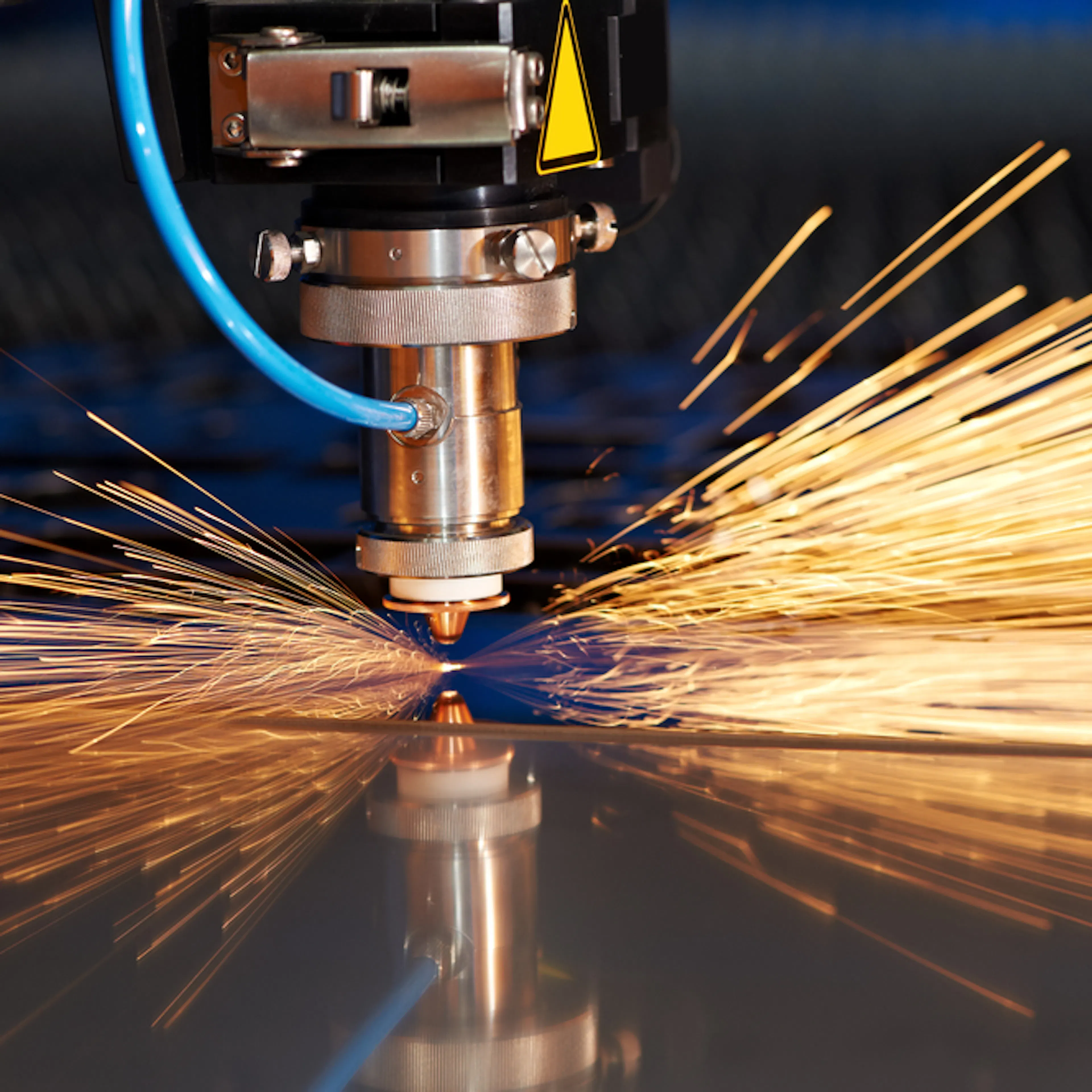

Industrial laser cutter. Image Credit: Shutterstock.com/Dmitry Kalinovsky
CO2 (carbon dioxide) lasers are the highest-power continuous wave lasers. They are widely used in both medical and industrial applications. “Laser” is an acronym for Light Amplification by the Stimulated Emission of Radiation. A CO2 laser works by exciting CO2 molecules to generate a coherent beam of light at a specific frequency, typically between 9,300 and 10,600 nm. The CO2 laser was invented in 1964 at Bell Laboratories by Kumar Patel. In the medical industry, the CO2 laser is predominantly used for skin treatment using a process called carbon dioxide laser resurfacing. The CO2 laser is also very popular in industrial applications for cutting and welding a wide range of materials from steel to fabric.

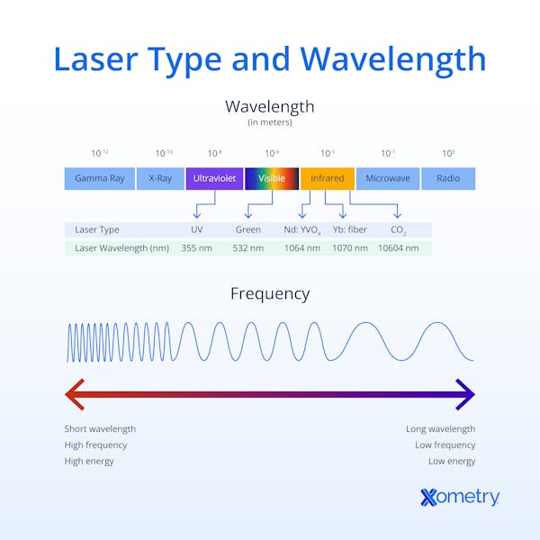

What Is the Spectrum of a CO2 Laser?
A CO2 laser has its spectrum within the mid-infrared range between 9,000-11,000 nm with the most common wavelengths being 9,600 nm and 10,600 nm.
Laser types and wavelength
CO2 lasers are able to have multiple wavelengths due to the fact that the CO2 is a triatomic molecule. A triatomic molecule means there are more potential energy levels to make use of.
What Are the Alternate Wavelengths for a CO2 Laser?
A CO2 laser can have a wavelength that can vary between 9,000-11,000 nm with the most common alternative wavelength being 9,300 nm. CO2 lasers cannot have real-time continuous wavelength changes as each discrete wavelength requires a specific tuning element within the gain medium to achieve a specific wavelength.
