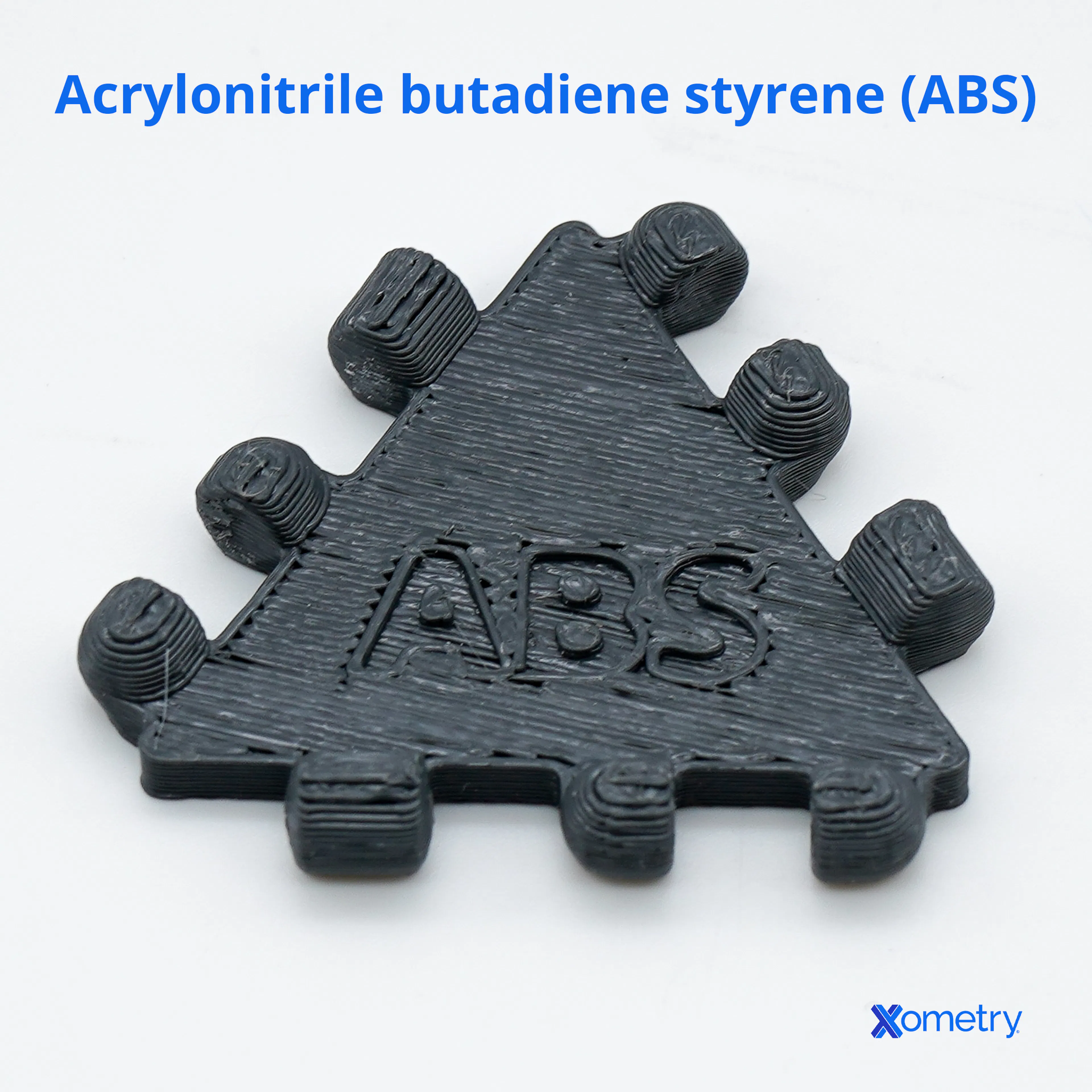

1. ABS
ABS (acrylonitrile butadiene styrene) does not volatilize under laser cutting but tends to melt and burn. Cut edges are melted and fused. ABS thermal/oxidative decay products contain a wide range of toxins, including: cyanide, 𝜷 methyl styrene, phenol, phenyl cyclohexane, and benzene derivatives. ABS is also generally considered to be a fire risk because the lack of removal of material by char/volatility leads to considerable local heating and ignition.
ABS part printed by Xometry
ABS isn't great for laser cutting, but it's good for 3D printing
