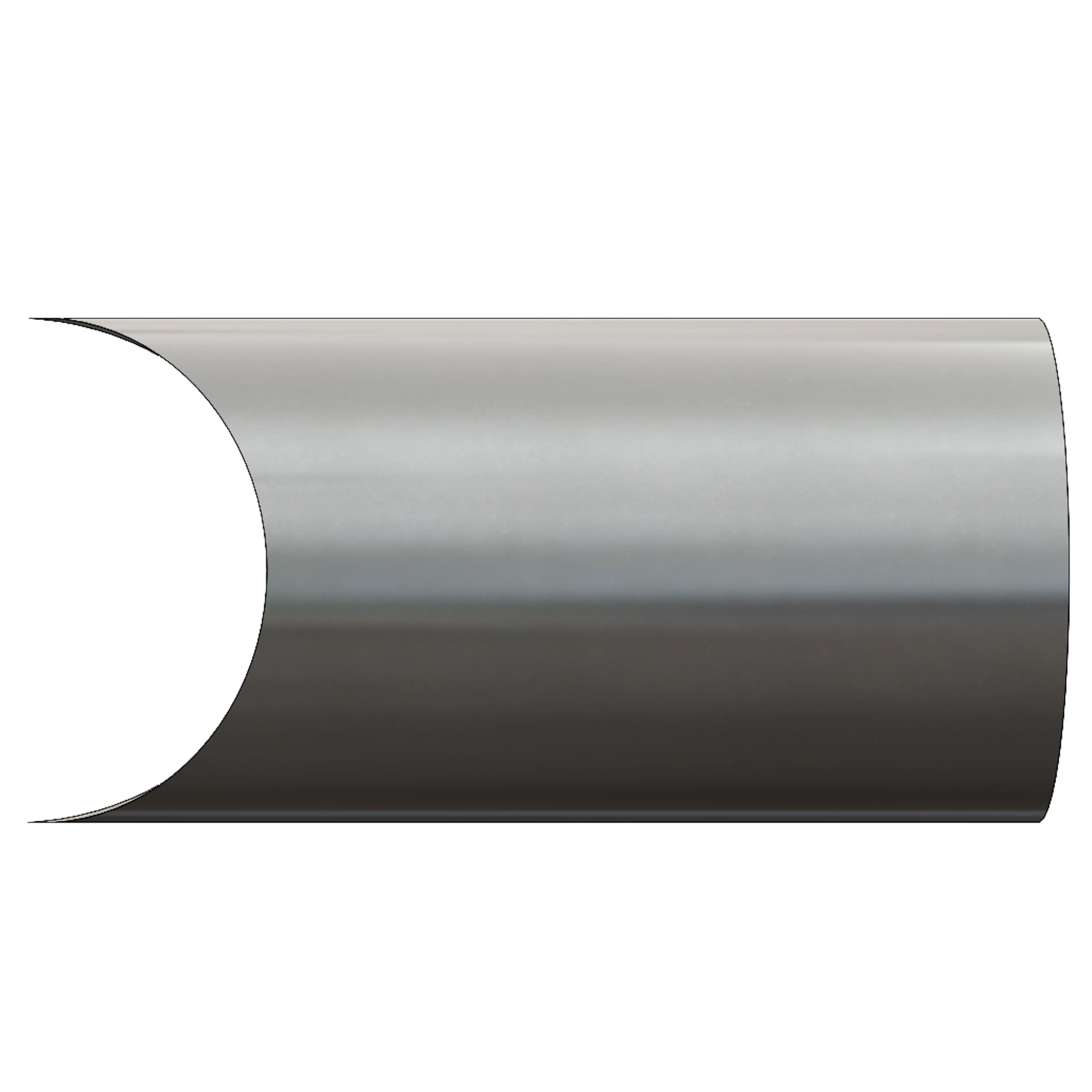

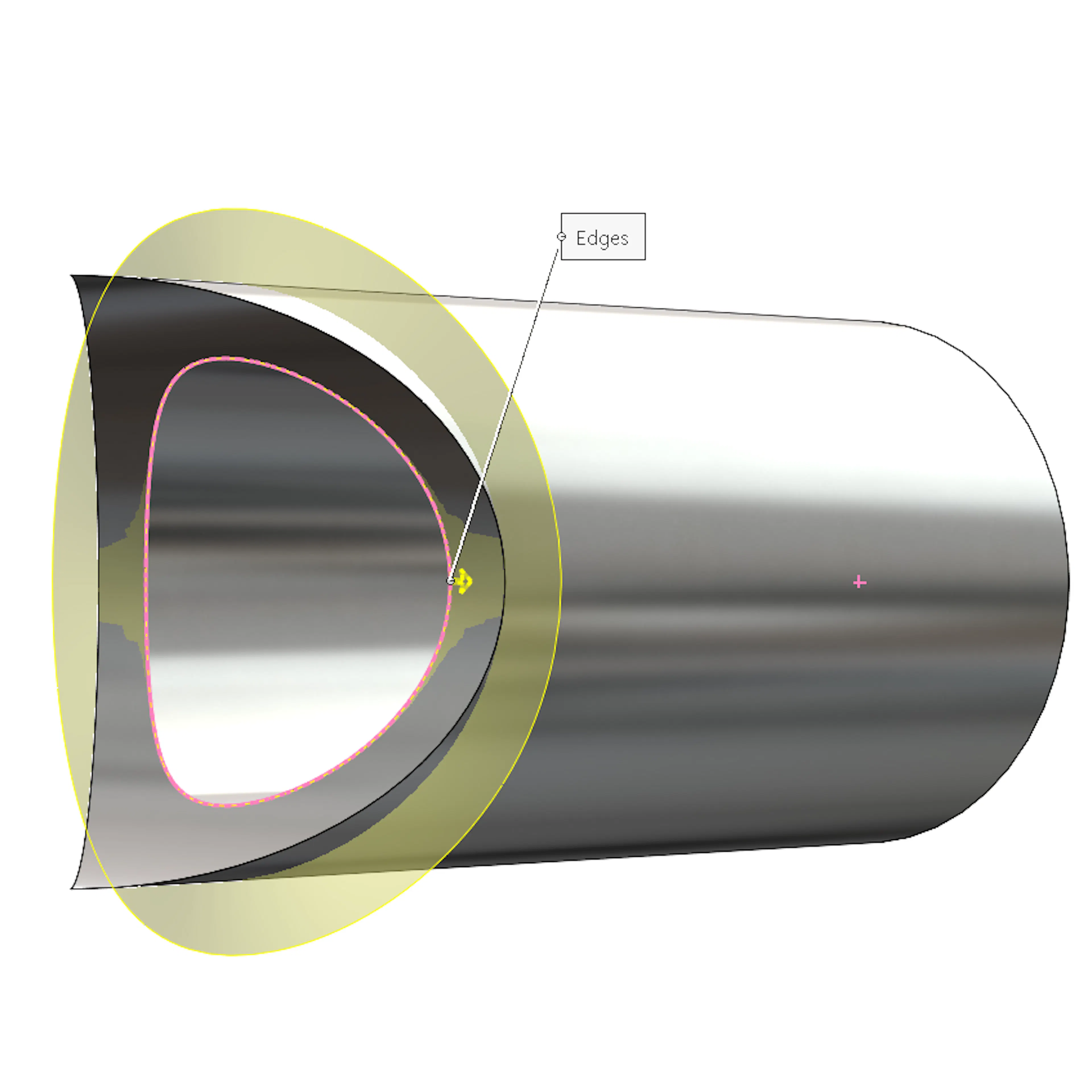

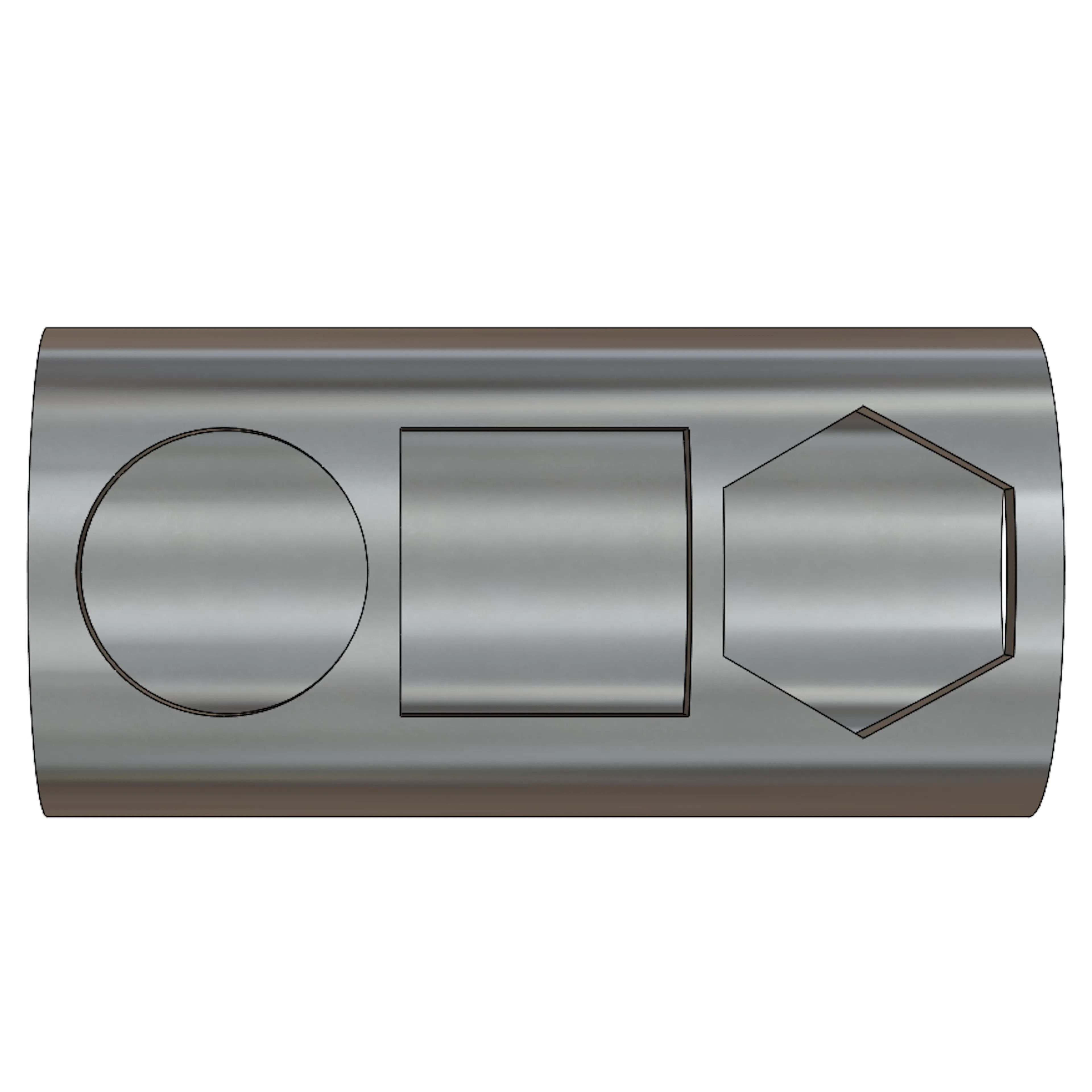

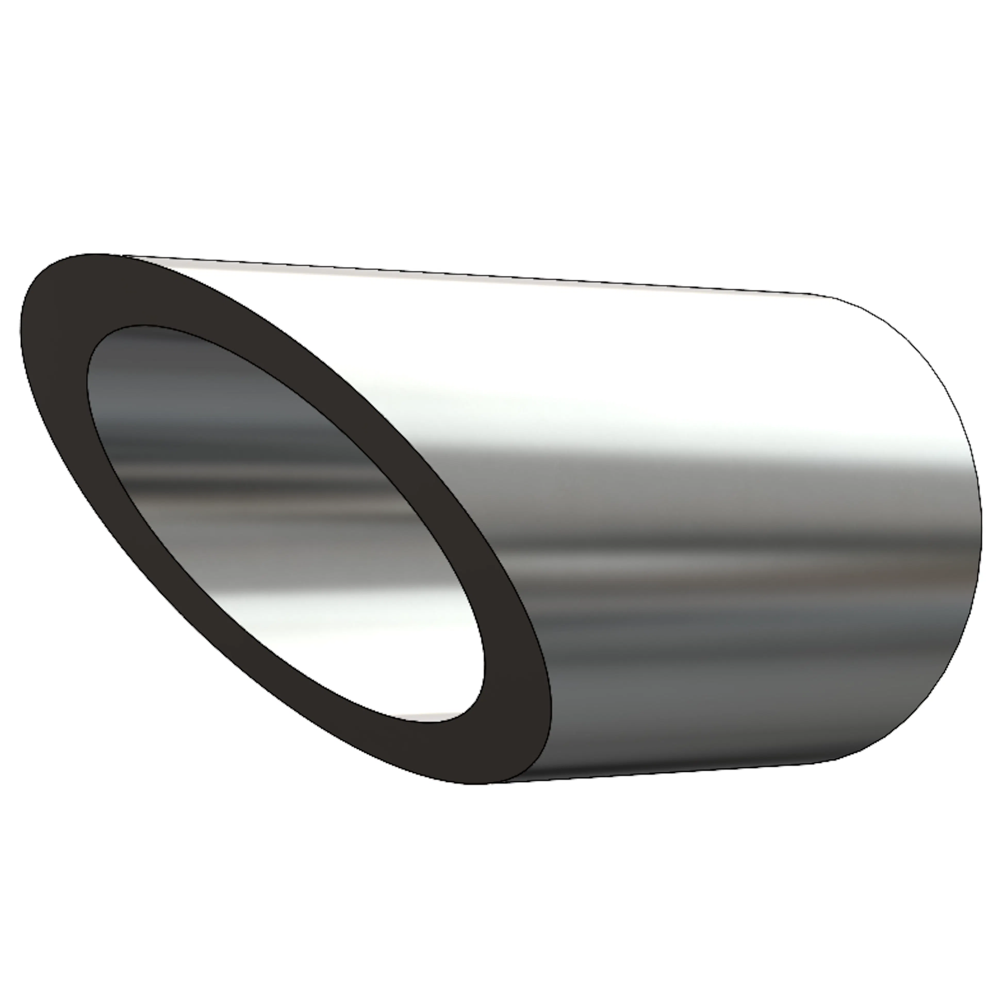

Though often unassuming, laser tube cutting projects can be quite complex with many cuts, such as miters and copes. Cuts are often modeled normal to the edge using standard extrude and cut features in CAD. However, the actual cut path for laser tube cutting is 90 degrees, or normal to the surface of the tube. This article helps you understand what a normal-to-surface cut is and what to expect when ordering laser tube cutting services.
Normal-to-Surface Cuts

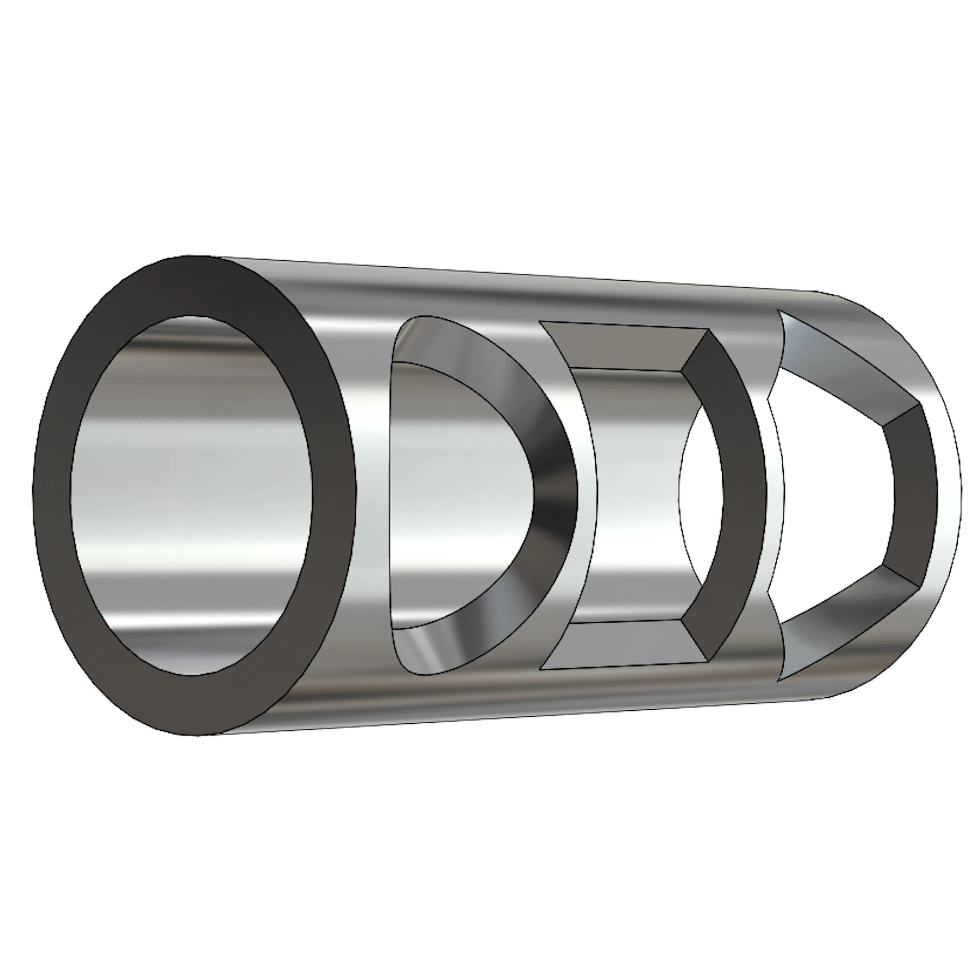

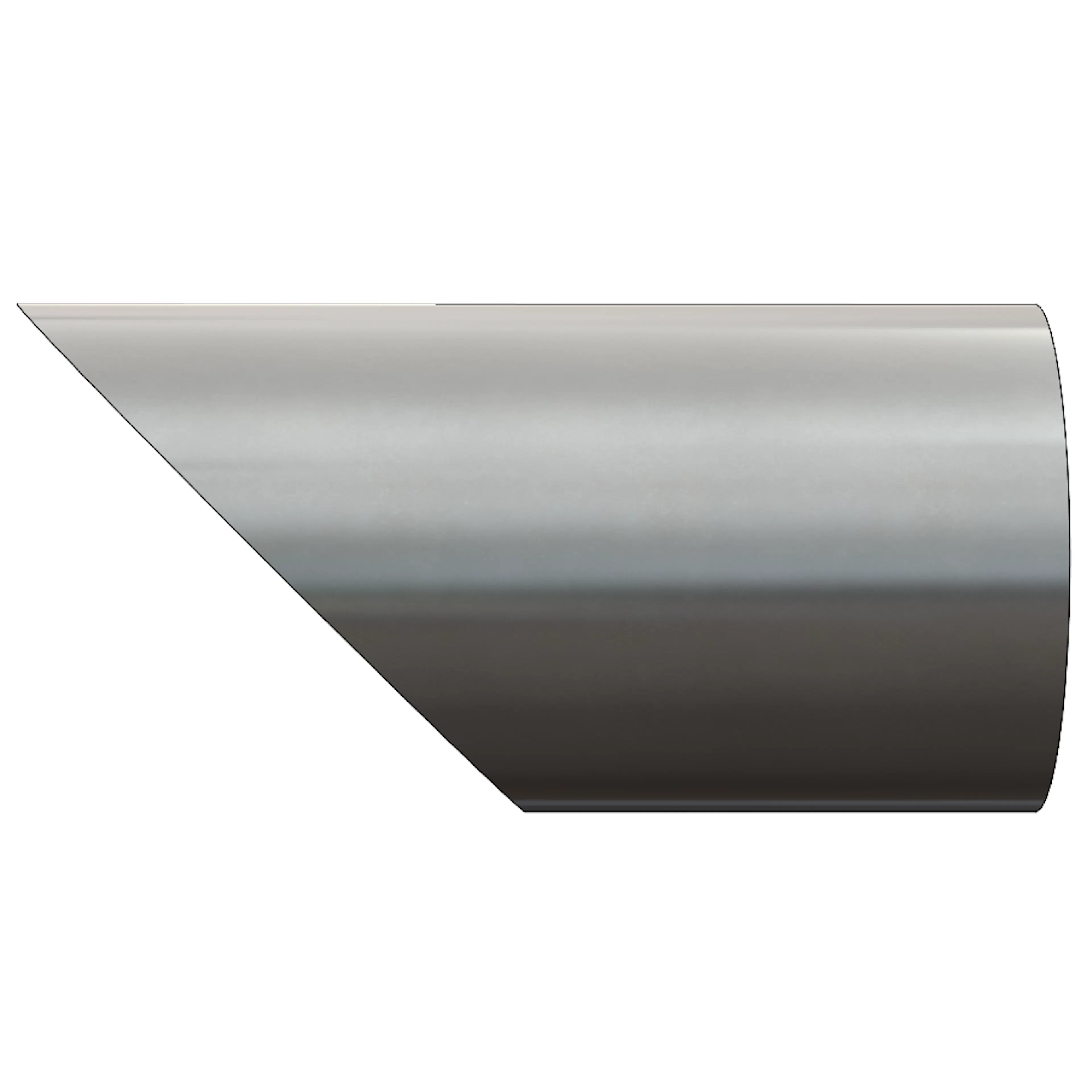

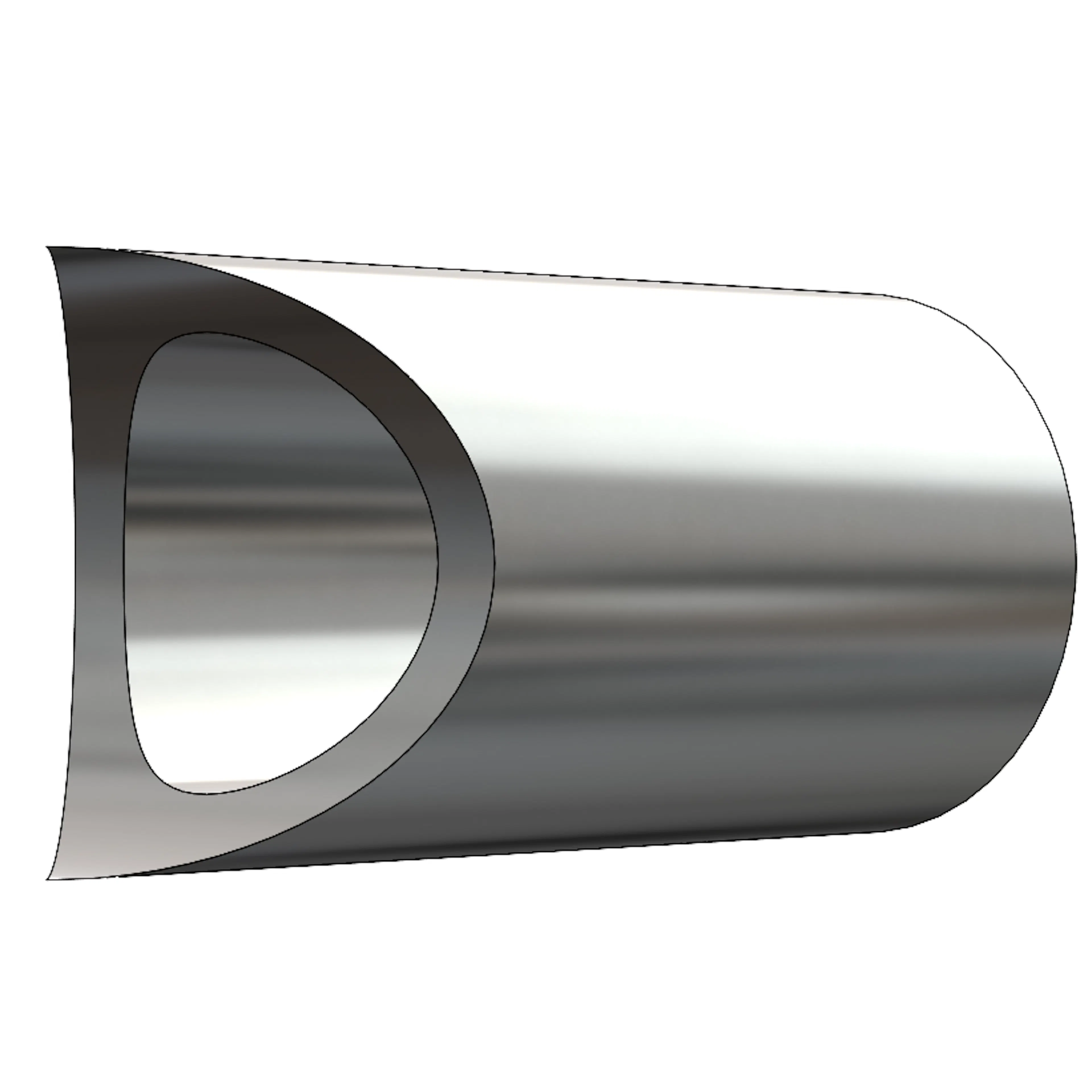

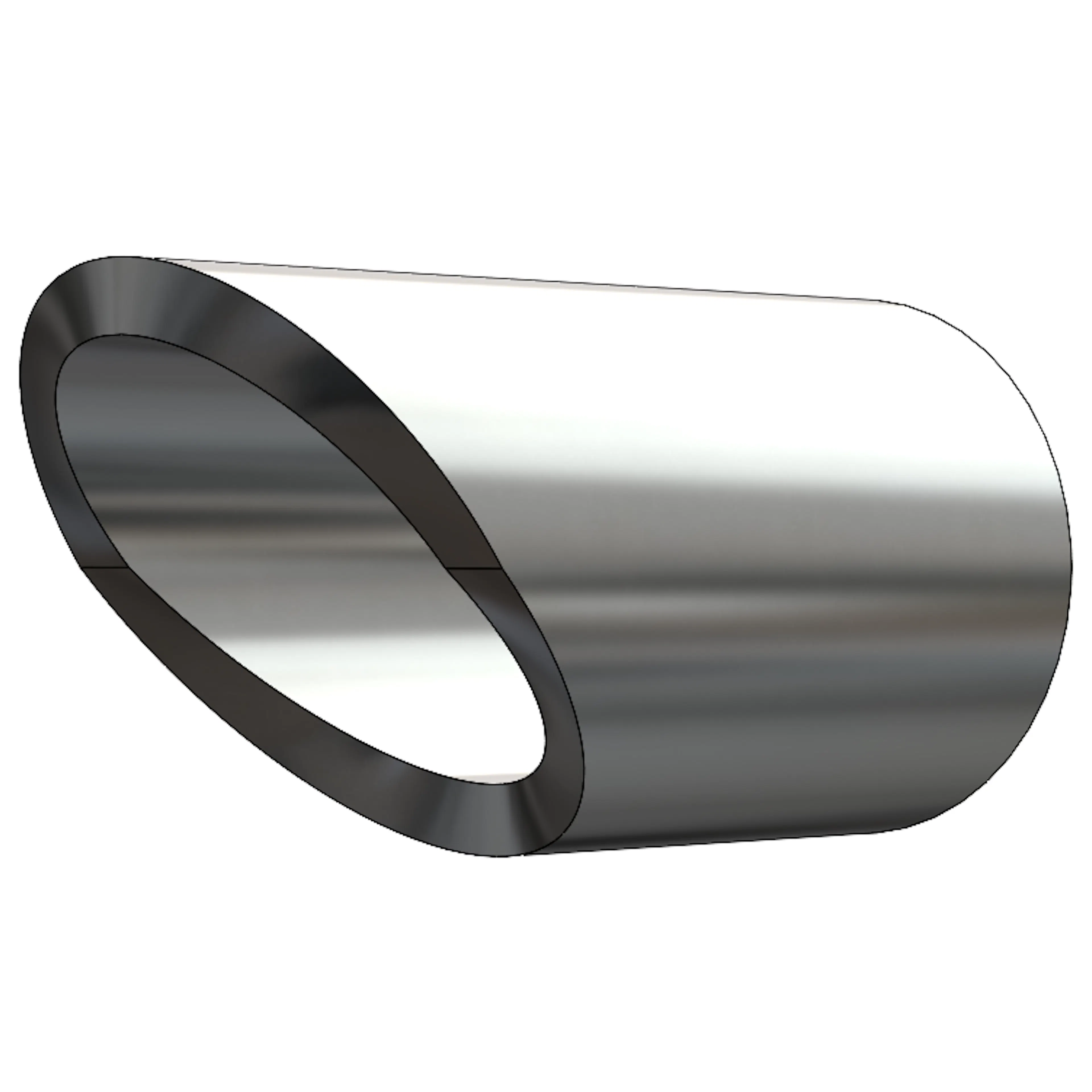

A normal-to-surface cut is perpendicular to the outside surface of the tube. Normal-to-surface cuts have many aliases, including normalized cut, 90-degree cut, or true cope. Whatever their name, normal-to-surface cuts are the industry standard for laser tube cutting.

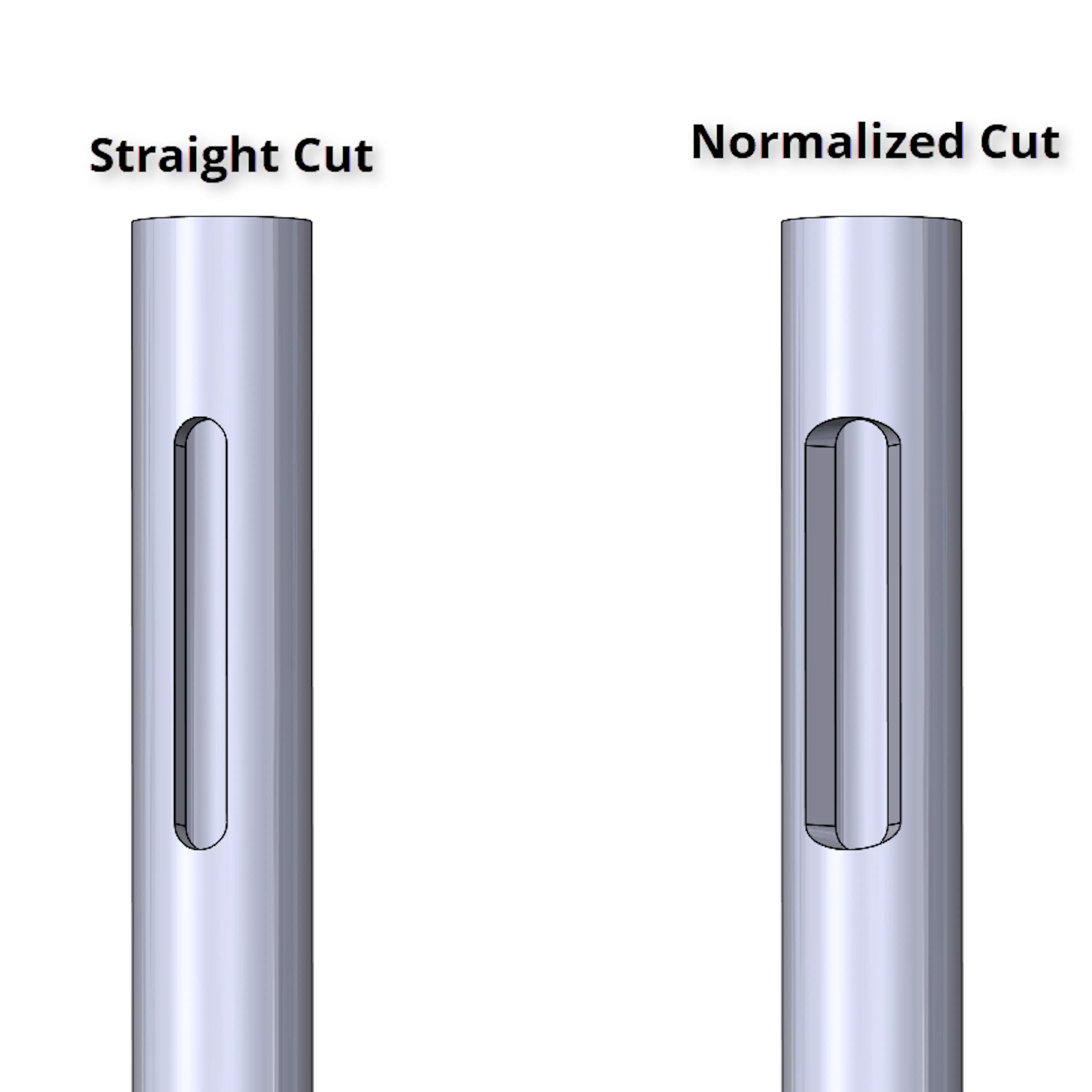

Normal to surface tube cut

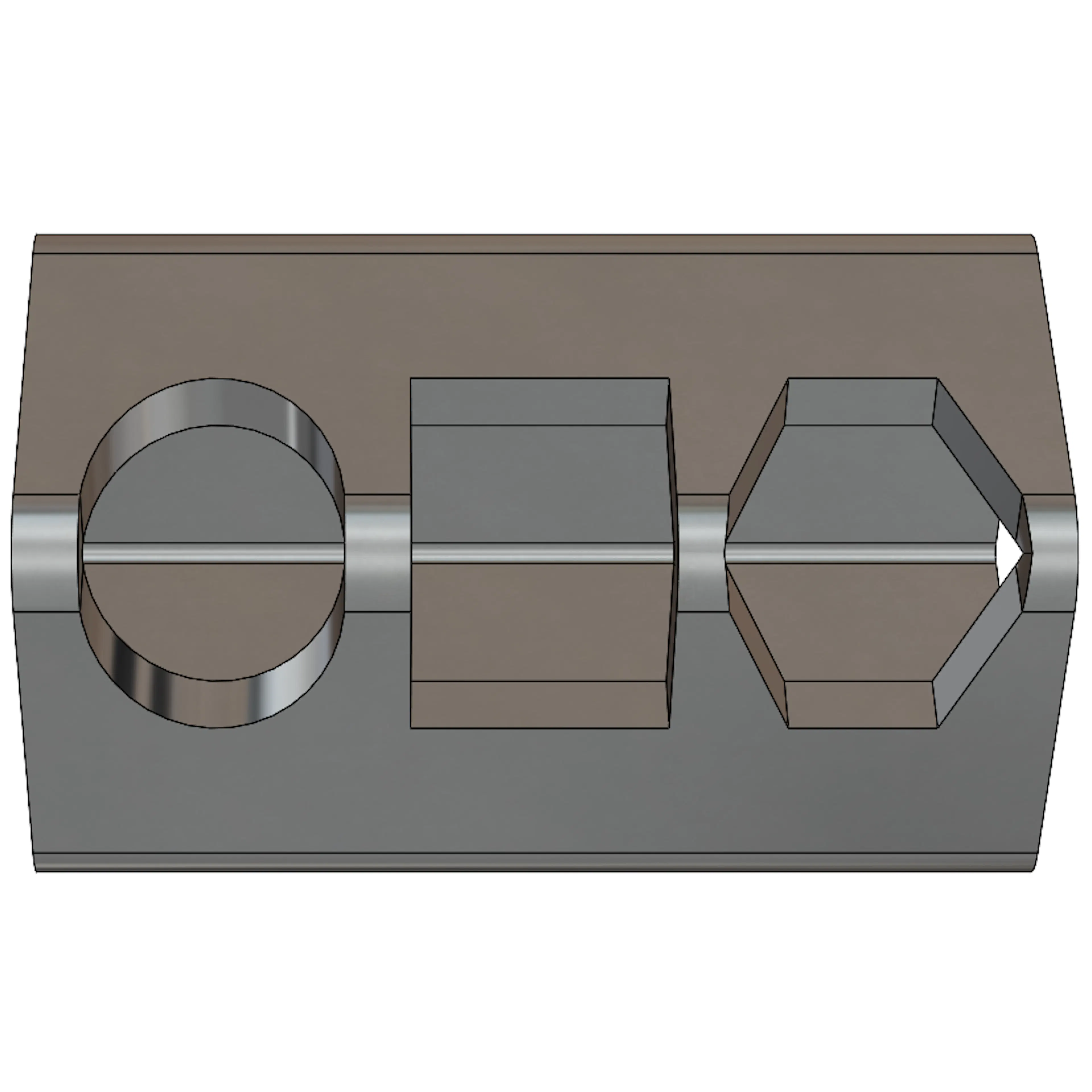

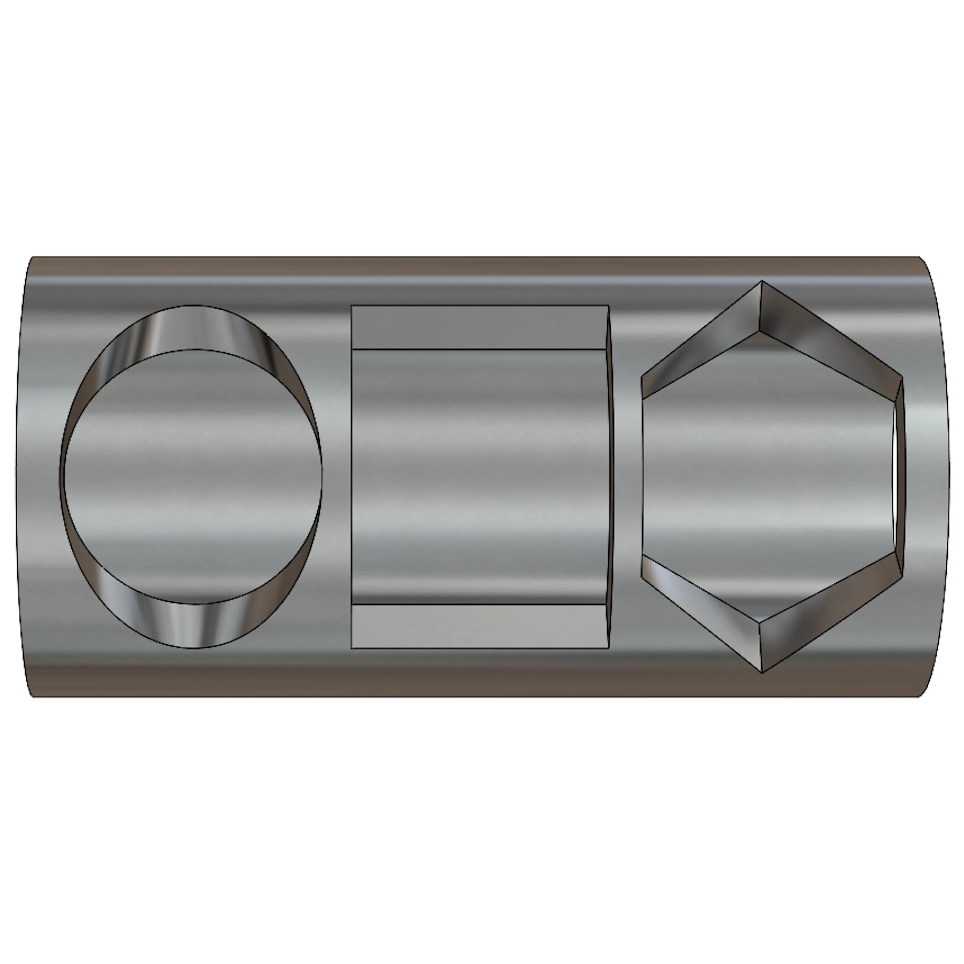

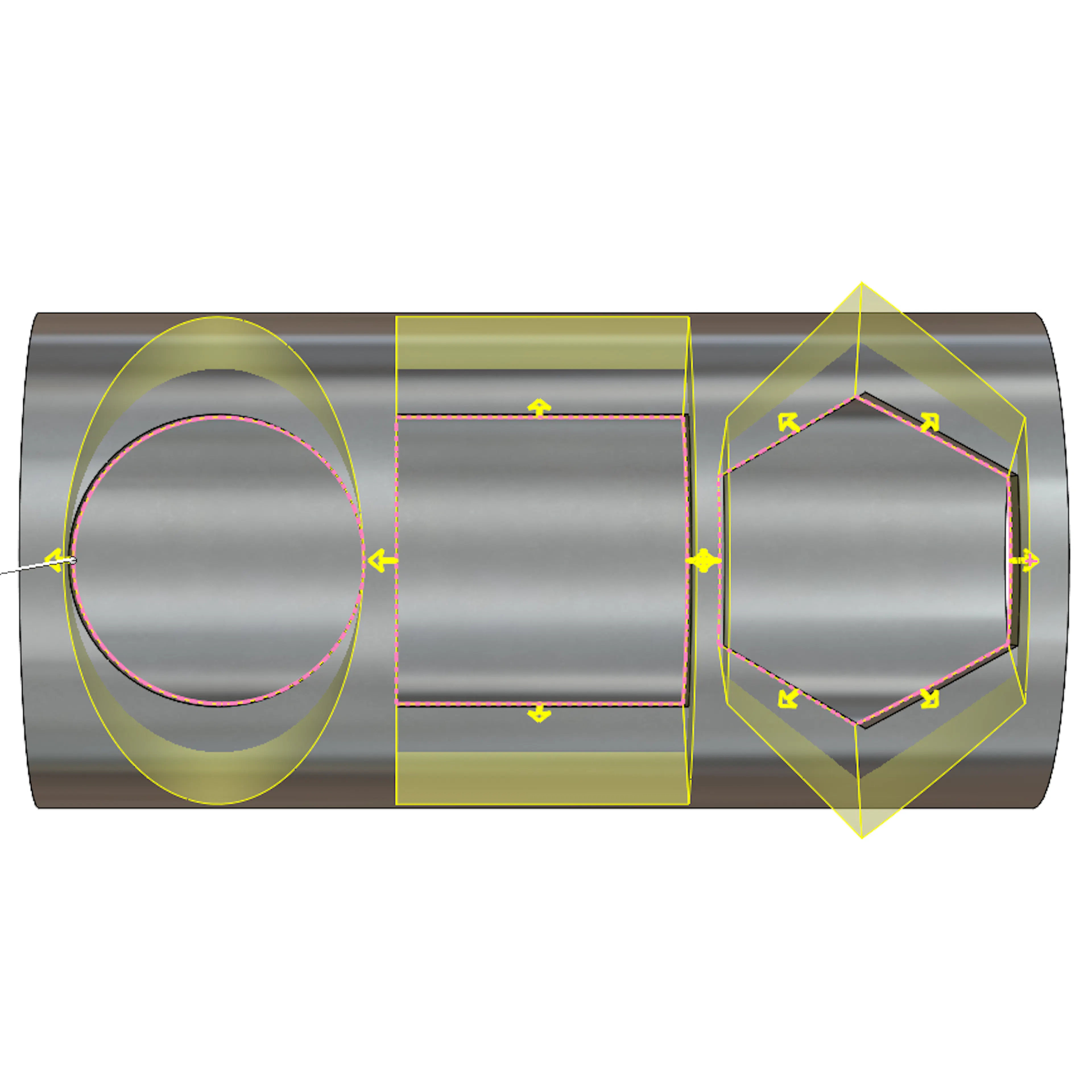

Quoted laser tube cutting projects will always assume the cuts in your model are normal to the surface. Normal-to-surface cuts can decrease lead times and price. This is because normalized cuts allow the laser head to remain at a 90-degree angle to the tube surface at all times during manufacturing, giving a consistent cut thickness on the tube regardless of the feature.
Normal-to-Edge and Other Cuts
While possible, performing normal-to-edge cuts would require a manual review for quoting and increase lead time and price. This is because the laser must have an additional axis to tilt and cut the tube at an angle, increasing the time to cut features on the tube. Other types of cuts, like post-machined cuts, would also require a manual review. Maintaining a 90-degree angle standard reduces cutting difficulty and excessive heat build-up caused by making sharp cuts in thick-walled tubing.
Differences Between CAD and a Normal Cut Surface

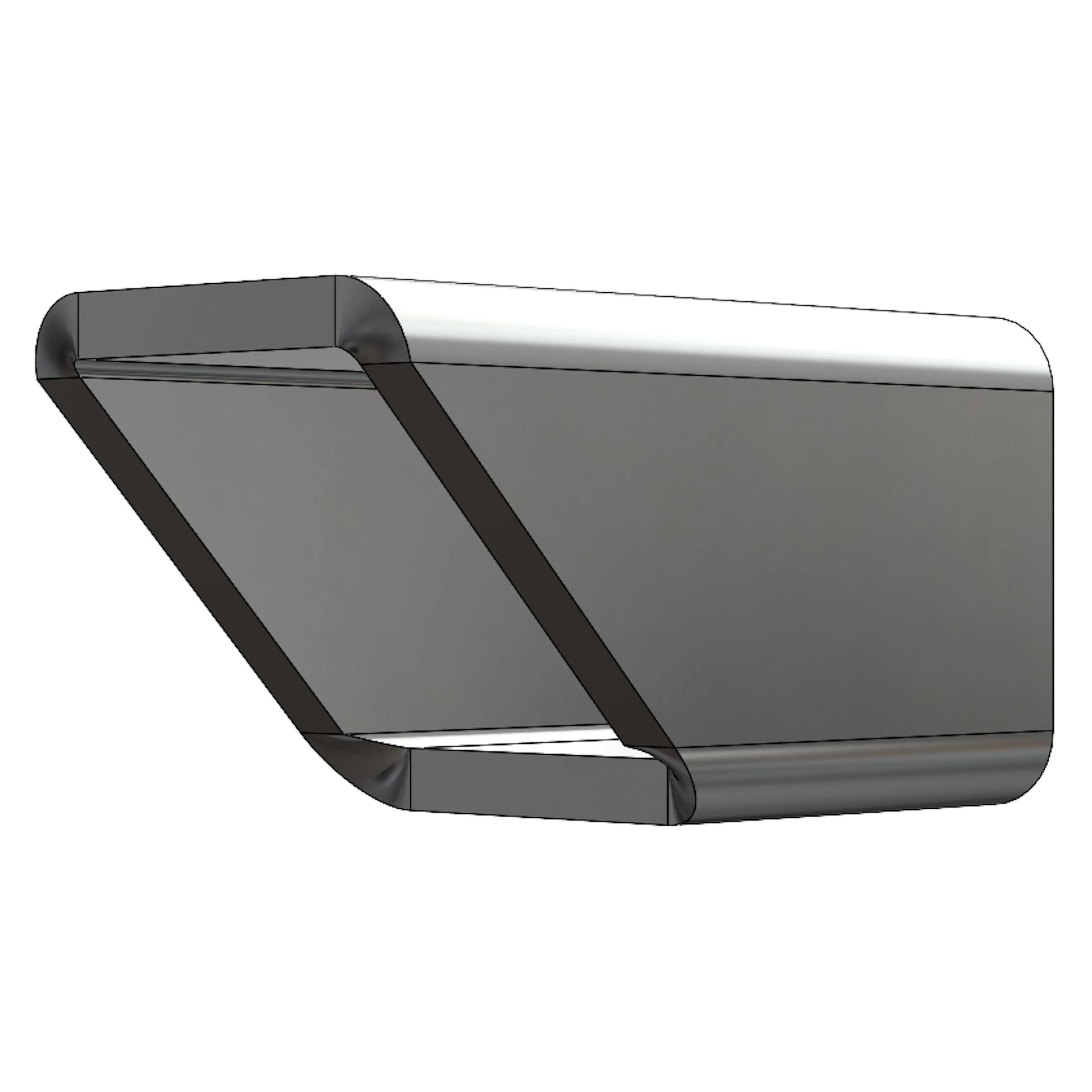

It's important to make sure your CAD models resemble your end part. CAD software, such as SolidWorks, likely won’t assume normal to surface cuts. Many SolidWorks weldment tools and other tube modeling workflows do not normalize surfaces automatically. It takes a few extra commands to normalize your tube cuts, but this practice can reduce manufacturing issues and confusion.

Pro Tip: Wonder if a cut is normal to surface? Rotate your model and imagine if a laser could make every cut perpendicular to the surface of the tube. If not, that surface may look different when fabricated.

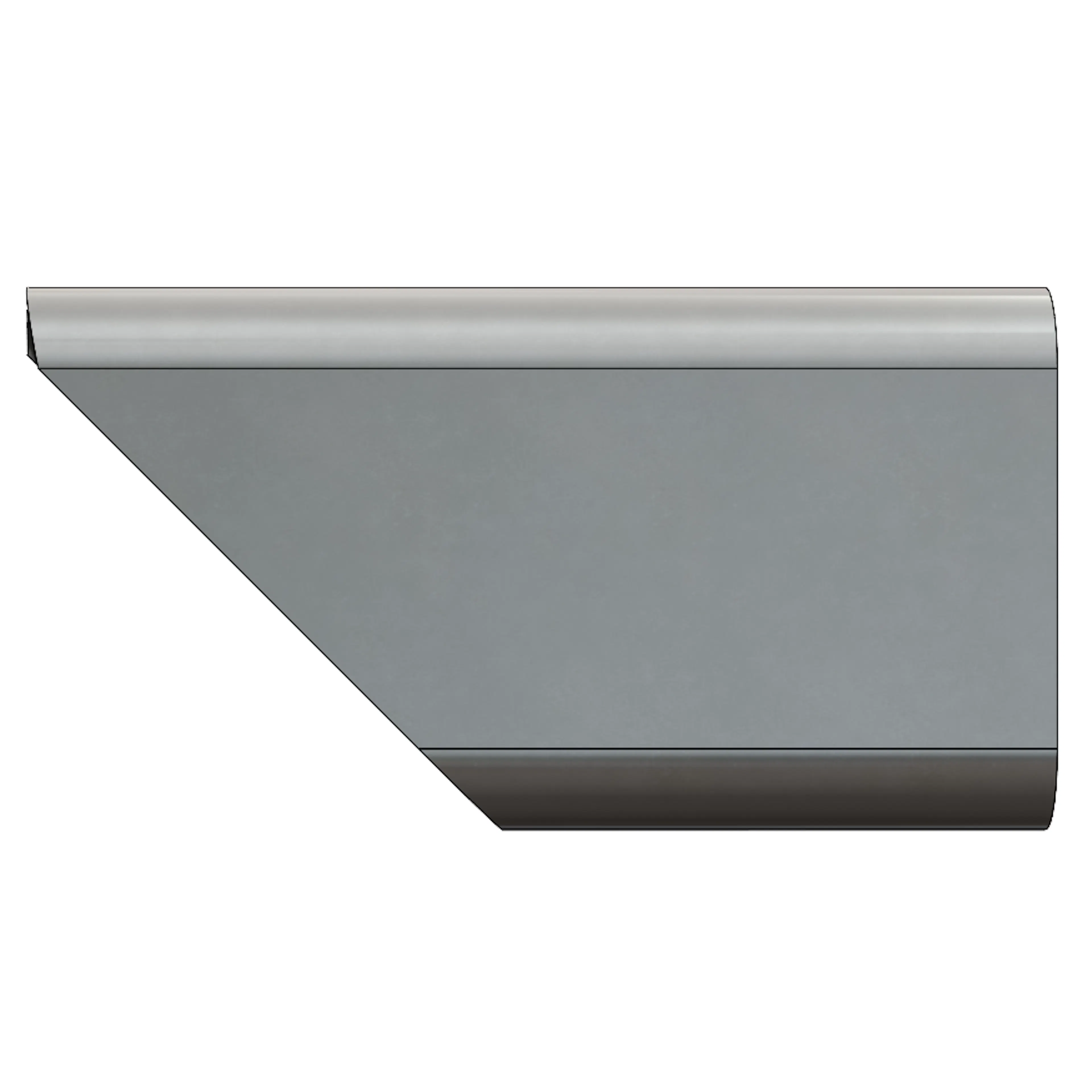

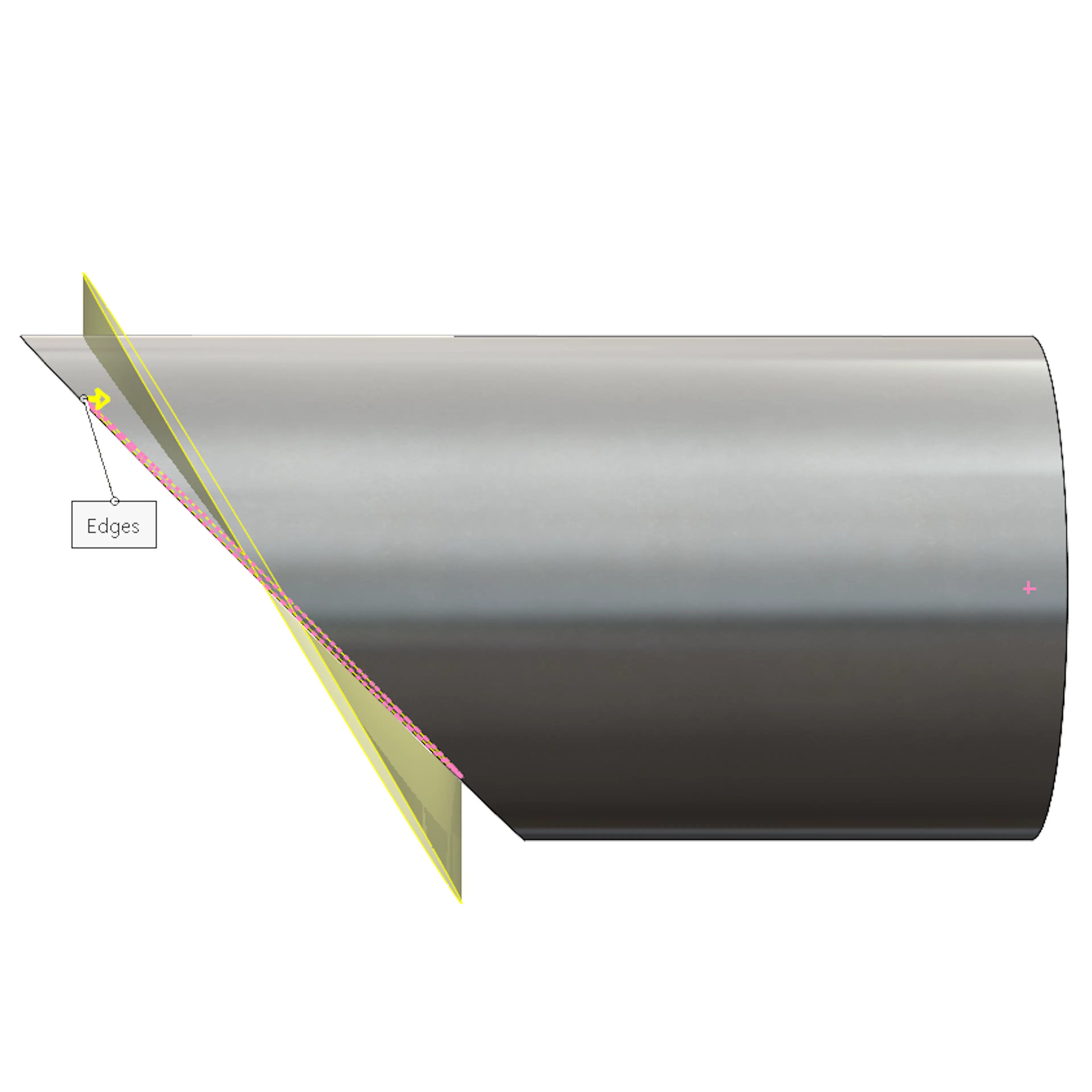

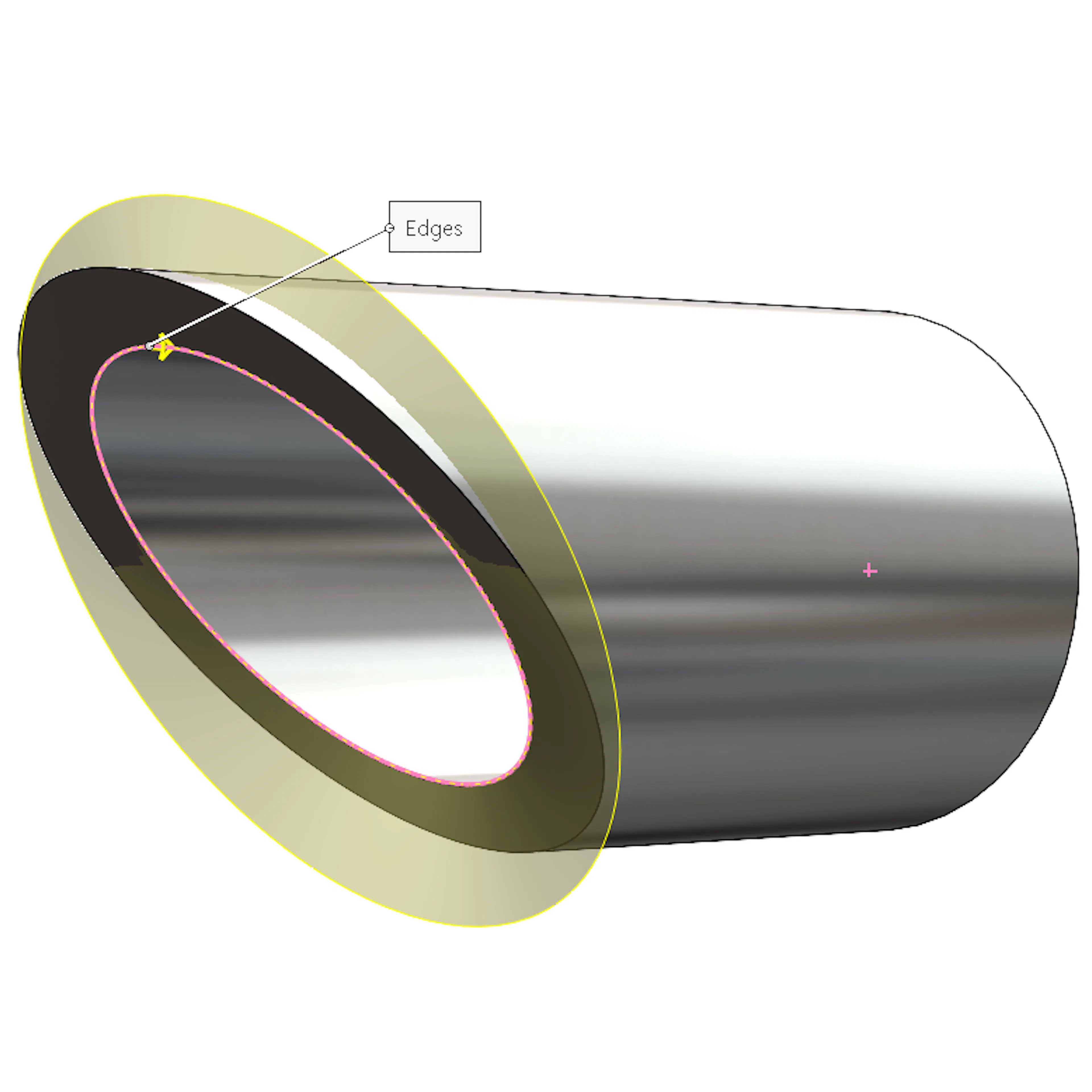

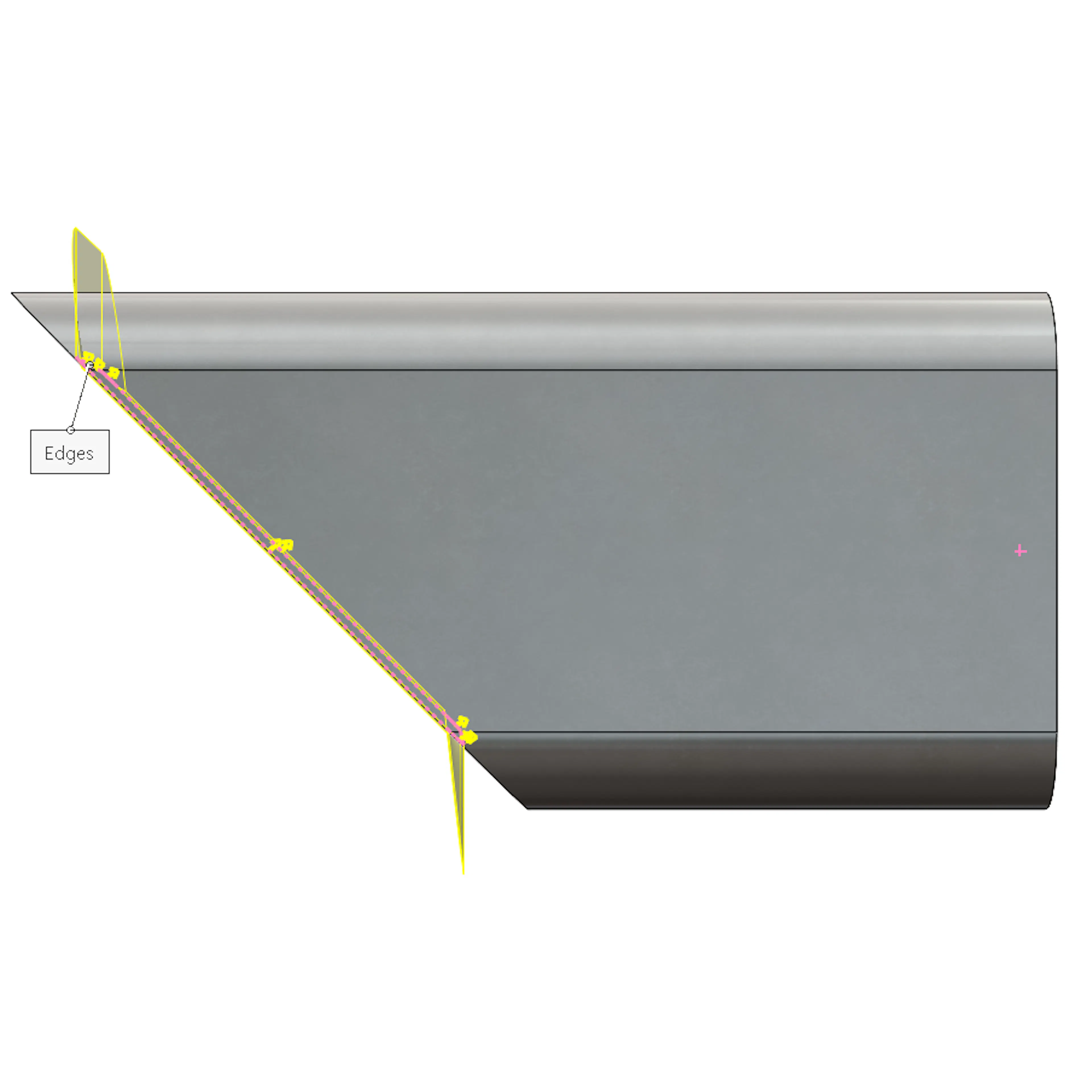

A mitered round tube in SolidWorks.Normal to Edge Miter

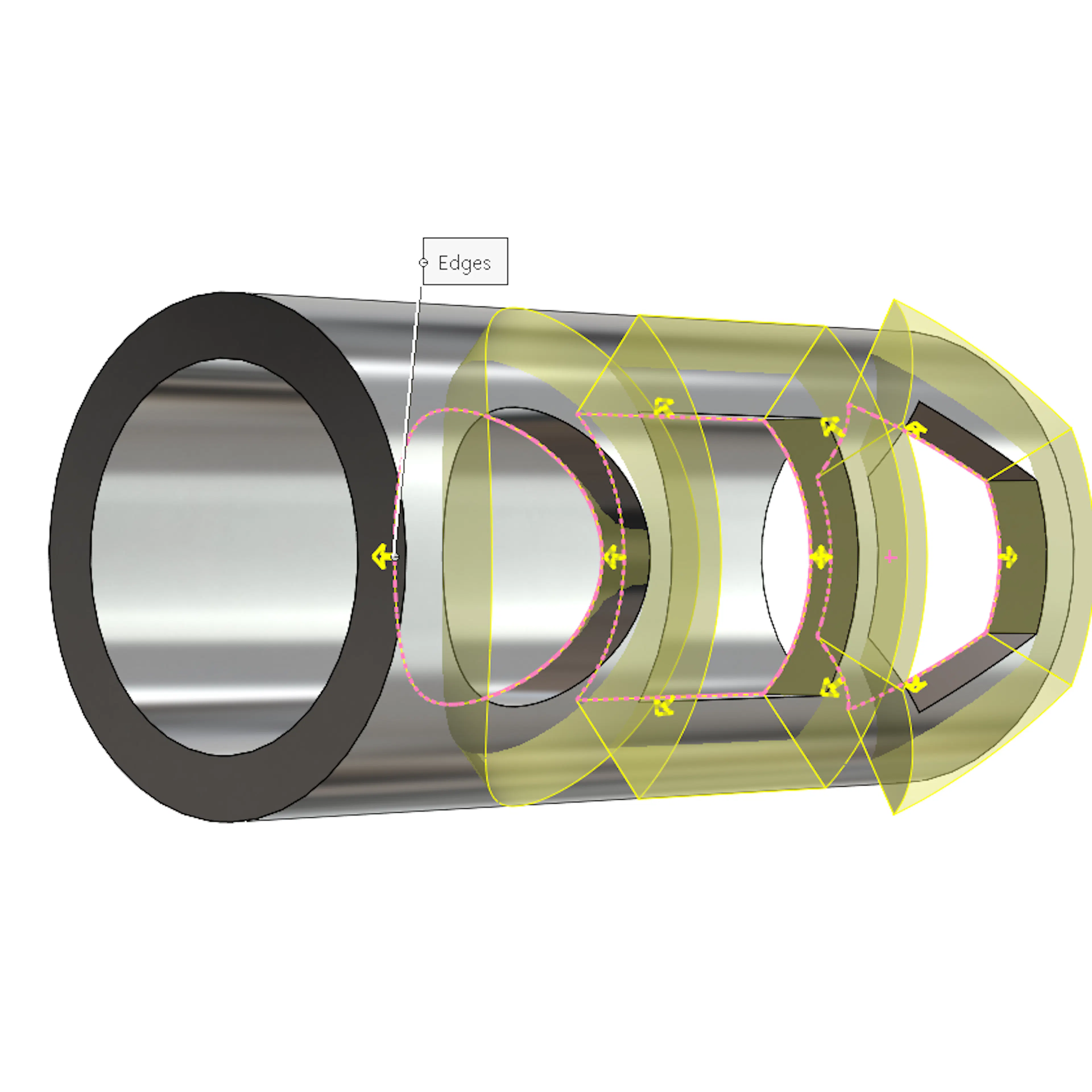

The ruled surface command in SolidWorks on a mitered round tube.Laser Path Reference

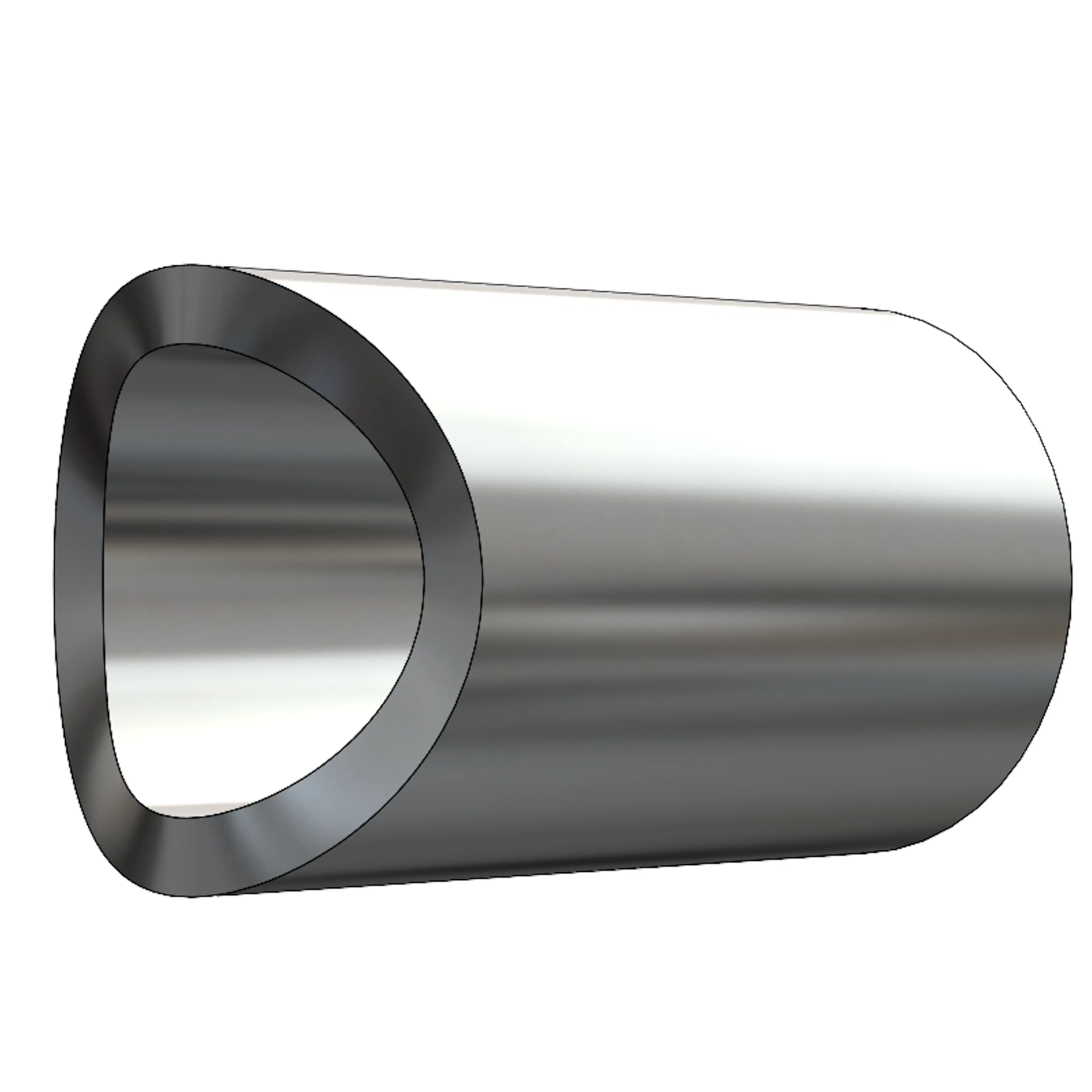

A normalized mitered cut on a round tube in SolidWorks.Normal to Surface Miter

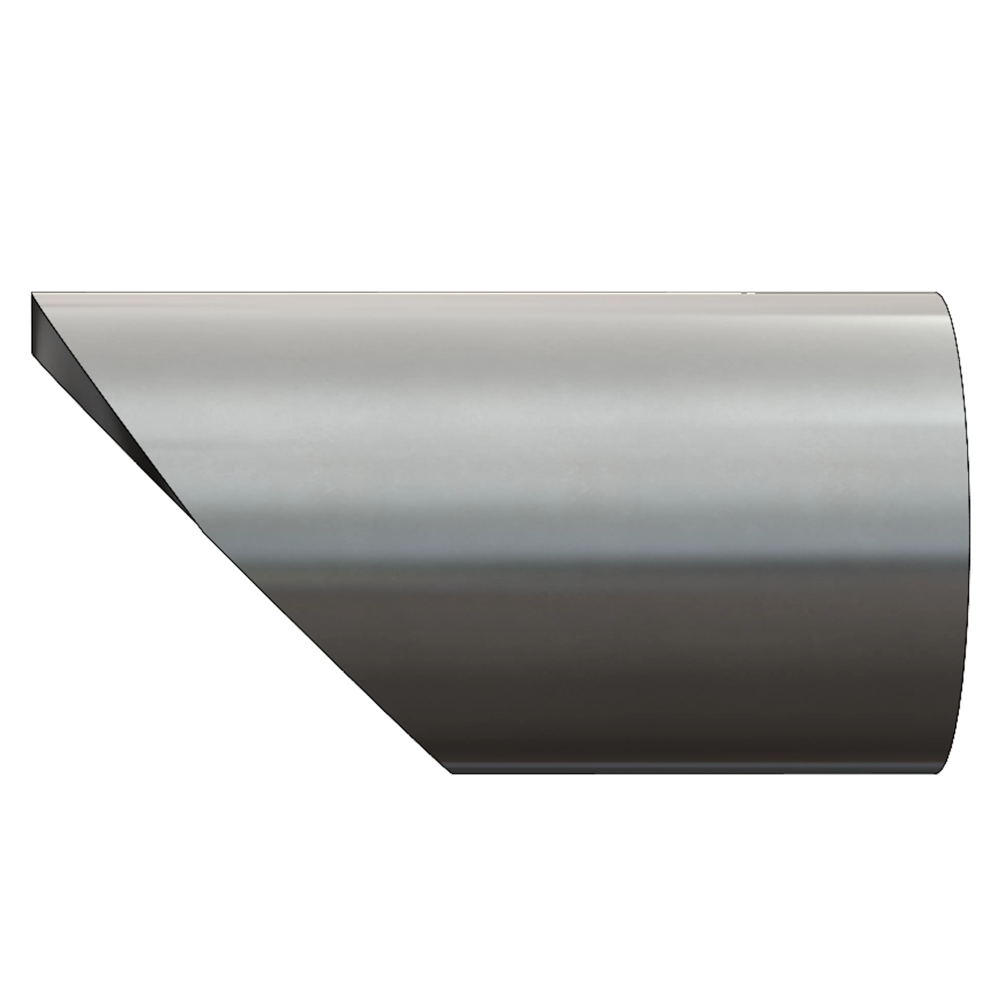

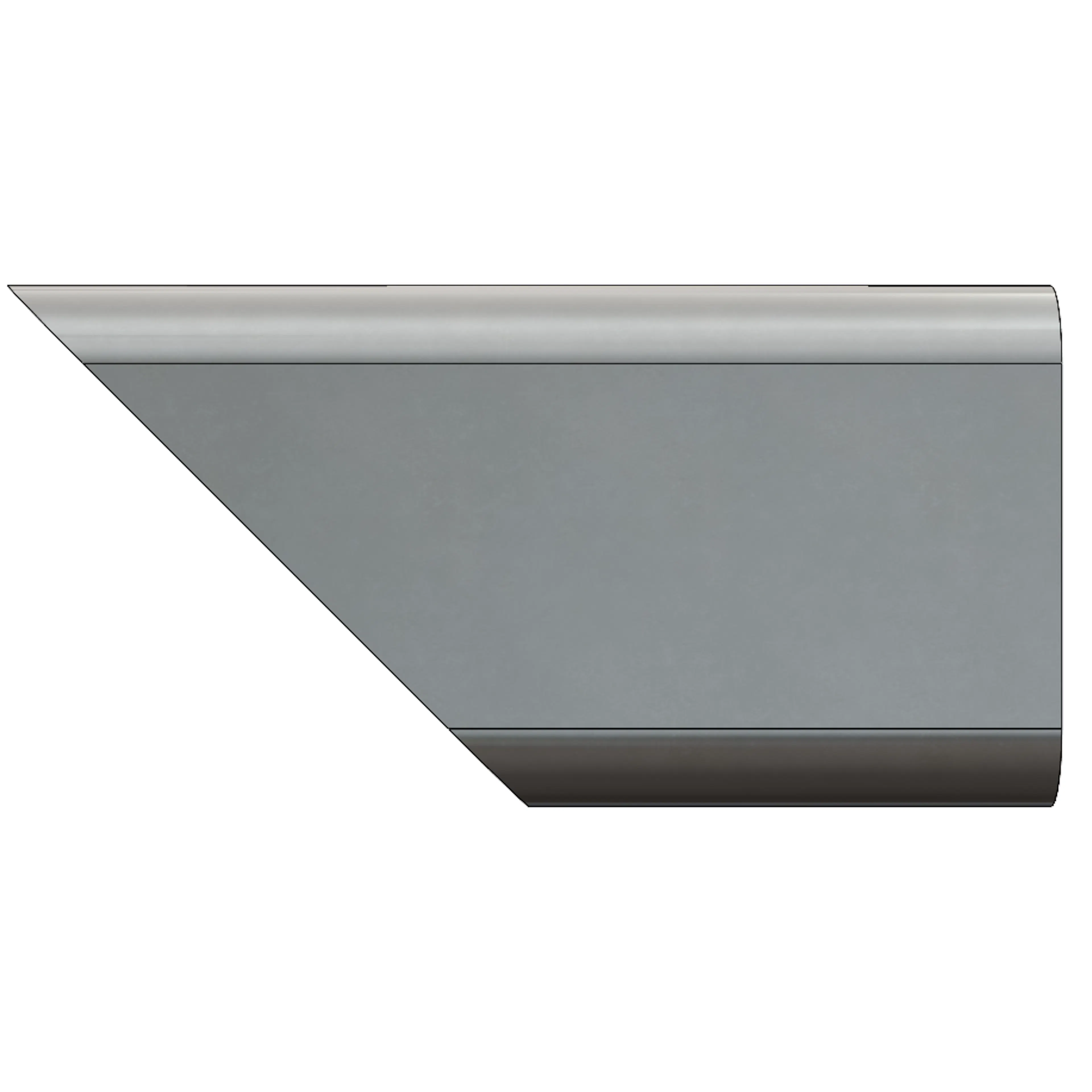

A side view of a miter cut on round tube in SolidWorks.Normal to Edge Miter

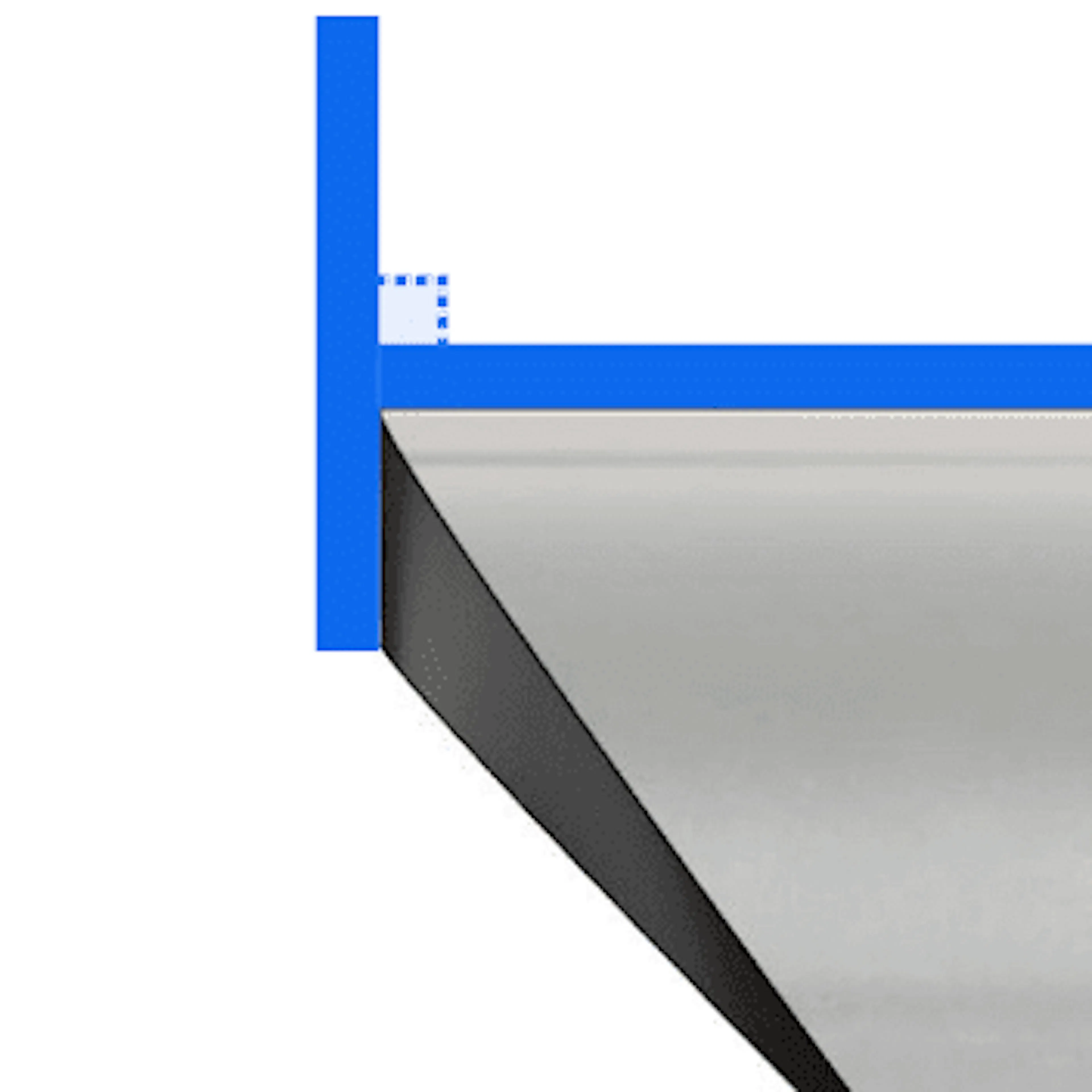

A side view of the ruled surface tool in SolidWorks on a mitered round tube.Laser Path Reference
A side view of a normalized miter cut on round tube in SolidWorks.Normal to Surface Miter

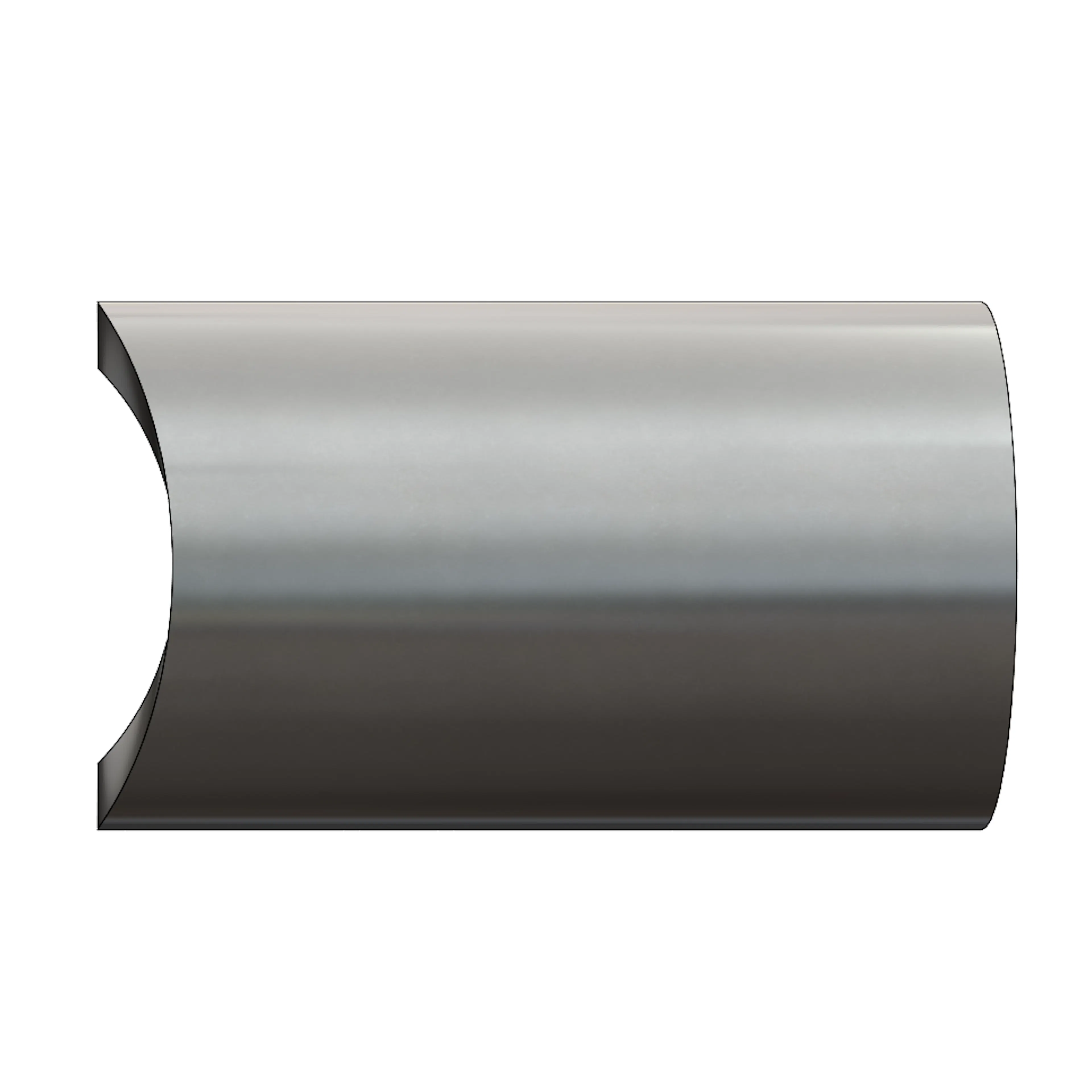

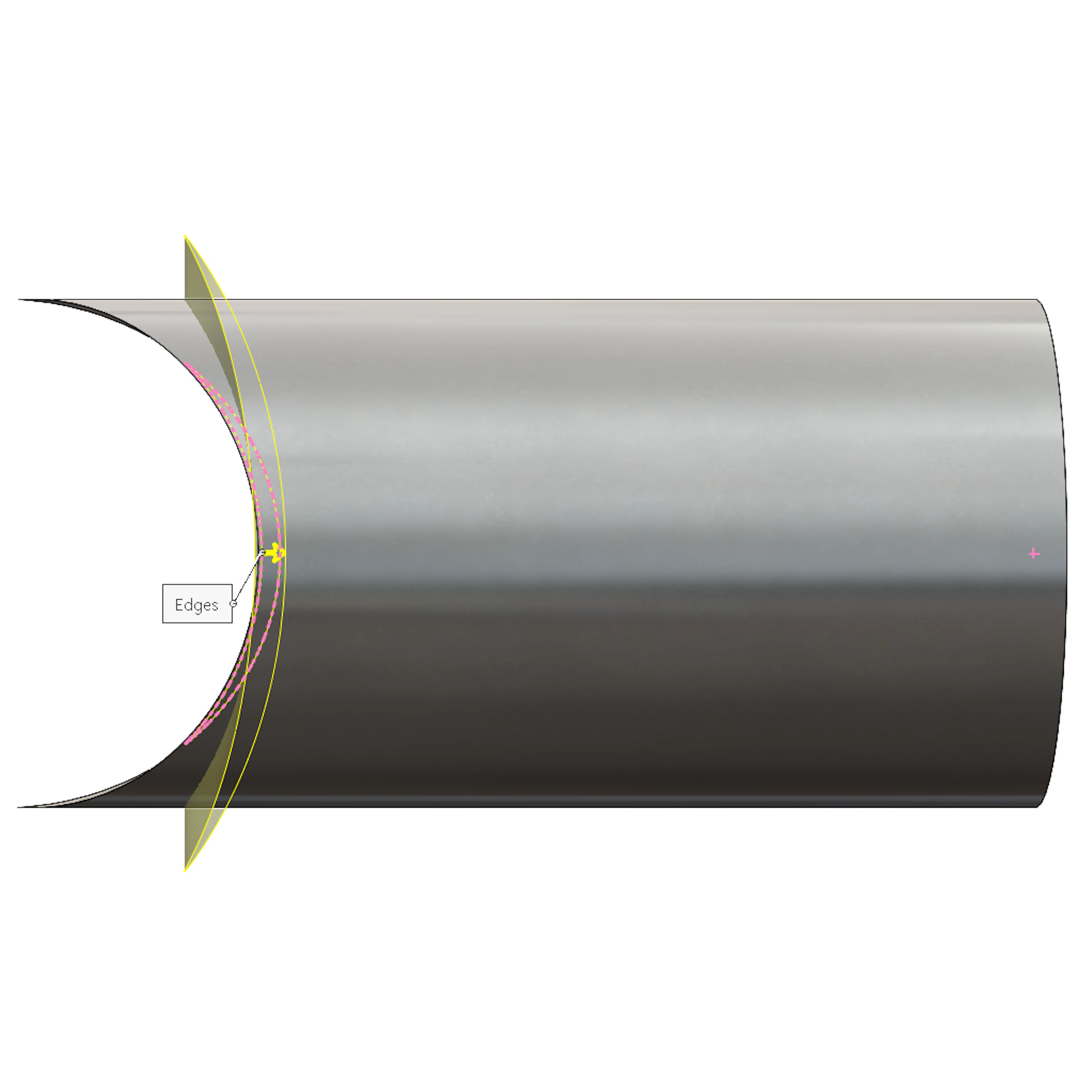

A coped round tube in SolidWorks.Normal to Edge Notch
The ruled surface command in SolidWorks on a coped round tube.Laser Path Reference for Notch
A normalized cope on round tube in SolidWorks.Normal to Surface Notched Cope
A side view of cope cut on round tube in SolidWorks.Normal to Edge Cope
A side view of the ruled surface tool in SolidWorks on a coped round tube.Laser Path Reference
A side view of a normalized cope cut on round tube in SolidWorks.Normal to Surface Cope

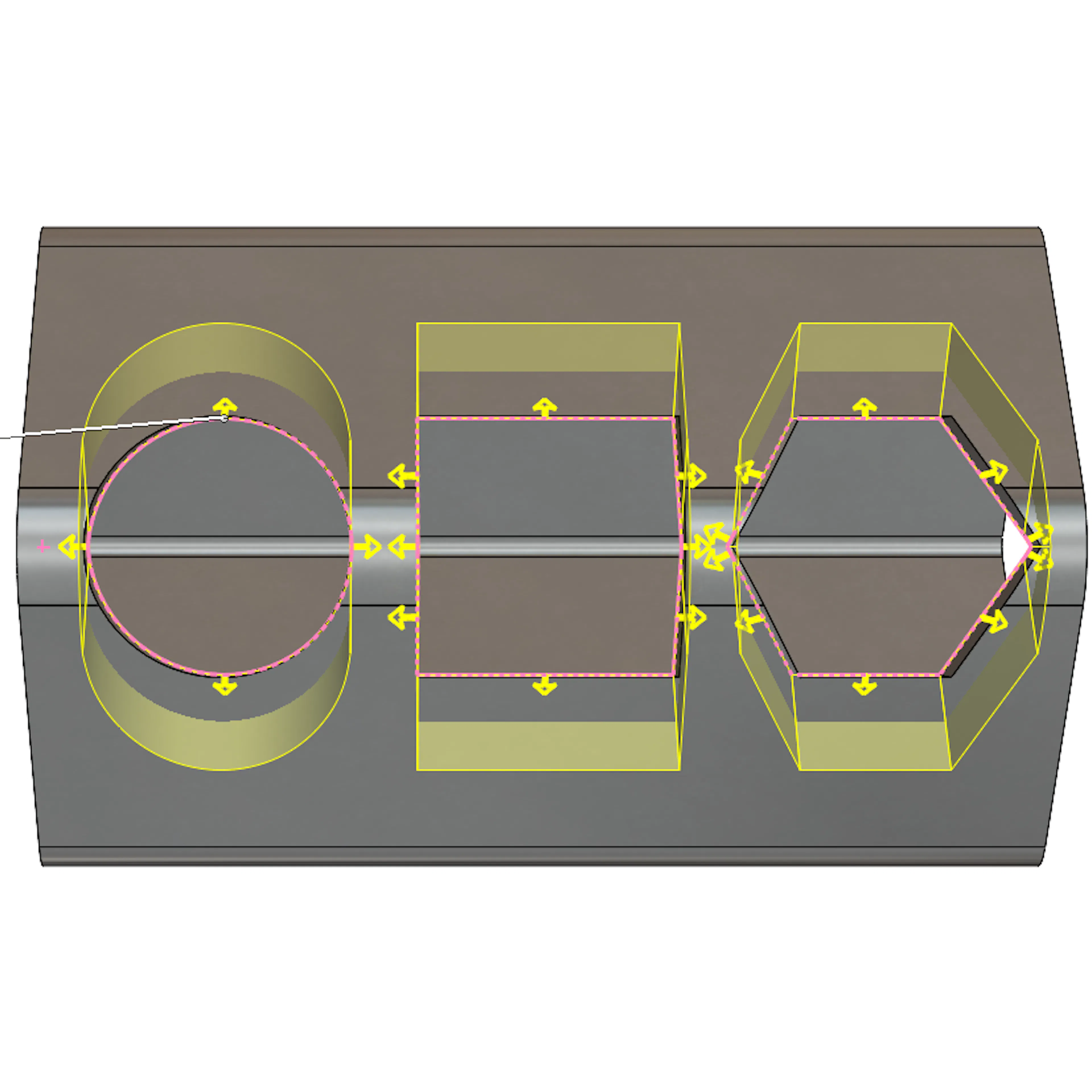

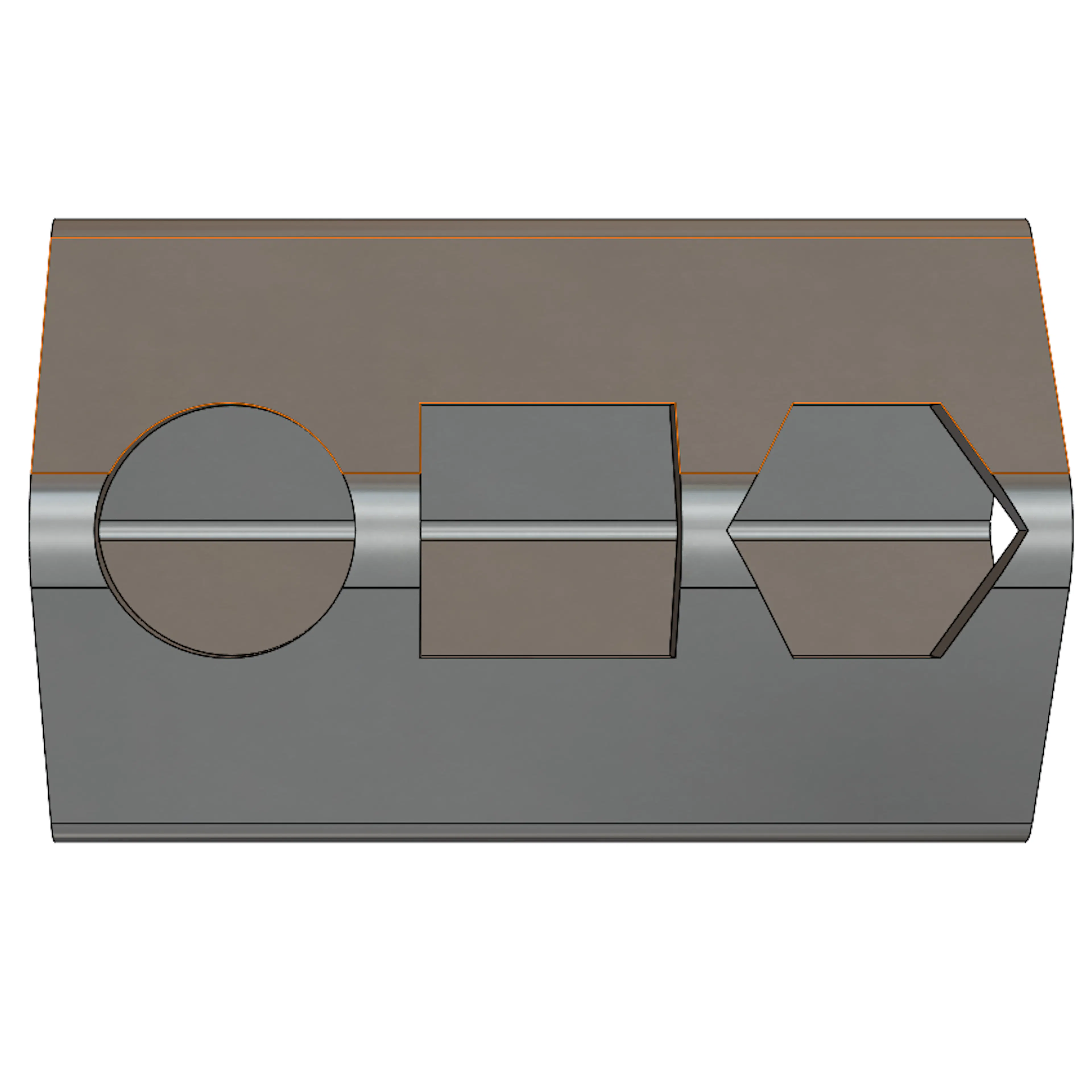

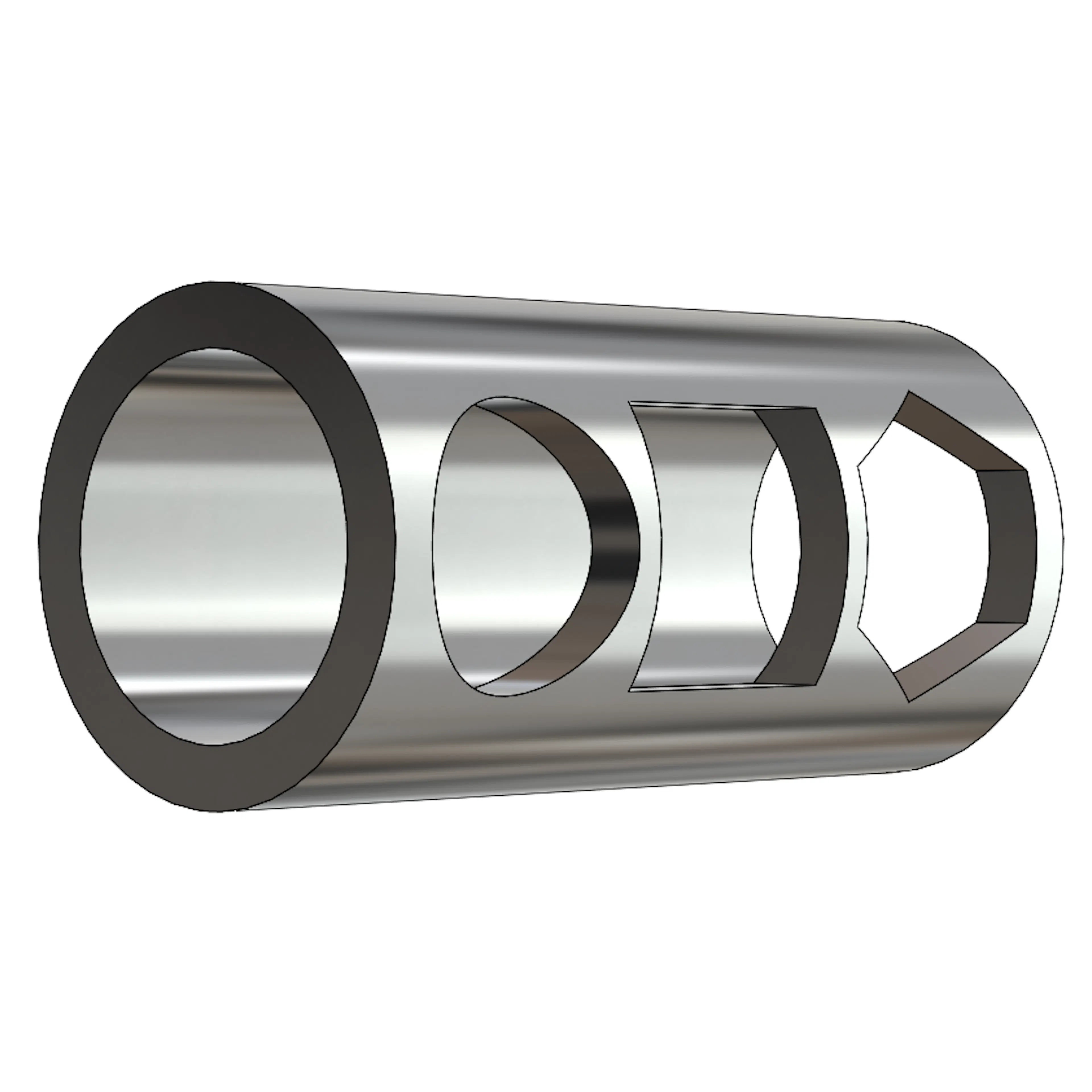

Three holes on a round tube in SolidWorksNormal to Edge Holes
The ruled surface command in SolidWorks on holes from a round tube.Laser Path Reference
Three normalized holes on a round tube in SolidWorksNormal to Surface Holes
A side view of three holes in a round tube.Normal to Edge Holes
A side view of the ruled surface tool in SolidWorks on a round tube with three holes.Laser Path Reference
A side view of three normalized holes in a round tube.Normal to Surface Holes
A mitered square tube in SolidWorks.Normal to Edge Miter

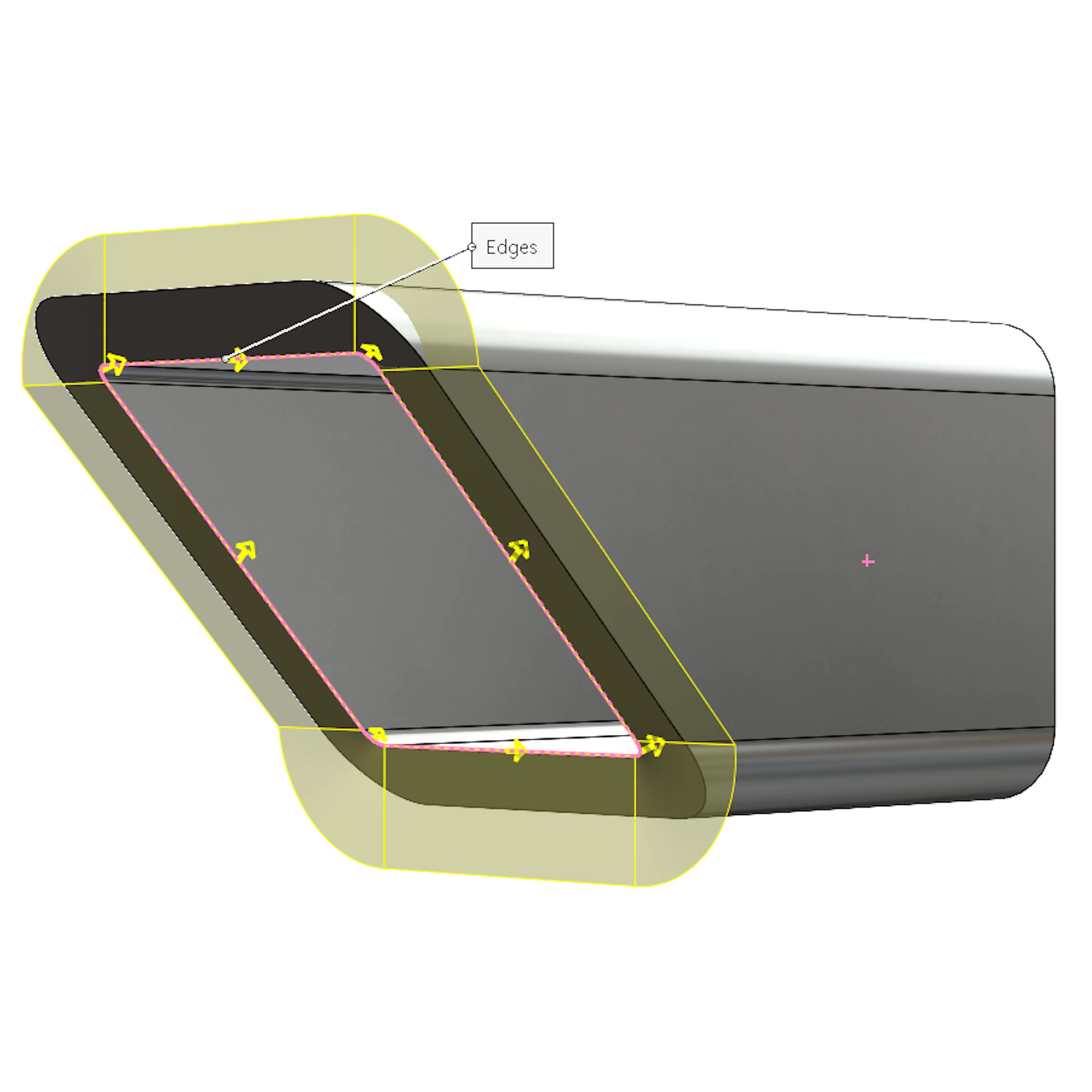

The ruled surface tool in SolidWorks on a mitered square tube.Laser Path Reference

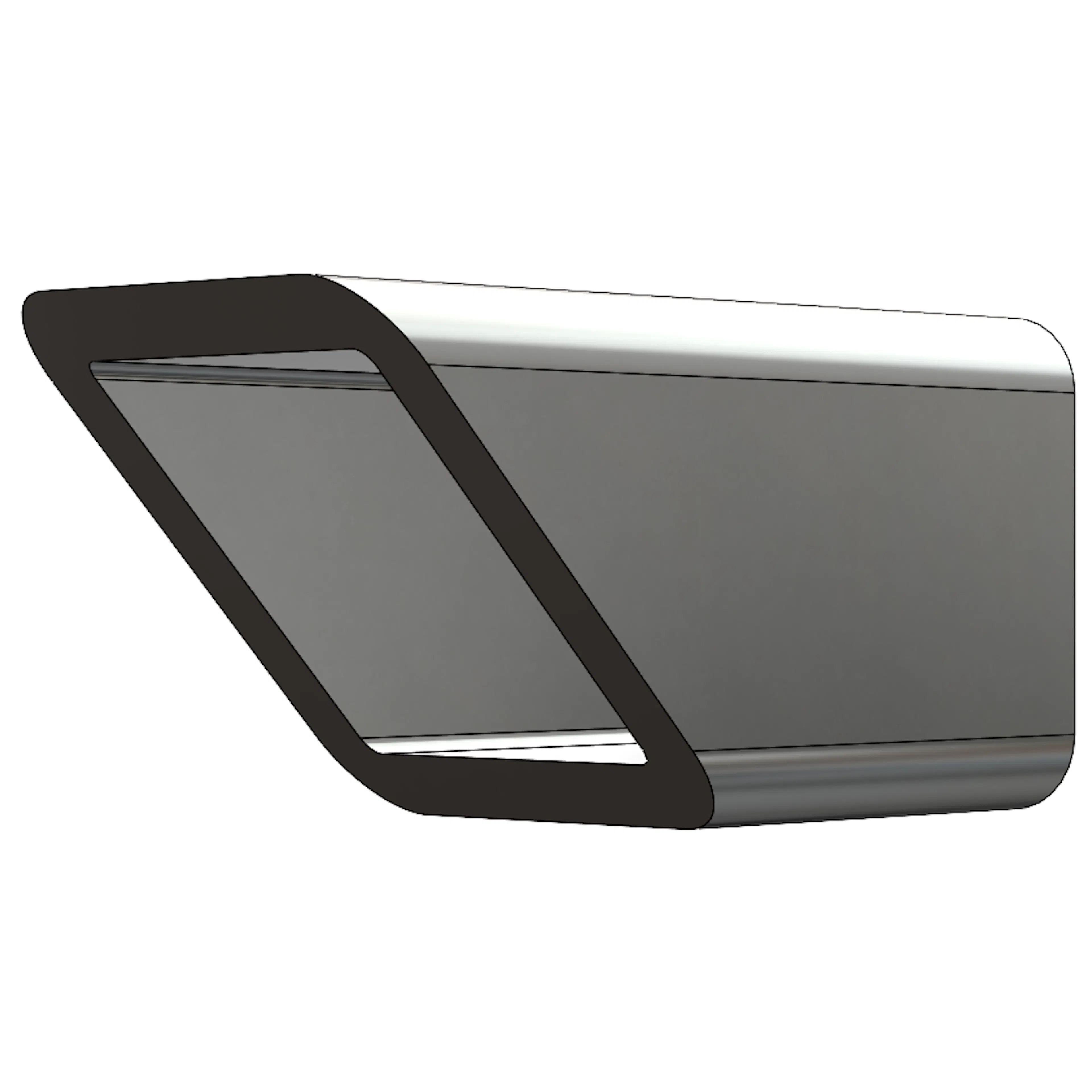

A normalized miter on square tube in SolidWorks.Normal to Surface Miter
A side view of a miter cut on a square tube in SolidWorks.Normal to Edge Miter
A side view of the ruled surface tool in SolidWorks on a mitered square tube.Laser Path Reference
A side view of a normalized miter cut on square tube in SolidWorks.Normal to Surface Miter

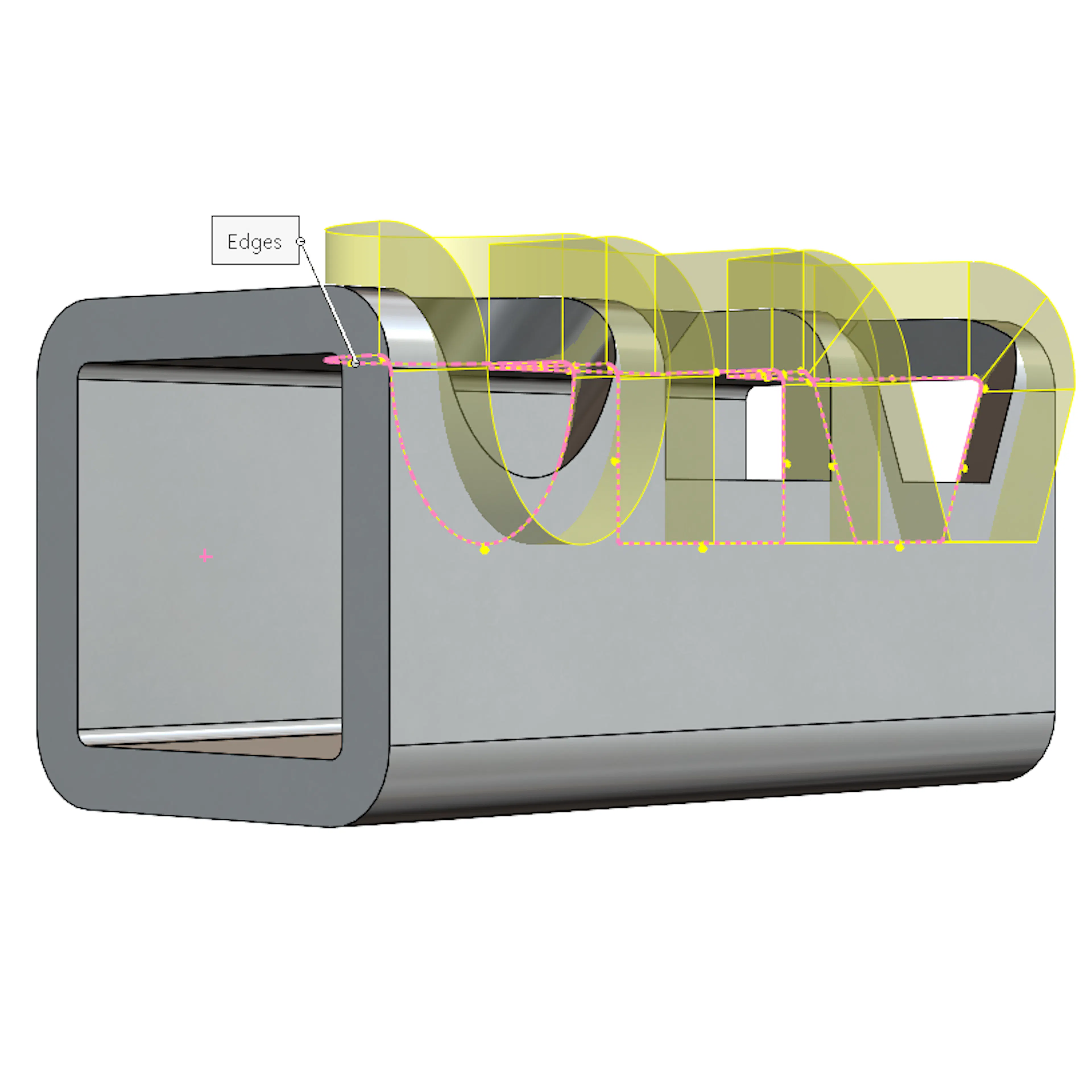

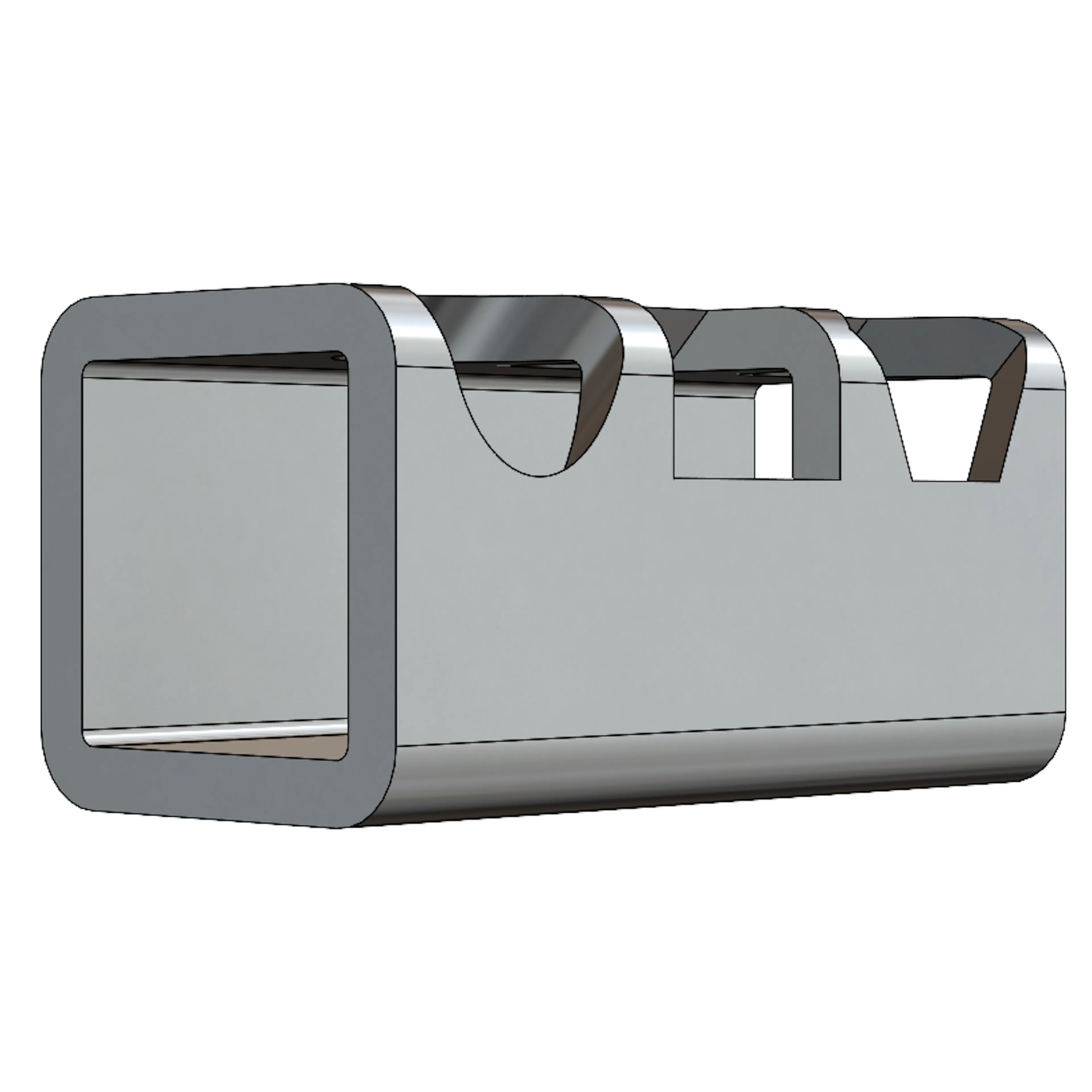

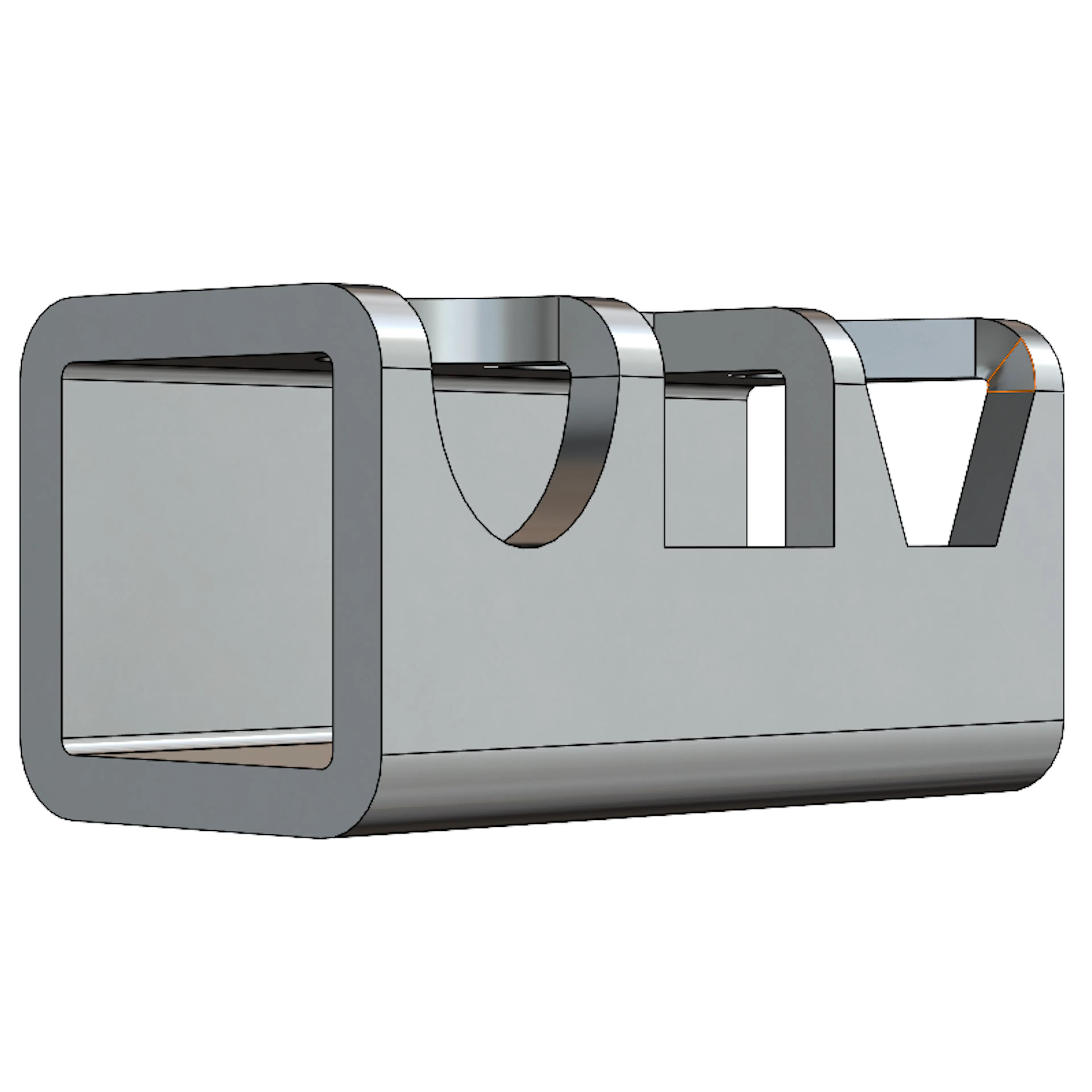

Three holes on a square tube in SolidWorks.Normal to Edge Holes
The ruled surface command in SolidWorks on a square tube with three holes.Laser Path Reference
Three normalized holes on a square tube in SolidWorks.Normal to Surface Holes
A side view of three holes on a square tube in SoldiWorks.Normal to Edge Holes
A side view of the ruled surface tool in SolidWorks on a square tube with three holes.Laser Path Reference
A side view of three normalized holes on a square tube in SolidWorks.Normal to Surface Holes
