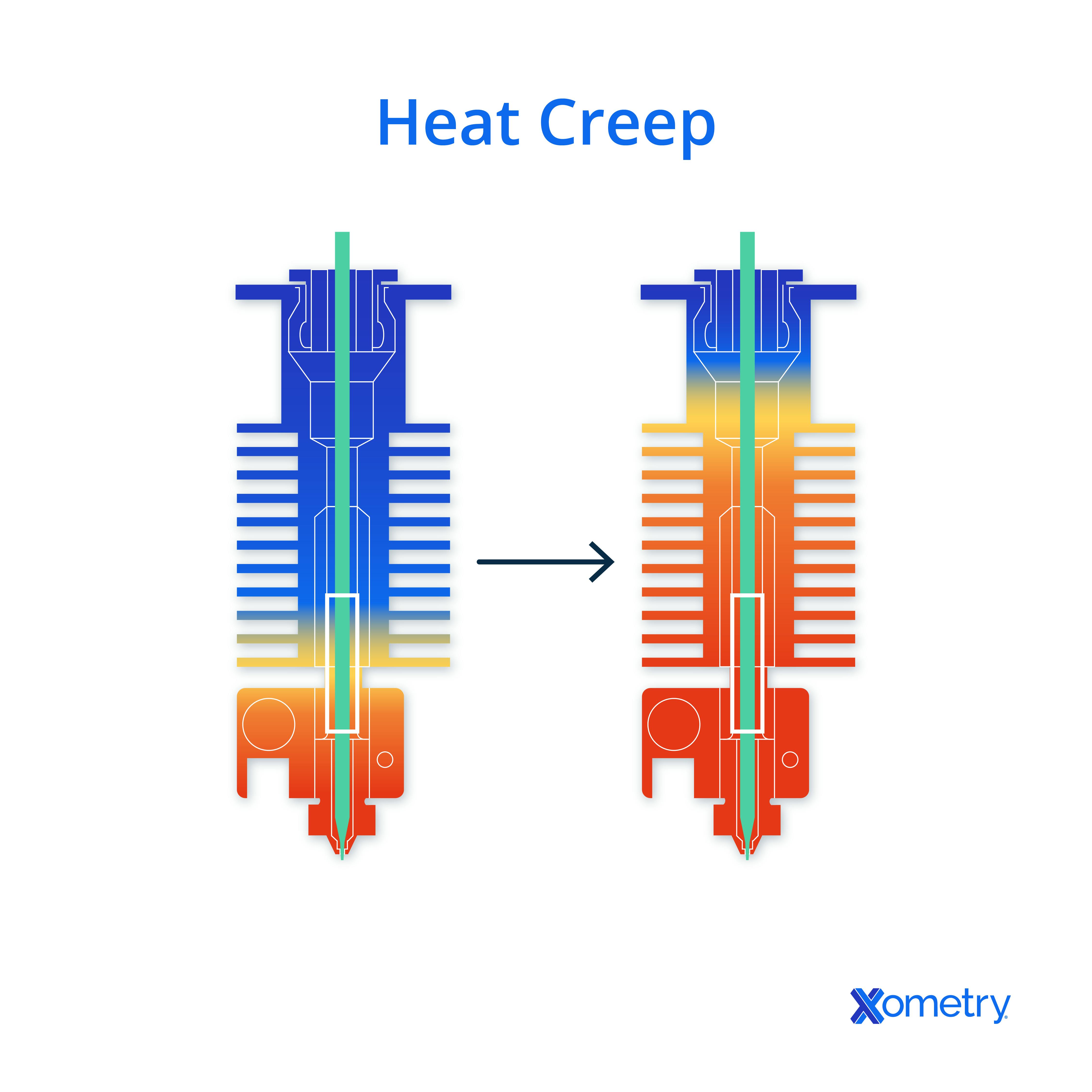

Heat creep is the process of unsteady heat transfer throughout the hot end and melts the filament too early, before the melt zone. This results in clogging in some parts, specifically on the extrusion path and the thermal barrier tube. Heat creep has various causes, all of which are controllable to some degree. For more information, see our 3D printing guide.
Diagram showing heat creep

1. Hot End Is Overheated
The filament is delivered through an electrical heater that should bring it to the correct extrusion temperature as it is fed through. This device is usually termed the “hot end”. A malfunctioning thermostat (poorly thermally connected to the hot end) or too high a temperature setting can push the temperature in the feeder parts of the print head high enough to prematurely melt the filament.
2. Not Enough Cooling for the Hot End or Broken Cooling Fan
The hot end is cooled by a fan to create a strong temperature gradient up through the print head. If the fan isn’t delivering enough cooling air, heat buildup will reduce the temperature gradient and prematurely melt the filament. This can result from fan speed setting, fan damage, detritus buildup, and other causes.
