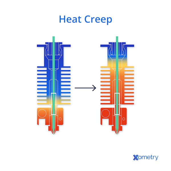

What Is Heat Creep in 3D Printing?
Heat creep in 3D printing refers to the process by which heat from the hot end of an extruder creeps up the extruder assembly and may heat and soften the filament too far from the nozzle. This heating will cause the plastic to swell and can cause blockages in the extruder.
 For more information, see our Heat Creep.
Diagram showing heat creep
