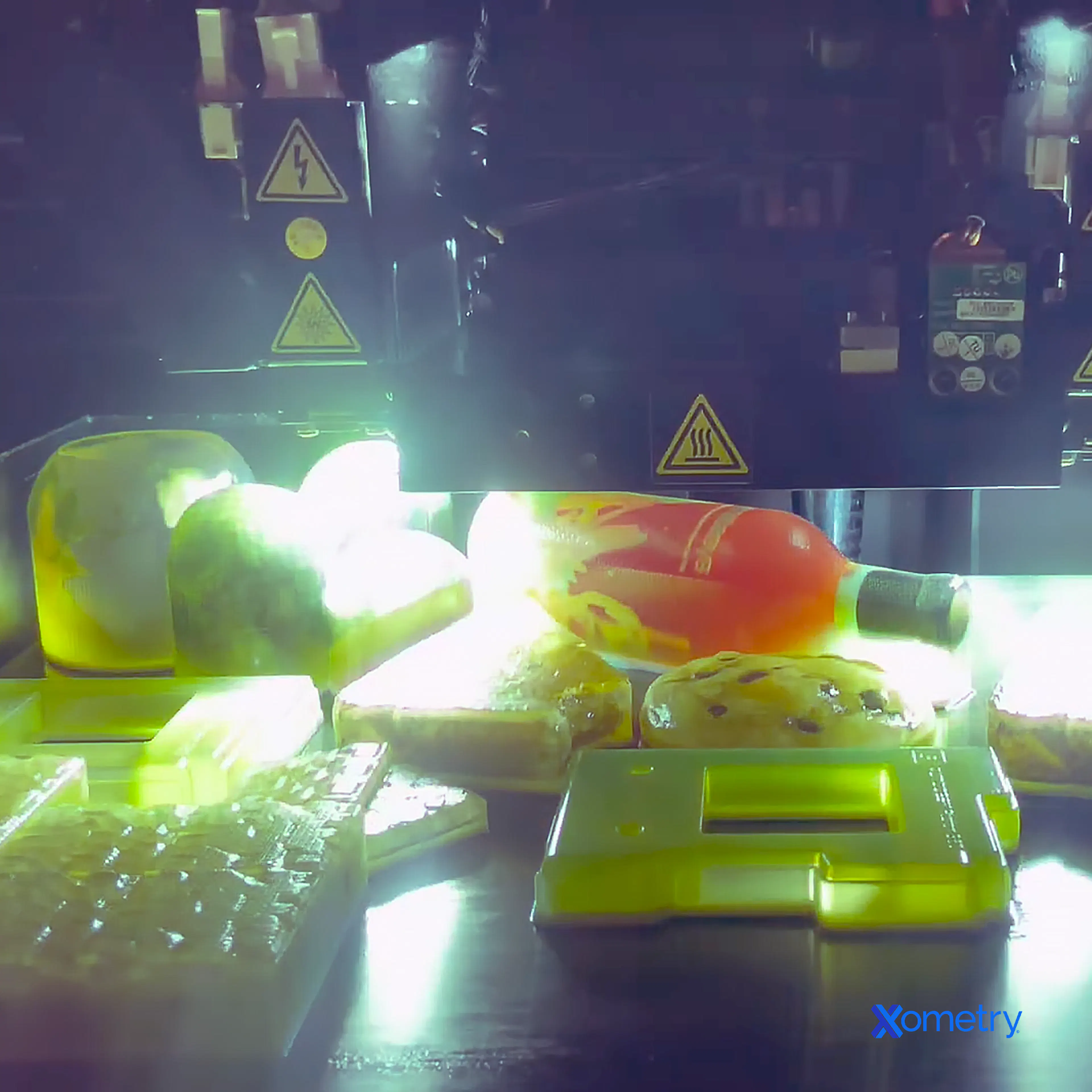

First developed by Objet-Geometries in 2000, PolyJet 3D printers work quite similarly to inkjet printers. But, instead of depositing drops of liquid ink, PolyJet works by releasing drops of photopolymer, one layer at a time, until it builds a whole 3D model. As it’s being built, UV light cures and solidifies each layer. This type of printer uses multiple heads that work at the same time to lay down the material as well as any support material, which can later be removed by water jetting. If the support material is too thick, it might need some more post-processing like using a chemical bath, peeling, and washing off. These printers can actually print materials other than resin, too, and they can tackle rather large production volumes. But they can’t really make large-format parts. Here’s an image of some parts being printed in a PolyJet printer here at Xometry:
polyjet parts in a machine
Color PolyJet parts being printed at Xometry

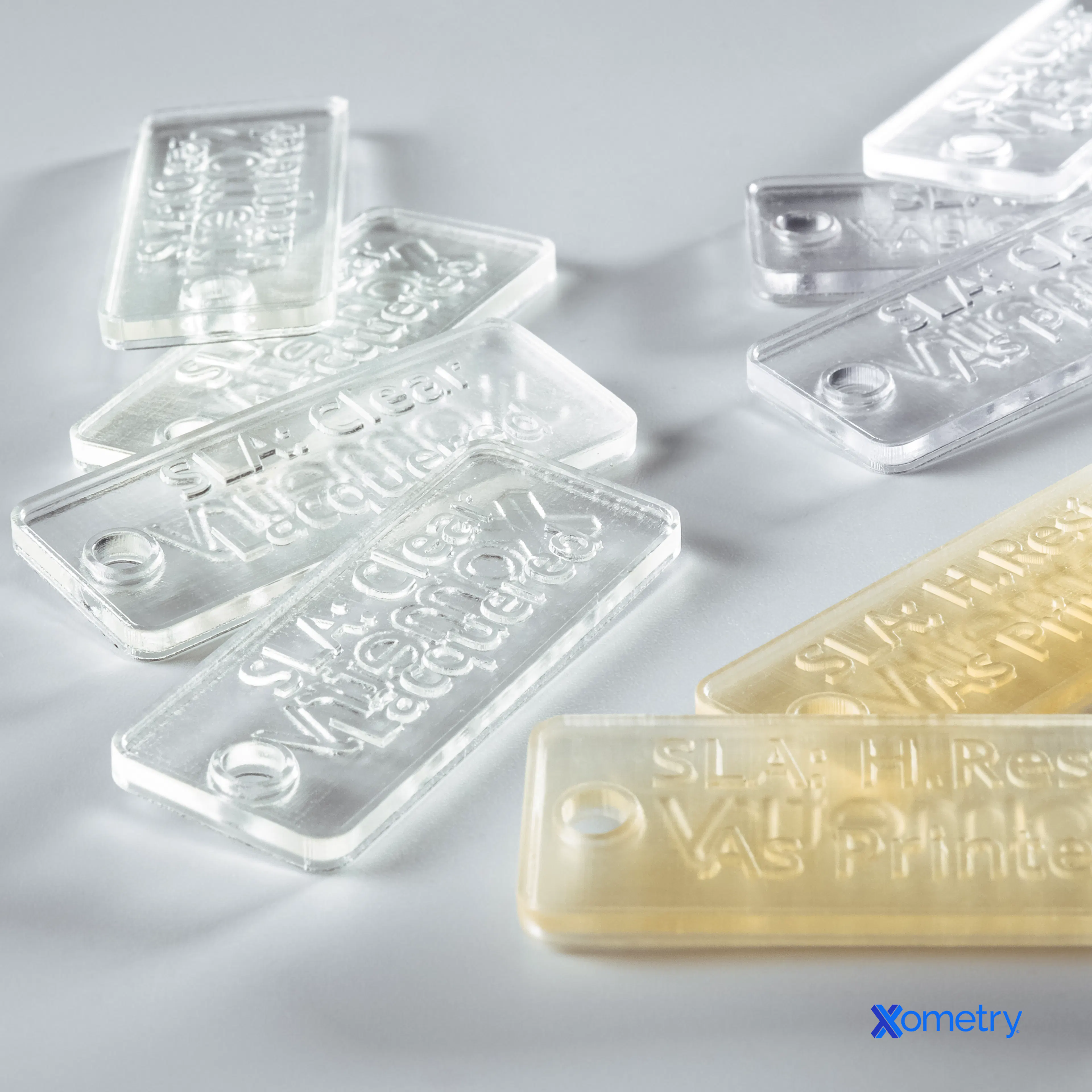

Tags made by Xometry using SLA
But, it does have some drawbacks. SLA printers are not as stable as PolyJet printers, which could result in variations between prints, especially if they’re supposed to be the same. Also, they’re not compatible with various materials, and they’re limited to gray, white, and clear color options. The layers these printers can make are usually much thicker, with SLA having a minimum thickness of around 50 microns and PolyJet going down to 16. The last two potential downsides are that SLA parts can be rather brittle and fragile (not great for functional prototypes), and the process can get quite messy—think resin spills, post-processing, and nasty odors.
