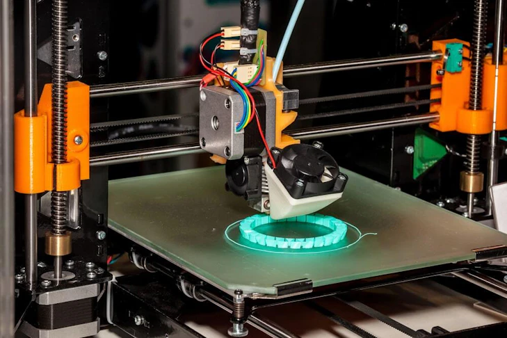

3D printing process up close. Image Credit: Shutterstock.com/Alexander Tolstykh

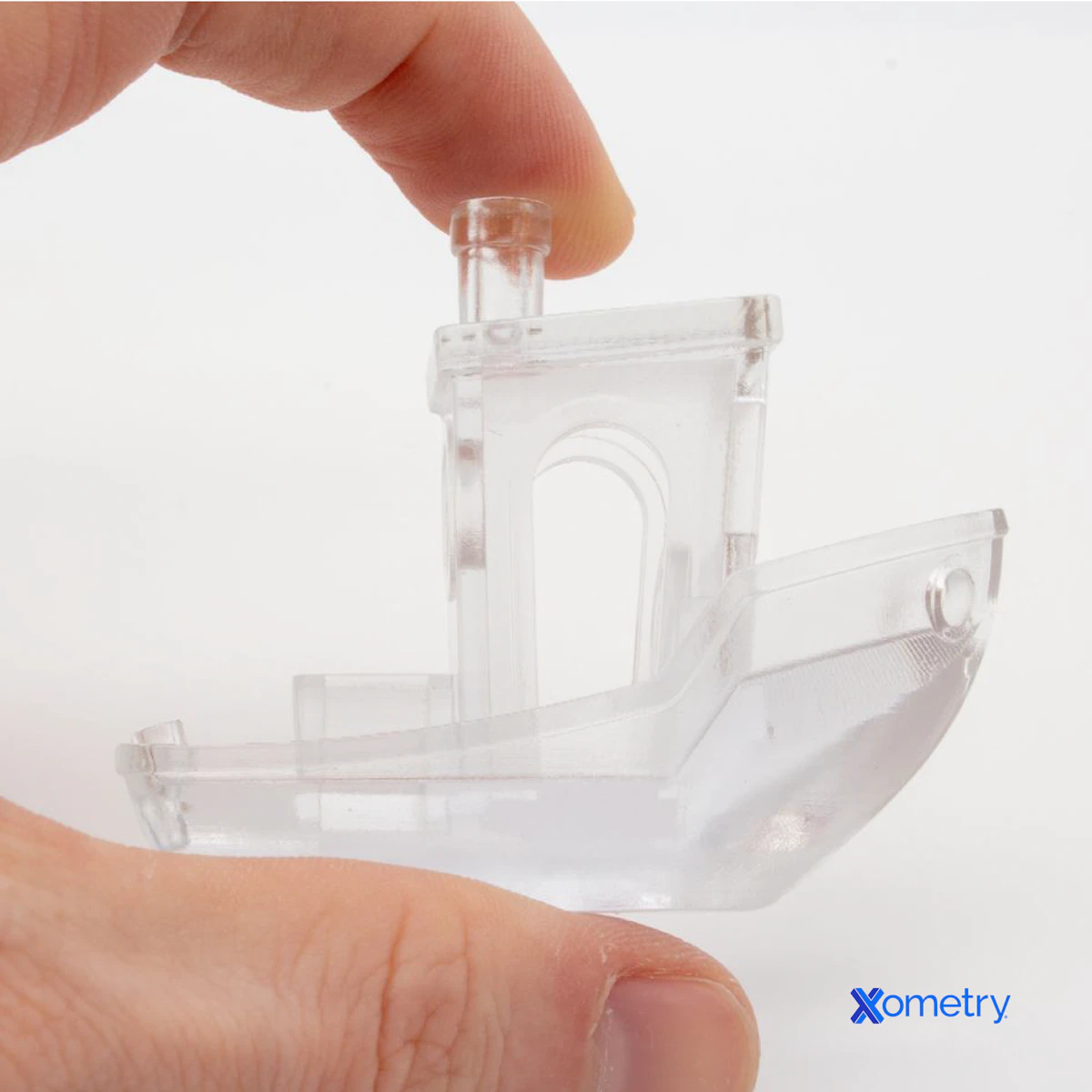

SLA part made from Accura ClearVue with Xometrys quick-clear finish.

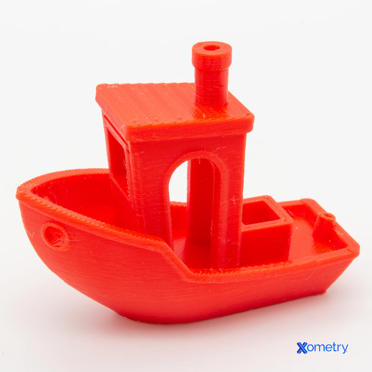

An FDM part printed with Xometry's red PLA.

  • FDM layer lines are very visible. Parts often need to be post-processed to get the smooth surface finishes commonly found with SLA parts.
  • Despite the strength of the material used in FDM printing, the parts tend to be highly anisotropic in the direction of the print. This is due to the relatively weak interlayer bonding.
