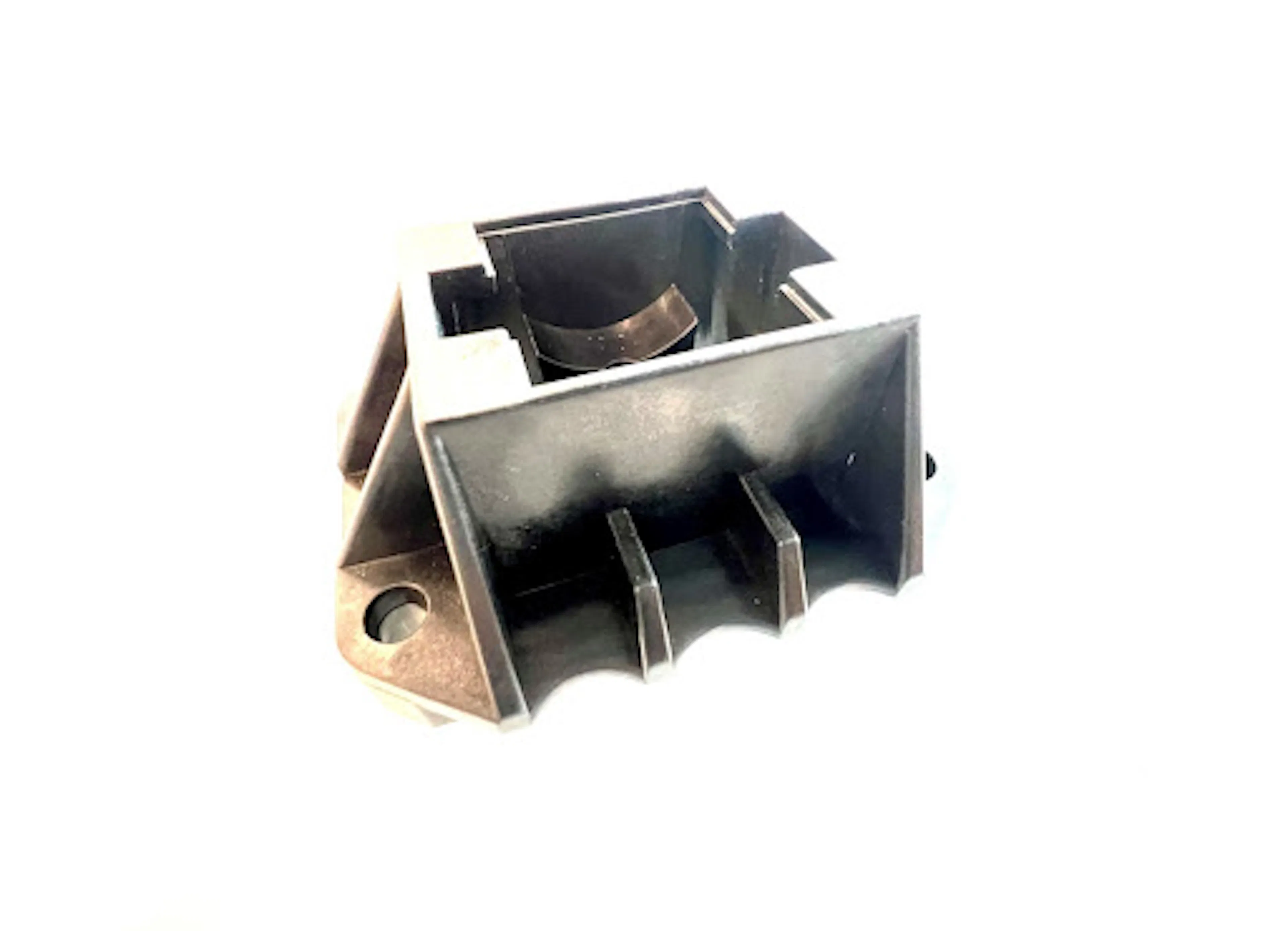

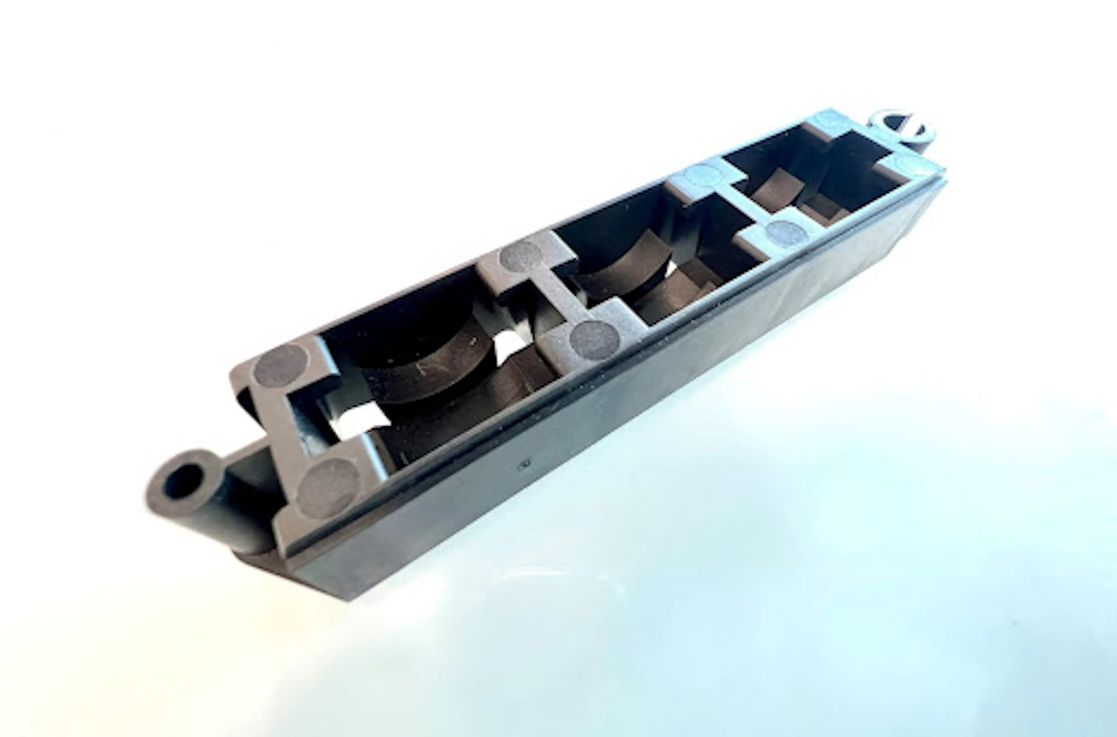

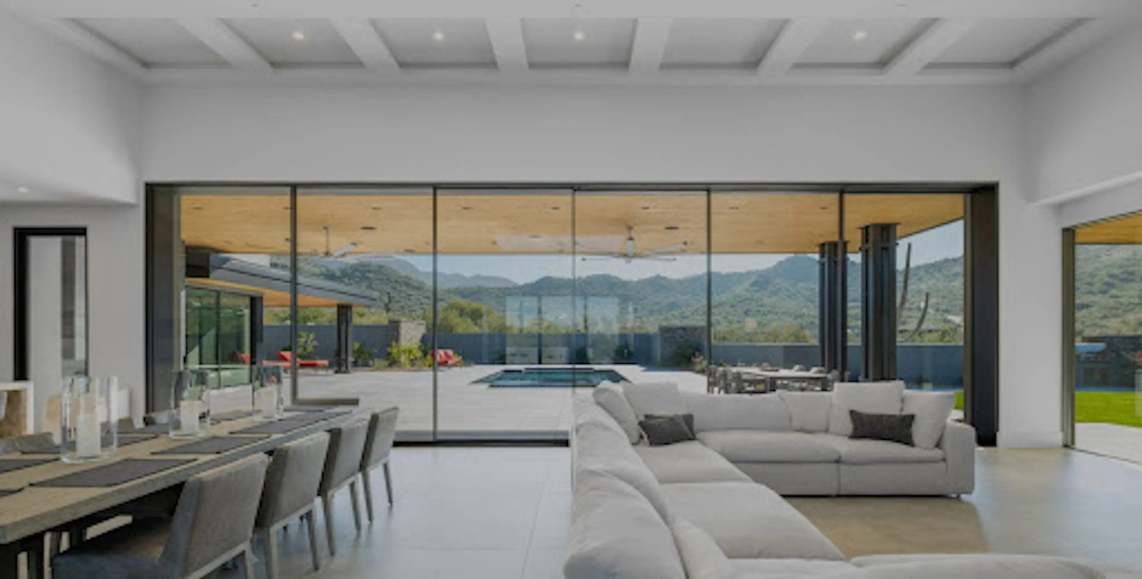

To get a peak behind the curtain, Dustin Wright, VP of Engineering and Design at Awake, explained how the integration of Xometry-produced plastic components are revolutionizing Awake’s flagship product; its glass multi-slide door system, which offers five different sills, four different interlocks, and two innovative lead stiles that give design flexibility.
To support these large glass windows with impressive skylines, the Awake engineering team needed to design a multi-slide door roller carriage that could carry up to 300 pounds. Typically, the design of these rollers creates an expensive, complex system that is difficult to put together. Awake needed to find a way to improve the product by making it affordable, more durable, and easier to assemble.
Wright and his engineering team decided that introducing injection-molded components into their design would help them satisfy each requirement. He explained how they came to this realization by drawing from an unlikely source of inspiration — the aerospace industry.
“When you look at the history of planes, you’ll notice that they were getting bigger and bigger over time. Naturally, as planes got bigger, their landing gears needed to get bigger as well. The industry realized that, instead of having one big tire for the landing gear system, they could more easily and cost-effectively distribute the load by using multiple smaller tires,” explained Wright.
“We found a similar solution that could be used in our own industry by innovating on the typical roller design with this multiple small wheel design philosophy; rather than producing one or two large and expensive components, we were able to use injection molding to create a significantly better product by adding a little bit of design complexity.”
Injection Molded Components: How the Design Came to Life
A component used in Awake's roller carriage design which was injection molded by Xometry.
By working with Xometry injection molding design experts, including their technical case manager Ben Limon, the Awake team received prototypes for these components quickly. The final design of their flagship product allowed them to integrate smaller, affordable plastic components instead of integrating one or two large and expensive sheet metal stamped components commonly used in the fenestration industry. And by using 30% glass-filled nylon material, they were able to build durable parts cost-effectively.
“We wanted something that was going to be able to respond well to those high shock loads that can occur if the part is dropped or encounters some kind of impact,” said Wright.
He further explained why these components needed to be able to endure a variety of high-stress environments: “Some of these systems get installed in high altitudes as well in very cold climates. This winter, we had some systems that were being installed and are being used at sub-zero temperatures. We need something that is UV resistant and has the ability to handle those wide temperature ranges while at the same time avoiding any creep or deformation challenges that can occur when injection molded parts aren’t optimally designed.”
“We asked ourselves, ‘How do build something innovative like this?’ You select an industry-proven material, and you work with an industry-proven vendor that will help you solve problems.”
Dustin Wright
VP or Engineering and Design at Awake Window and Door Co.
Xometry engineers helped provide design for manufacturability feedback that improved Awake’s product design by removing slides and complicated gating features. We also helped them meet challenges to achieve tight injection molding tolerances that are uncommon in the fenestration industry.
“For our industry, a lot of suppliers are commonly making parts at plus or minus a 1/64th of an inch or a 1/6th millimeters. We're asking for three-thousandths of an inch [0.003”] on some of the tolerances for these components, which meant we had to pivot towards suppliers that are more comfortable working with automotive and aerospace-based suppliers—engineers that speak a language that's a bit different than what the fenestration industry is really used to,” said Wright. “That's where Xometry engineers were able to lend a lot of our key advice, specifically around achieving our desired feature.”,” said Wright. “That's where Xometry engineers were able to lend a lot of our key advice, specifically around achieving our desired feature.”

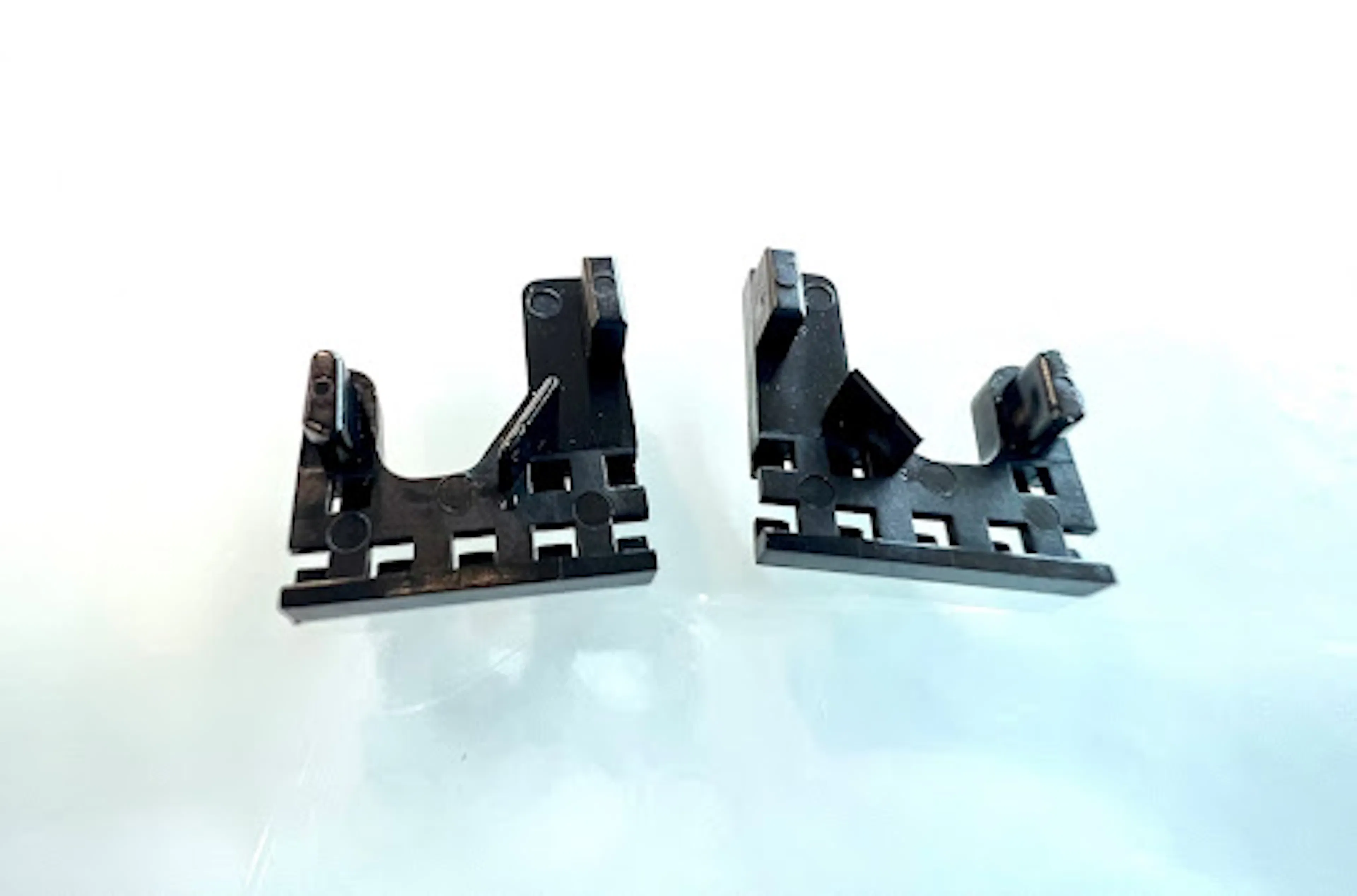

In addition to the components produced for the multi-slide door carriage, Awake also makes components for other parts of their multi-door system, like their interlocking seals and carriers, which hold seals within the moving panel in their multi-door system, as well as plastic pieces used in their single roller system.

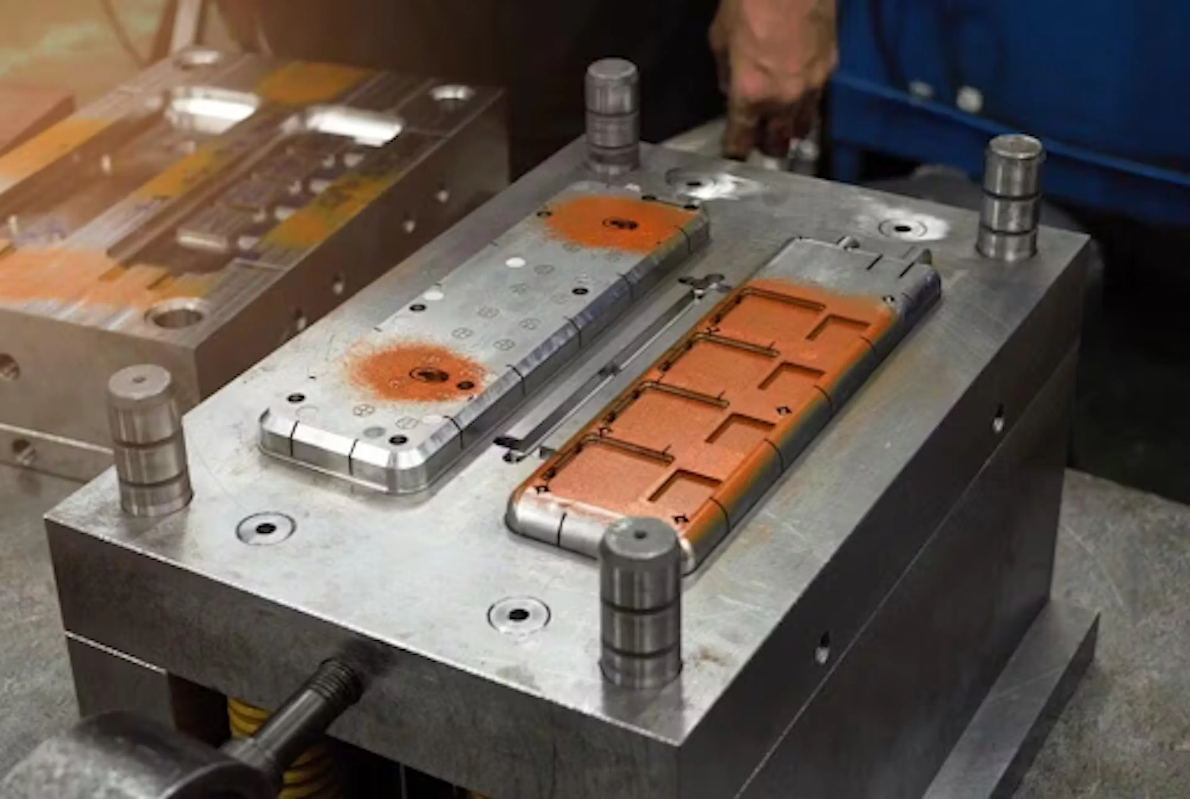

The mold tools that Awake designed with Xometry’s guidance profoundly impacted their business model, according to Neal Rabuse, a senior supply chain analyst at Awake.
“I did a supply chain comparison of all of our injection molded components: time and time again, Xometry beat other injection molding suppliers. After I realized this, I sent out a company-wide mandate that if it is injection molded, we need to order it with Xometry.”
