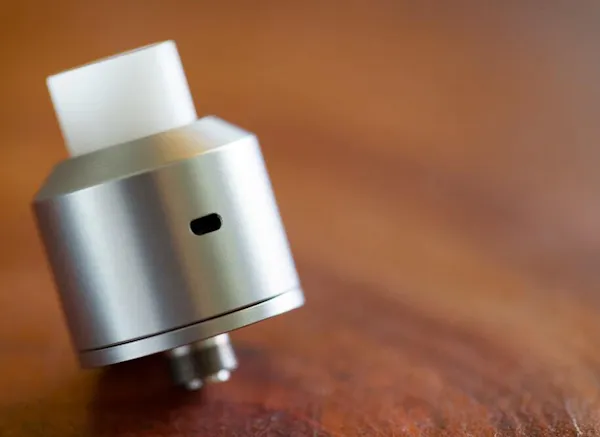

High end rebuildable dripping atomizer with Delrin® tip. Image Credit: fluke samed/Shutterstock.com

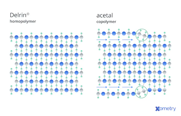

delrin vs. acetal
Delrin vs. acetal
What is Acetal?
Acetal is a semi-crystalline engineering thermoplastic that comes in two forms: homopolymer and copolymer. The terms “POM” and “acetal” are often used interchangeably, but in practical terms, “acetal” generally refers to the copolymer version. This copolymer is a chain of CH2O molecules with extra comonomers added in after every 70–100 units of CH2O. These disrupt the regular ordering of the molecular chains, ultimately making the material less crystalline.
Acetal copolymers readily accept reinforcing materials like glass fiber, and their molecules can be chemically bonded to the glass via coupling, which increases its strength and stiffness. Acetal has a low friction coefficient, meaning that it’s got good wear- and abrasion-resistance. It can also handle exposure to organic and inorganic solvents and acids, and prolonged exposure to hot water and high temperatures. This copolymer’s low porosity means that centerline porosity (where voids form in the center of an extruded part/sheet) will be highly unlikely. It’s also, most times, more affordable than homopolymer POMs, too.

Delrin is a semicrystalline homopolymer POM that’s one of the strongest and stiffest unreinforced polymers around. It was developed by DuPont (which patented the “Derlin” trade name). Homopolymers have a uniform backbone made with repeating CH2O units, which makes it possible to create larger crystalline blocks than other POMs. Delrin’s high crystallinity gives it excellent mechanical properties, including the aforementioned strength and stiffness, as well as spring back. There are different types of Delrin, some of which have fillers like glass fiber and PTFE.
