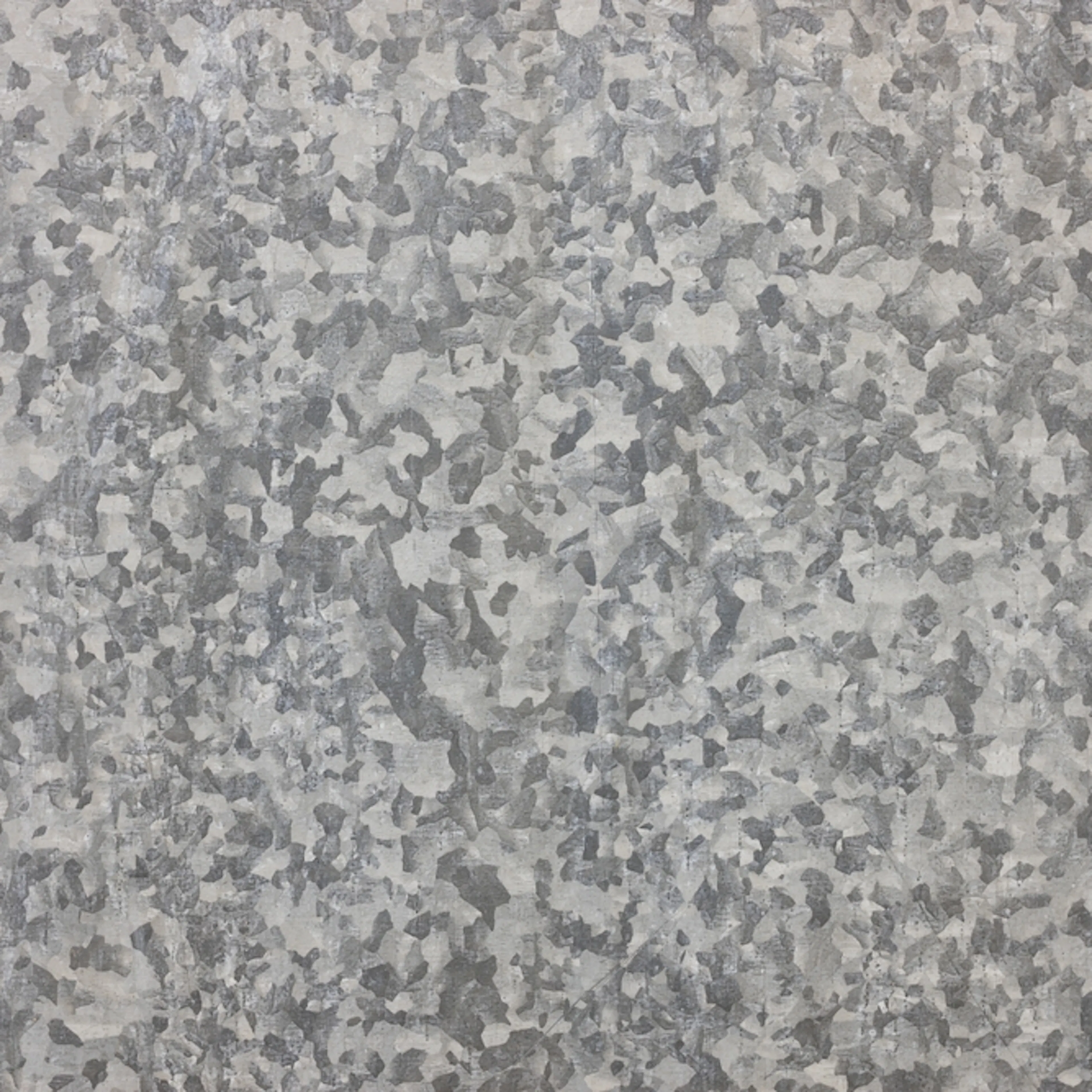

Hot-dip galvanized iron sheet. Image Credit: Shutterstock.com/Photomann7
The purpose of hot-dip galvanizing is to protect the material from corrosion by creating a layer of zinc that acts as a protective coating. The process of hot dipping is to submerge the metal into a bath of molten zinc, which metallurgically bonds itself to the material (usually steel). This then protects the material against external elements such as: humidity, moisture, sodium chloride, and acid. The hot-dipped galvanized steel can be used across a wide range of industries, for things such as: roofing, structural beams, automotive bodies, rebar in cement, metal fences, and electrical pylons.
