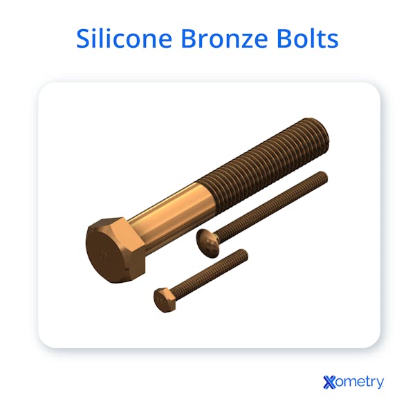

An illustration of silicone bronze bolts.

What Are the Applications of Silicon Bronze and Brass?
Silicon bronze and brass find applications in various industries and sectors due to their unique properties. Silicon bronze’s applications range from:
  1. Marine and architectural hardware
  2. Electrical contacts
  3. Art and sculptures
  4. Fasteners
