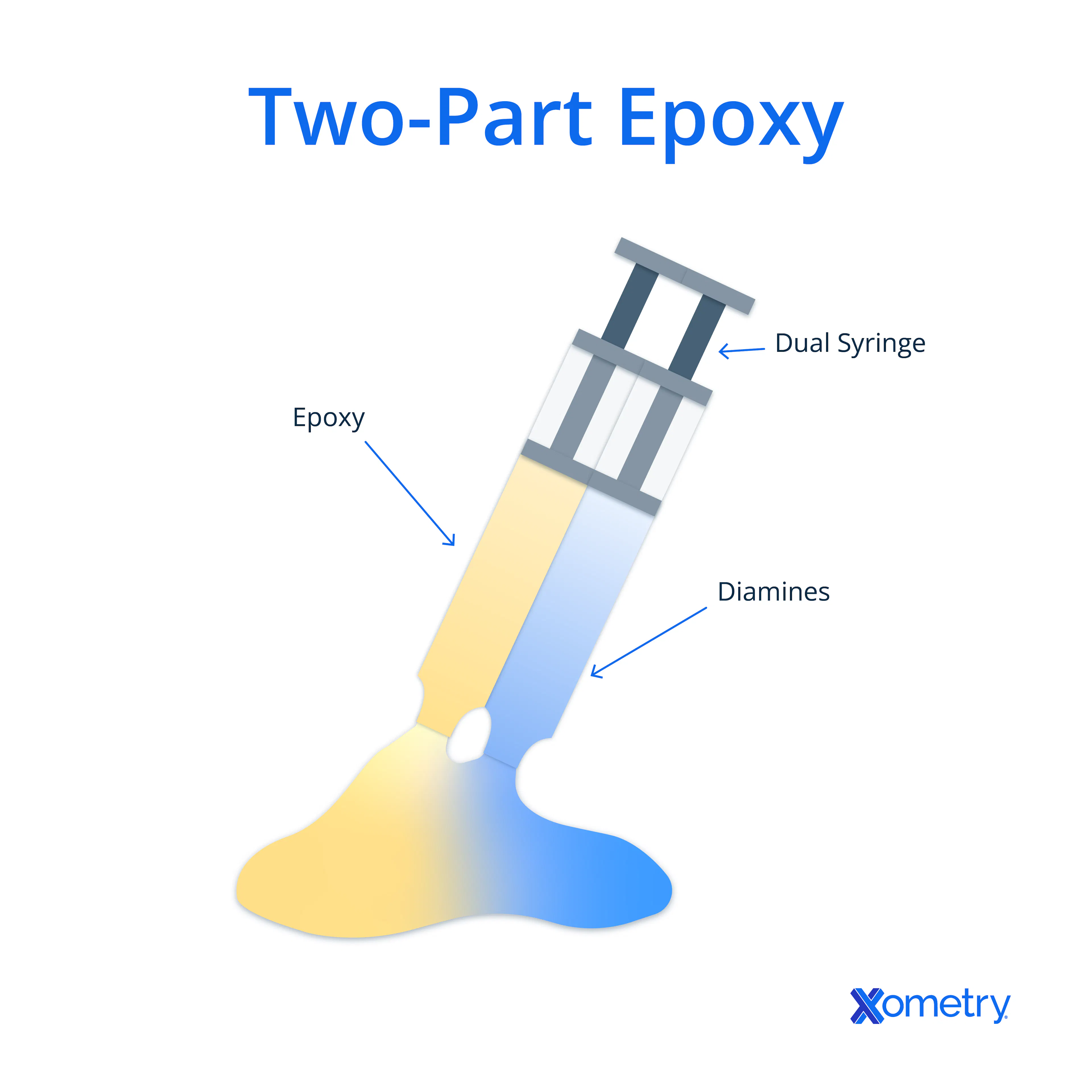

two-part epoxy
Two-part epoxy

Does Epoxy Resin Require a Hardener to Cure?
Yes, epoxy resin requires a hardener to cure into a rigid and functional solid material. The hardener provides the necessary reactive sites that allow the epoxide groups to form a continuous network. Mixing initiates an exothermic cross-linking reaction, not polymer chain formation. Without the curing agent, the resin remains a viscous liquid lacking structural integrity. Proper ratios ensure that every epoxide ring finds a partner for effective cross-linking. Bonding depends on curing, but also on surface preparation, adhesion, and processing conditions. Industrial processes utilize various types of amines or anhydrides as hardening agents for specific speeds and strengths. The resulting three-dimensional network delivers the durability needed for heavy-duty applications.

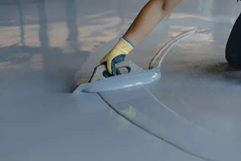

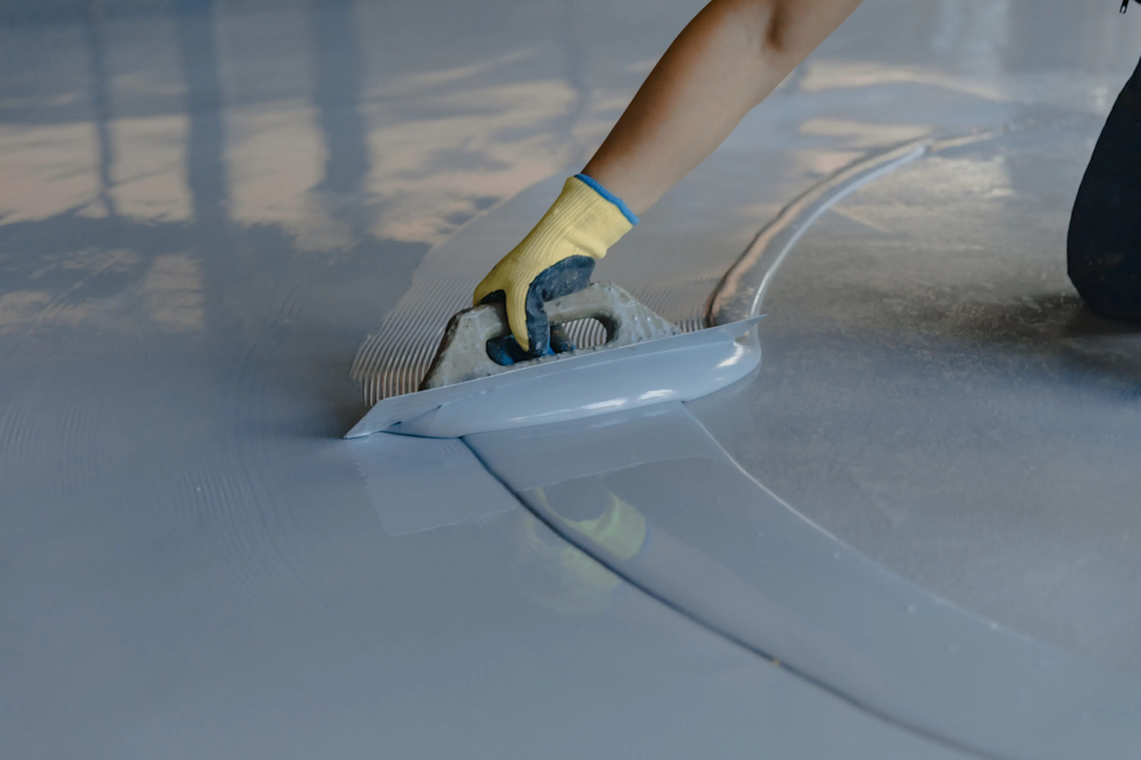

Use for Flooring
Uses of epoxy for flooring provide a seamless and extremely durable surface for commercial and residential spaces. Warehouse floors utilize the coating to resist heavy forklift traffic and chemical spills. Garage owners install the material to protect concrete from oil stains and road salts. Slip-resistant textures increase safety in kitchens and laboratories where spills occur. The high-gloss finish improves indoor lighting by reflecting light across the workspace.
