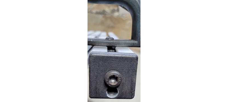

The PSPP handle with its button holder
A vacuum end cap for the PSPP
A system slider

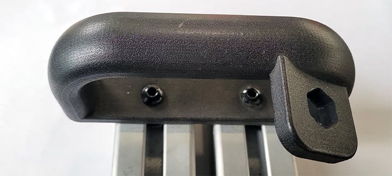

When asked which of his Xometry-produced parts was his favorite, Kaufman points to a tool with 3D-printed pieces lovingly called the “PopSocket picker placer” or PSPP for short. The PSPP is used to pick anywhere from 2 to 20 PopGrips at a time out of their printing jigs. The selective laser service (SLS) prints on this part included creating custom SLS handles with mounting points for a button and SLS-printed end caps to create a vacuum-tight seal. Utilizing Xometry’s SLS service, this tool enabled iClick to cut the time to remove PopGrips from a fully loaded jig from 40 minutes to 5 minutes.

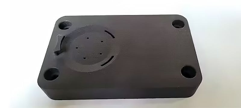

In addition, Kaufman and the iClick team use Xometry’s selective laser sintering (SLS) 3D-printing service for a variety of assembly line enhancing functions, including two unique parts (for a total of four) located on the robotic arm systems. The first is what iClick calls a “carding jig” where the robots slide the backer card onto the PopGrip. Second is the “chute” that both robots drop the product through into an outfeed that sorts up to 8 unique orders. Xometry also CNC machined silver trays, which present the PopGrip to the robots to then be processed through the system. Each tray holds 200 PopGrips, and each system can hold a total of 8 trays.

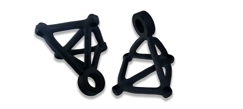

The robotic arms iClick uses in its PopGrip assembly line have an internal airline that provides air to the robotic arm's SmartGrippers. These SmartGrippers provide a vacuum to pick up both the PopGrips and Cards. When this internal airline broke, production came to a standstill due to a loss of vacuum in the SmartGrippers. The iClick team immediately tried to repair it themselves. Unfortunately, they were unable to do so and determined they would have to replace it entirely. The original manufacturer quoted them $13,000 to fix it.
Kaufman and his team determined that they could use SLS 3D printing to circumvent this costly replacement by creating their own vacuum system and mount. This mount would secure the airline with vacuum-sealed grippers. This mount needed to exactly match the original distancing of the robotic arm to keep the assembly arm functioning under its standard configuration.
The SLS 3D printed mounts for the dual-arm collaborative robot assembly line
By taking advantage of the design accuracy and complexity possible with SLS printing, Kaufman and his team were able to source mounts that met their exact specifications. By comparison, these designs would not have been possible with other 3D-printing processes like FDM printing or subtractive processes like CNC machining.
Having already purchased a variety of SLS 3D-printed parts from Xometry, iClick knew it could receive affordable, reliable parts very quickly. By equipping the robotic arms with these $20 Xometry-produced mounts, the iClick team saved $13,000.
In fact, in a follow-up interview, Kaufman reported, “Actually, since we last spoke, we had another arm airline break. The only reason we didn't have to buy brand new arms is that we were able to quickly reorder the mounts SLS from you.”
