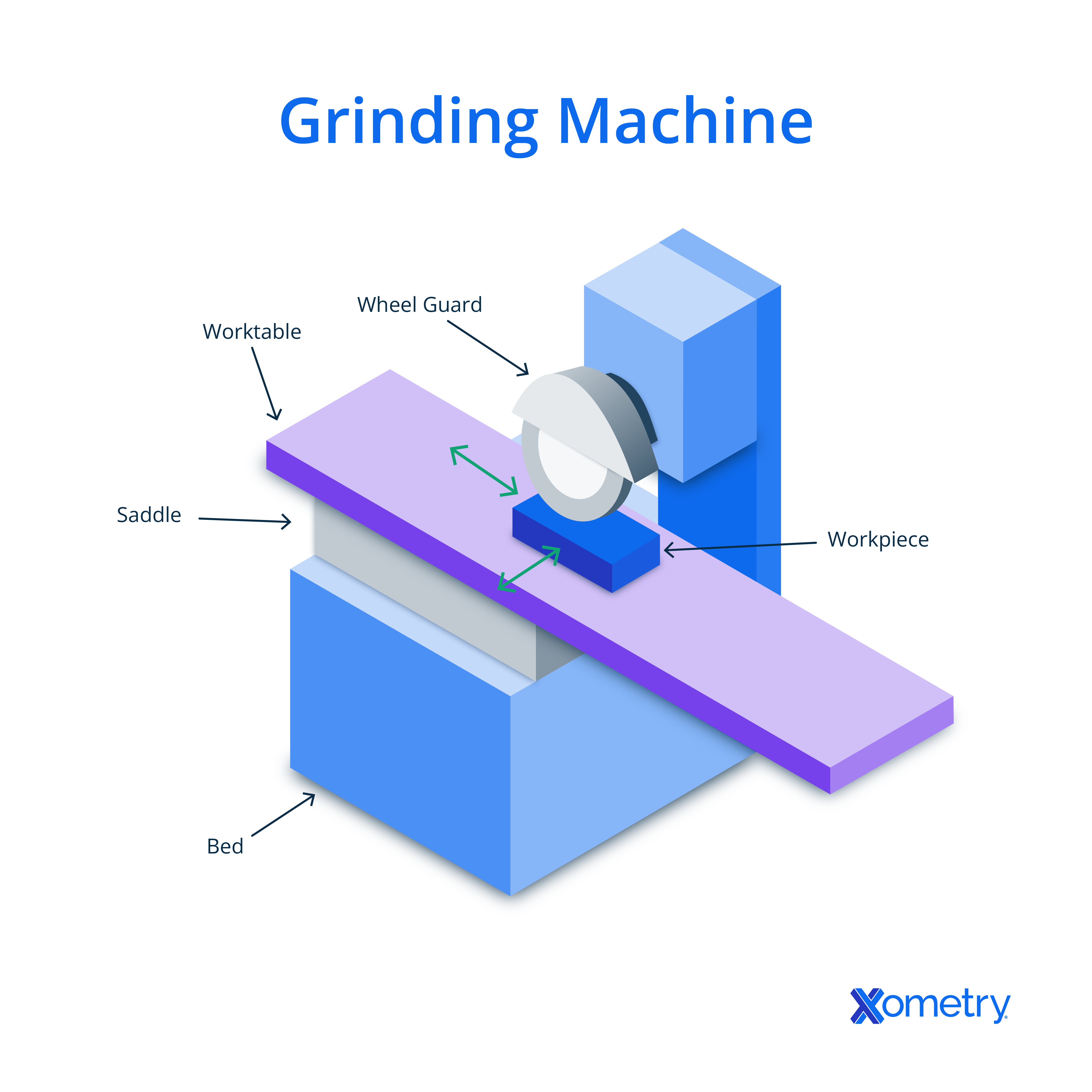

What is a Grinding Machine?
A grinding machine is a specialized tool that removes material from a workpiece using a rotating abrasive wheel. The equipment functions by wearing away the surface through the action of abrasive grains. Metals or plastics benefit from the process to reach exact dimensions it obtain high surface quality. Finishing operations (polishing, sharpening, sizing) represent the primary role of the machinery in a workshop. Abrasive grains act like tiny cutters to shave off small amounts of material. Precision engineering depends on the device to produce parts using tolerances as small as 0.0001 inches. High-speed rotation of the wheel generates heat, and the process requires coolant to prevent damage. The machine handles hardened materials (quenched steel) that traditional cutting tools fail to process. Workshops use the equipment to perform manual or automated production tasks. Efficiency remains high when the correct wheel grade matches the material. The tool ensures the final quality of the part.
A diagram of a grinding machine
What Are the Parts of Grinding Machine?
The main parts of a grinding machine include the base, spindle, grinding wheel, table, and motor. A base provides a rigid foundation to minimize vibrations during operation. The spindle serves as the shaft that holds the abrasive wheel, and it rotates the abrasive wheel. Tables secure the workpiece and move the workpiece relative to the wheel. A motor supplies the power to rotate the spindle at high speeds. Additional components (coolant systems, wheel guards, dressing tools) support the grinding process. Stability of the frame ensures the accuracy of the final dimensions. Operators adjust the table height to control the depth of the cut. Every component works in unison to produce a precise part. Proper maintenance of the Parts of the grinding machine ensures longevity.
Which Components are Essential in Every Grinder Machine?
Essential components in every grinder machine are the grinding wheel, spindle, and motor. The grinding wheel serves as the primary cutting tool, composed of bonded abrasive particles. Spindles hold the wheel and provide the axis of rotation for the operation. Motors generate the necessary torque and provide the speed to drive the abrasive action. Material removal fails to occur without the three parts. Protective guards remain necessary to ensure operator safety from debris. Control systems regulate the movement of the worktable or the grinding head. The parts form the core of the grinding technology.
Does Every Grinding Machine Have a Spindle?
Yes, every grinding machine has a spindle. The part serves as the central rotating axis for the abrasive wheel. Spindles must exhibit high rigidity to prevent deflection under load. Precision bearings support the shaft to ensure smooth rotation. Alignment of the spindle directly affects the accuracy of the finished workpiece. The motor connects to the spindle using belts, gears, or direct drive. High-speed operation requires the spindle to stay balanced. Failure of the component leads to poor surface finishes and results in machine damage. Accurate rotation remains the goal.
