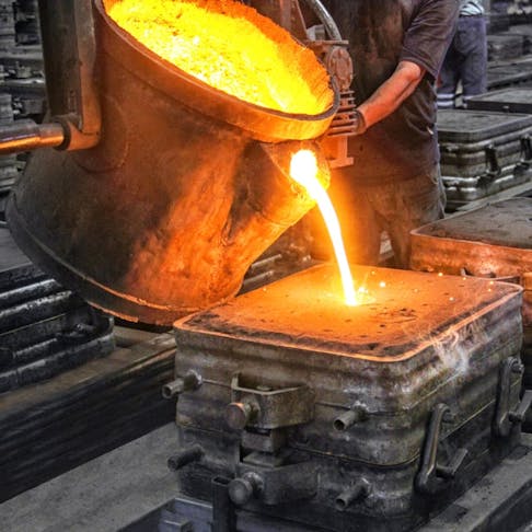

Sand Casting
One of the easiest, oldest, and most common casting methods, sand casting is both reasonable and highly effective. Sand casting uses molds made of (unsurprisingly) sand, where molten metal is then poured into the molds and solidifies into the mold’s shape. Sand is used because it retains heat, reduces cost, and allows for nearly infinite mold shapes if manufactured correctly. Sand is also more forgiving than dies and ceramic molds, meaning it can accommodate thermal shrinkage during cooling with reduced risk of cracking. The above image shows the entire process of sand casting, but notice how there is no theoretical limit to sand mold sizes; one of the most beneficial aspects of sand casting is its use in casting massive, complex parts. Sand casting also allows for nearly any metal or alloy if it melts and can be poured. Though best for short production runs, sand casting is a cheap, versatile, and highly adaptable casting method.
An illustration of the sand casting process.

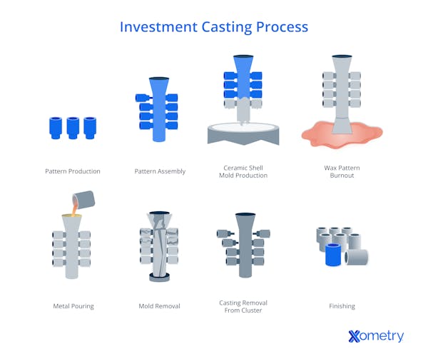

Investment Casting
Investment casting (also known as lost-wax casting) uses disposable wax patterns and ceramic shells to create molds used for casting metal parts. The wax patterns are formed by a lower-temperature casting process, where hot wax is poured into master molds and then removed and cleaned. This wax pattern is dipped in a refractory material (usually fine ceramic silica with binders) multiple times until a hard and thick shell forms. Once hardened, the mold is inverted and heated so that the wax melts out, leaving the hollow ceramic shell. Molten metal is poured into replace the wax, and then the shell is broken off once the metal is solidified. Investment casting leads to highly accurate, thin-walled, and high-surface finish casts that require little cleaning. While generally more expensive than sand and plaster casting, investment casting works best in high-output, small-scale applications where thin sections and low tolerances are specified.
Investment Casting Process Diagram
A diagram of the investment casting process.
