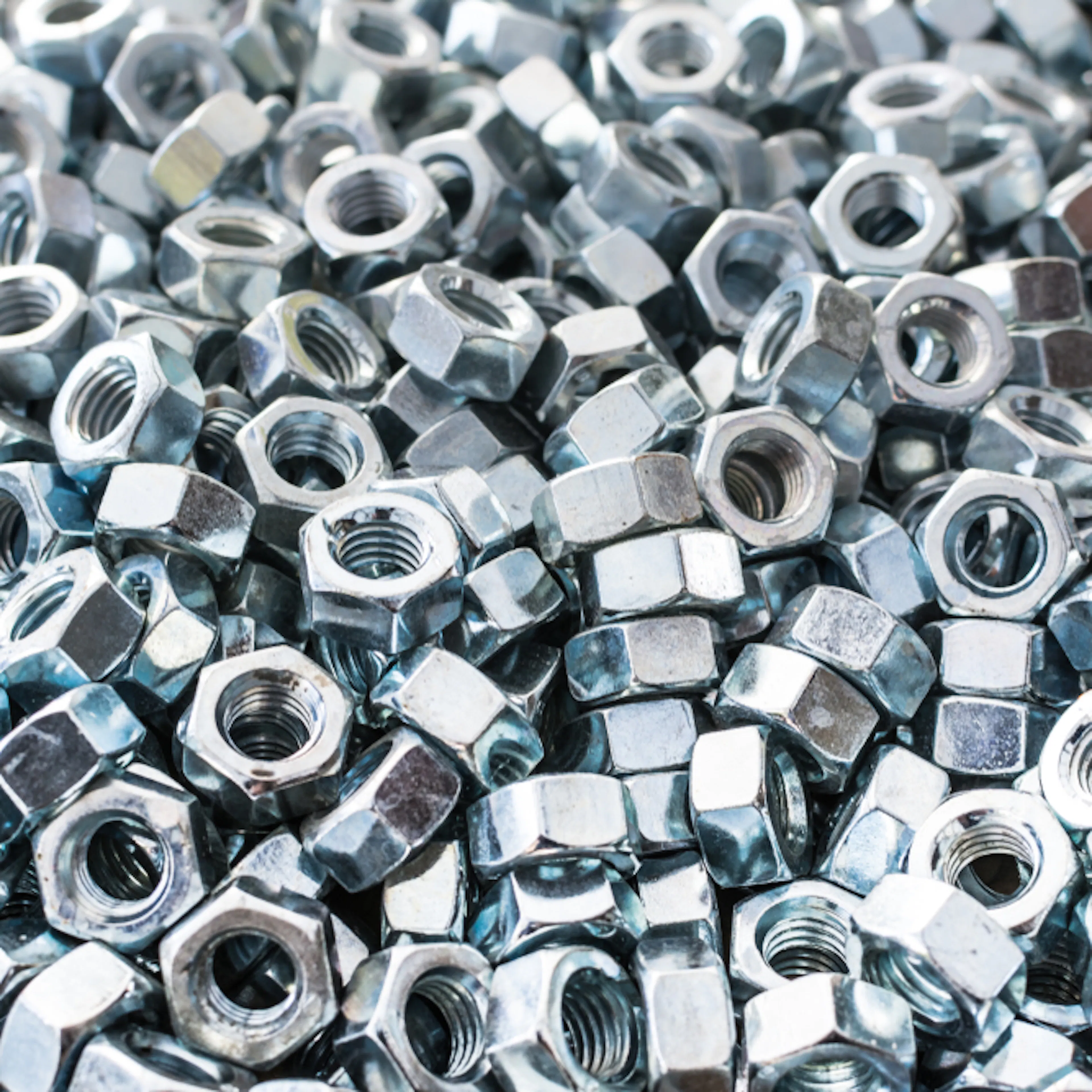

Passivated nuts. Image Credit: Shutterstock.com/Steven Giles
Passivation is a simple, affordable, yet very effective way to ramp up the corrosion resistance of stainless steel… but it has to be done carefully and in controlled conditions. Let’s take a closer look at how this beneficial process is used in industry and how it’s done.
