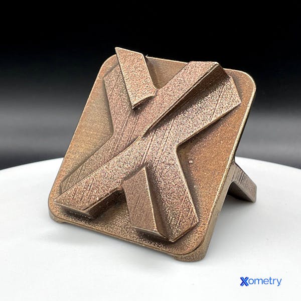

Bronze usually has a metallic finish in a reddish-brown hue, which you can see an example of in the picture below.
SS420 bronze
SS420 bronze
This alloy is no stranger to oxidation, however, and you may find bronze products or structures that are deeper brown and have a greenish-blue patina developing.
